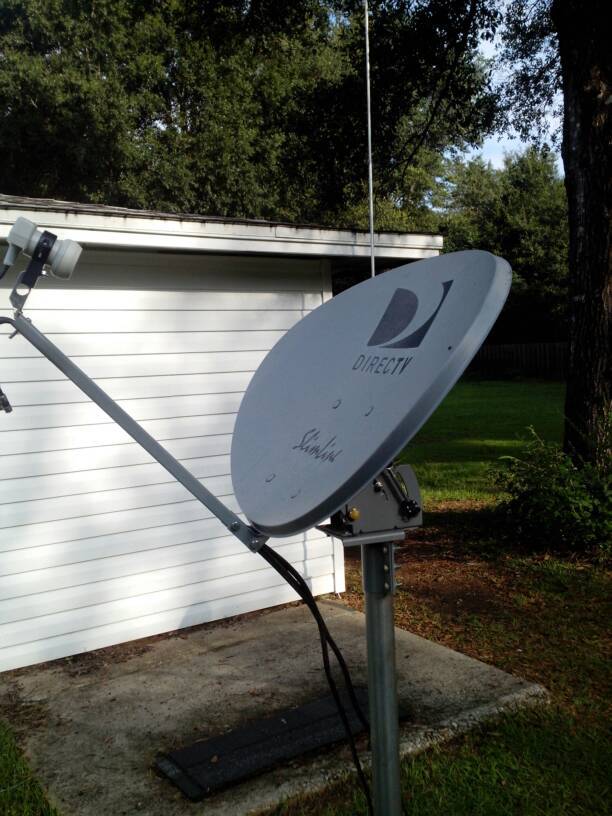

Hello all, I've got a slimdish with an sl1pll pointed at 97w. The problem is I'm only receiving a few channels maybe 4. I've got a superdish with the fss stacked lnb pointed at 97 also and receive much more than 4 channels. My lo is set to 10750 for the sl1pll. I have the micro HD hooked up to the slimdish and cool sat 5000 hooked to the superdish. I've swapped them same results. So my question is this. Is the small difference in size between the slimdish and the super dish making the difference?

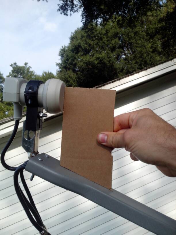

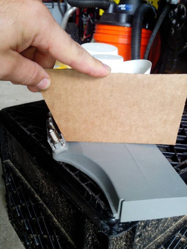

Yes it is a direct TV dish. The feed horn angle and distance was made to match the original feed horn angle. I used a cardboard template cut to match the original lnb. I will post pictures tomorrow when the sun comes up. It did fine on 83w as well. The dish is about an inch shorter and about two inches narrower than the super dish.
Here are the pictures requested.

The new LNBF appears to be sitting too high. Measure on the original from the tube insert to the center of the middle LNBF then duplicate the same height on the replacement.
The dish is small, but you will receive most 97w transponders during clear conditions.
You are right! I don't know how I missed that one. It is exactly 1" higher. I will move it and try again. Thank you for pointing it out. About how many channels should I expect to see?

Edit: the template idea was a good one.
?Wish more people did something like that.

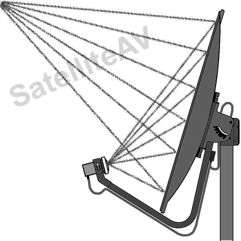

OffsetDish.jpgWith the LNBF mounted too high, the reflector was not correctly focusing all of the reflected signals. Much of the reflected signal was missing the LNBF! :eek:
You are correct! The LNBF will not receive the reflected satellite signals anymore. The LNBF is now in the correct position to collect all of the reflected signals when the dish is correctly aimed.
Moving the LNBF down into the correct position, the signals collected from the reflector will now be focused into the correct "Sweet Spot". If you only move the LNBF down into the "sweet spot" without correcting the dish elevation setting, the reflector is no longer aimed at the satellite.
