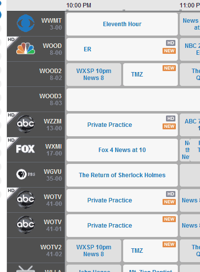

Actually, let me correct that. I'm not seeing the -01 channels for the four locals I get in HD from Dish. I am seeing them for other locals though....
I'm observing the same thing. no -01 channels for ABC/CBS/NBC/Fox but I do have them for some of the smaller stations. Oddly, I do see the subchannels for the majors.
I'm also seeing some channels in the guide that aren't local to DFW. For example, I've got 33-00 (sat) which is the Dallas CW affiliate. But 33-01 in the slingguide grid is UWTV - apparently a Univ. of Washington channel? I've also got 11-00 (sat) which is the Dallas CBS affiliate and 11-01 which is listed as Alaska Information. Looks like they have some work to do.

I just set mine up last night. I can see the OTA channels that correspond to locals provided by Dish (i.e., 003-00, provided by Dish is visible as are 003-01 and 003-02, both OTA).
I cannot see OTA channels that do not have a corresponding channel provided by Dish. (Since there is no 027-00 from Dish, I cannot see 027-01 OTA.)
Do you get HD locals from Dish?? I do and those are the channels my -01's don't show up for.

I do and my -01s show up now on the grid. Didn't the other day though... must have taken my suggestion to heart. :)
