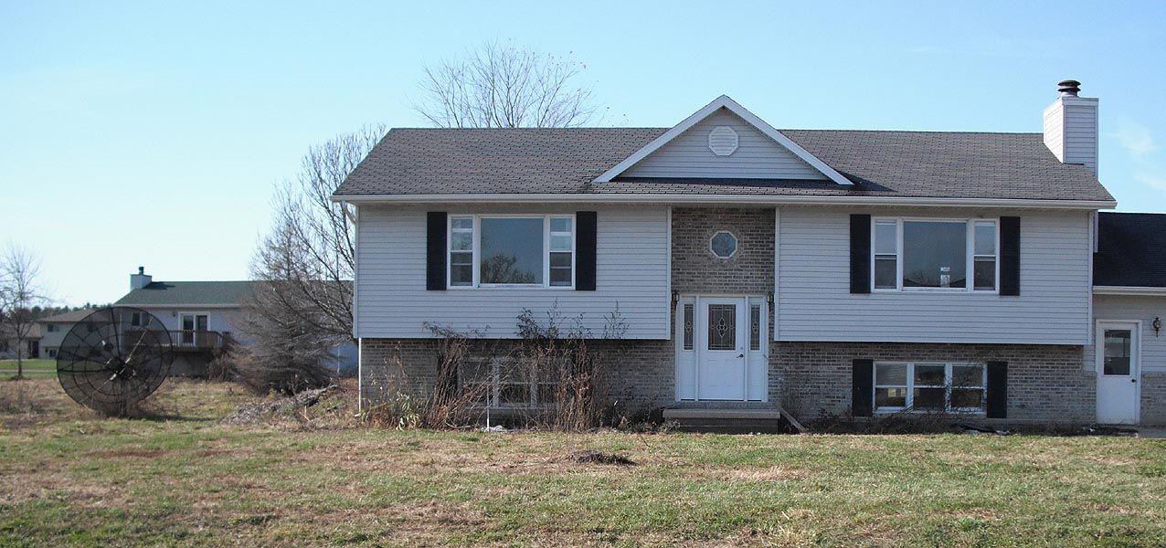

I'm not going to argue against your concerns about the neighbors. But for your reference, here is what a 10' dish looks like when mounted very low to the ground. Possibly with the right location, and some landscaping to obscure it, a bigger dish than you might normally consider would blend in well enough for you. Hate to see you struggle with a dish that you may find is too small.
For what it's worth, that house was in a very nice neighborhood, but it was condemned due to flooding. The owner said nobody ever complained about the dish. The dish is at my place now. The house was bulldozed a month after taking this photo.

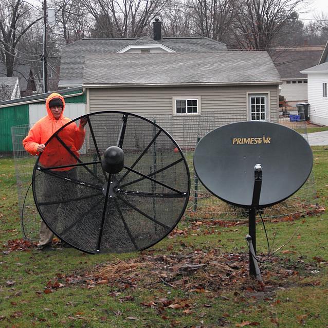

I have a 5' Unimesh. They are little gems. Hope you find one for yourself one day, Bob2011.
Thanks :)
Do you have a picture of it to post here? The OP may change his mind on the 4 footer after seeing one.

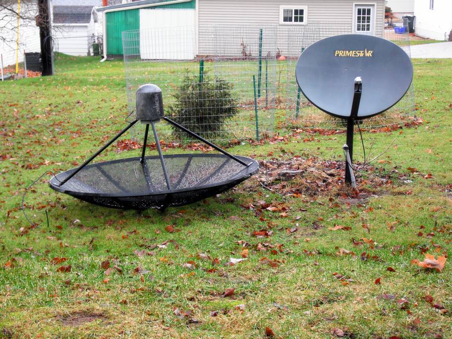

Sure, this dish was in my basement this morning, broken down into quarters. $4.22 worth of shiny hardware later, it's now assembled for the photo op. Please note that I recommend blaze orange when hunting a Unimesh, you can never be too safe with these rare birds, er, mini BUDs. Also, it must have been a good year for dishes grazing out in the field, because this one actually measures 5'9" diameter. Elmer Fudd in the orange hunting jacket is 6 foot tall. The Ku dish is 1 meter wide.
The primestar is an 84e which is 1 m wide and .7 tall.
