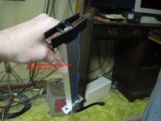

All one needs access to is the ends of the dipole. These are in the lower bottom of the cover so you should only need to cut half way up and about a 1/4" from the edge to be able to solder extensions to the dipole to make it work for the L band. A 50 watt soldering iron worked for me,
don't use a ton of heat as you don't want to melt the coax and the support plastic.
Reweather proofing is up to you just don't use anything metal or that could degrade the reception of the antenna.

Paragraph correction: IMPD grid antenna
I used a stainless bolt to reattach the dipole reflector to the feed cover (after I rewelded it together). The distance is 1 1/2 wavelengths from the dipole, 2 1/2" Interesting huh. From the case it's 1 1/4". Tapped the plastic for the bolt and use a nut against case support to lock and hold in place.
