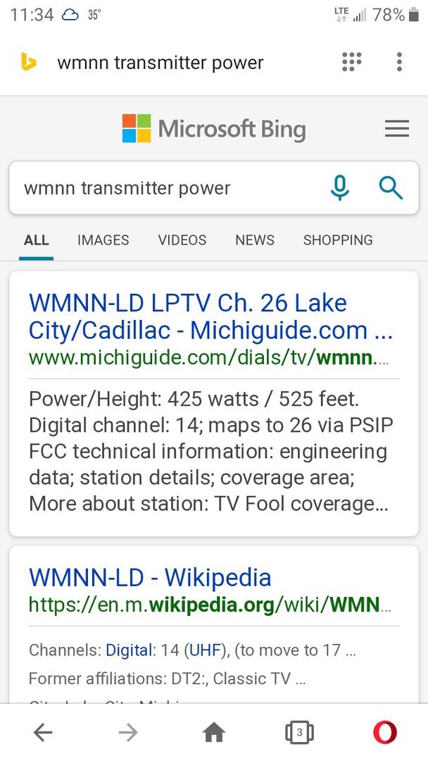

I wish I could do just OTA, but I'm in a strange situation. I live in the boons about 30 miles north of Cadillac, MI and can only get a few OTA stations.
In between Cadillac and Lake City there is a station that has about 12 good subchannels (Grit etc) but the problem is, it is a low power station that barely gets across the road. I could be wrong, but i think they are under 500 watts! Can't get em most of the year from my cabin here in the woods EXCEPT after the leaves are off the trees and have snow on the ground. In addition, when I CAN get em, about a week out of every month, I can't get em, and I don't know why, I suspect some kind of sun activity or something.
I keep hoping someone would buy them and boost em but hasn't happened. If I could get them reliably, I'd never pay another penny for sat or internet TV. Internet TV constantly buffers here and isn't worth having.

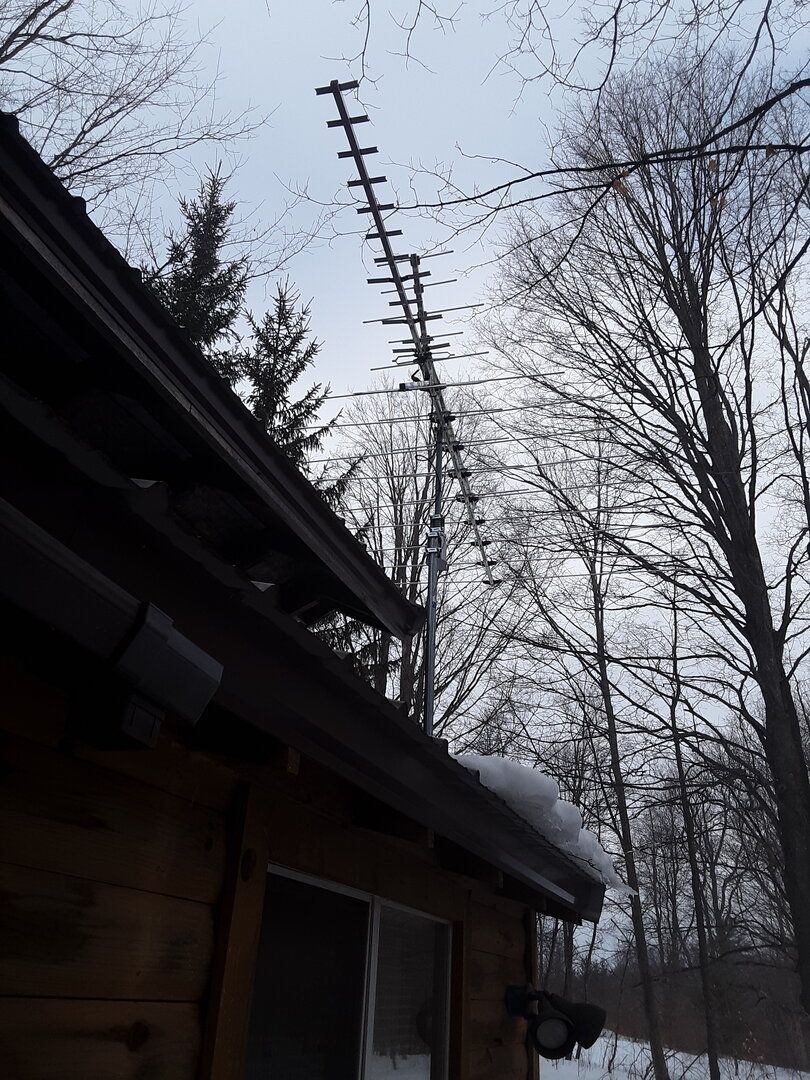

Amped here too but can't get above the trees. 30-35 miles is it, even with this huge thing.

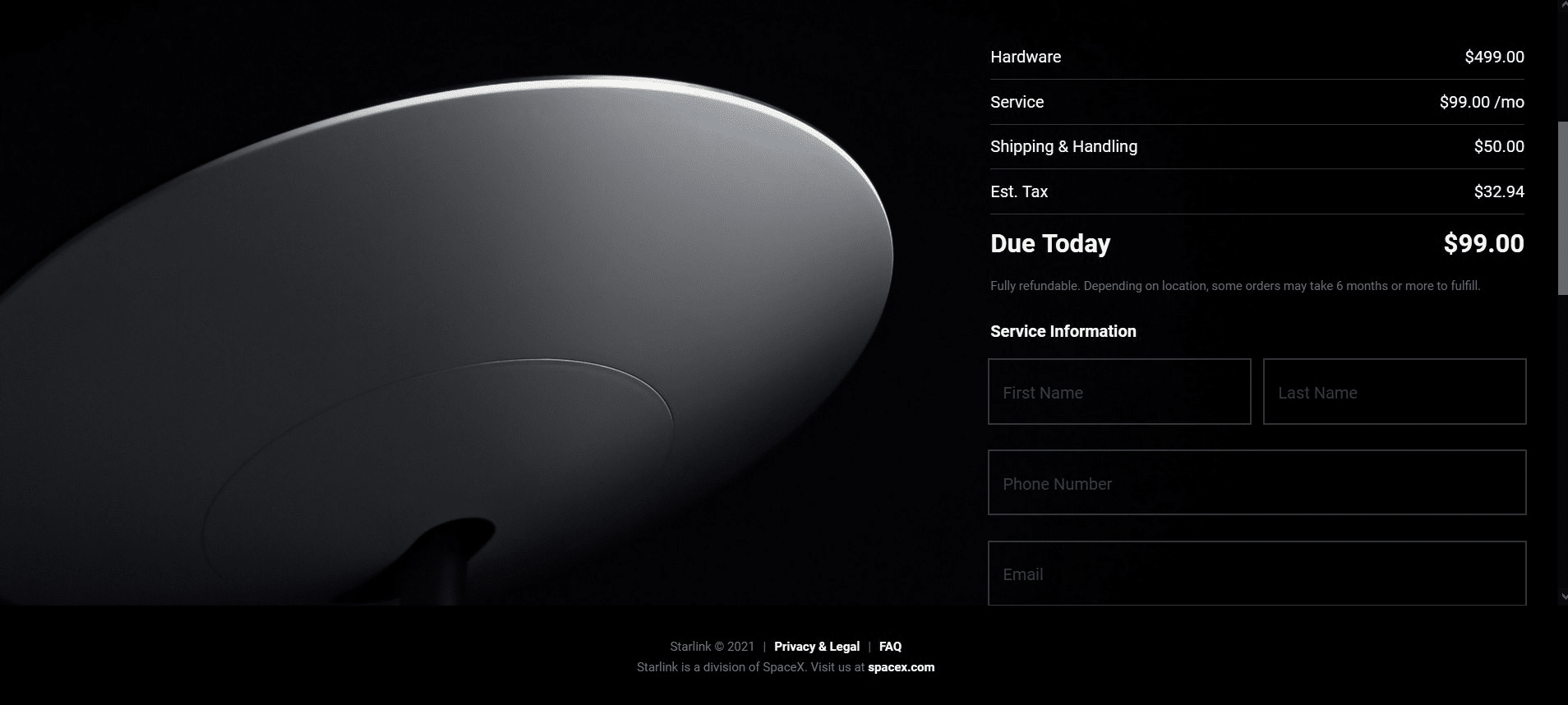

Nah. Starlink is Internet. And from what I've heard from locals with no cable/fiber options out in the sticks, Hughesnet and the other satellite 'net providers are in for a big slap in the face.
Where they cap your data, Starlink won't. And once the beta testing is complete and available to everyone. Starlink will rule. Period. Elon isn't putting all of those sats up to just clutter the sky.
One couple can't steam Netflix on their Hughes sub. Nor Prime. And if they try, the data cap kicks in with 1mbps speed until the next billing cycle. They just told me that they put up a few hunters during deer season and their data was capped in a few hours. I showed them my Starlink invite. They immediately signed up.
$99 per month is steep, yes. But with no data cap and very high speeds. The only stick in the spokes is the initial equipment purchase. $500 plus shipping and tax if you get approved.Self install (which is virtually painless). It still sounds tasty.

Wow, really low power station.
It has a construction permit to go to 15kw. That should allow reception at 35~ miles, IF a person is using and HDB91x antenna, at least 30' up a pole. Likely would need a KT-200-COAX preamp also. How do I know this? I'm doing this exact thing with a 10kw LD station (WFFC-LD) in Saginaw that's 32 miles away from me, as the crow flies. I also have trees, but still can get my station with this setup. KT-200 TV Booster
I've tried other preamps, (including the newest TELEVES one) and the Kitztech preamp readily beats it hands down.

Thanks for the link on the KT200, I see it's 24 db gain, I'll have to see what I'm using is rated for.
The more important part, is that it's only .4db noise. I've tried higher gain pre-amps, BUT, nothing beats that .4db noise level on the Kitztech. You need the lowest noise pre-amp you can find, to get a LD station at 30~ miles away.
Reactions: Skyscanner
I've got 3 or 4 amps laying around here, I'll check their specs, but with so much stuff made by the C. H. Ina company, you don't know if what's listed is actual or not.
I like the televes 560383 it's made in Spain, rated @31dB for uhf and 22 for vhf. Not sure about the noise ratio rating at the moment, so far it's done really well for me.
I tried the newest Televes 560483, and though I can't really find exact specs on it's noise rating, It's got to be OVER 4db, from my tests. That's WAY too high, IMO. The Kitztech KT-200-Coax pre-amp beats it without even breathing hard.
