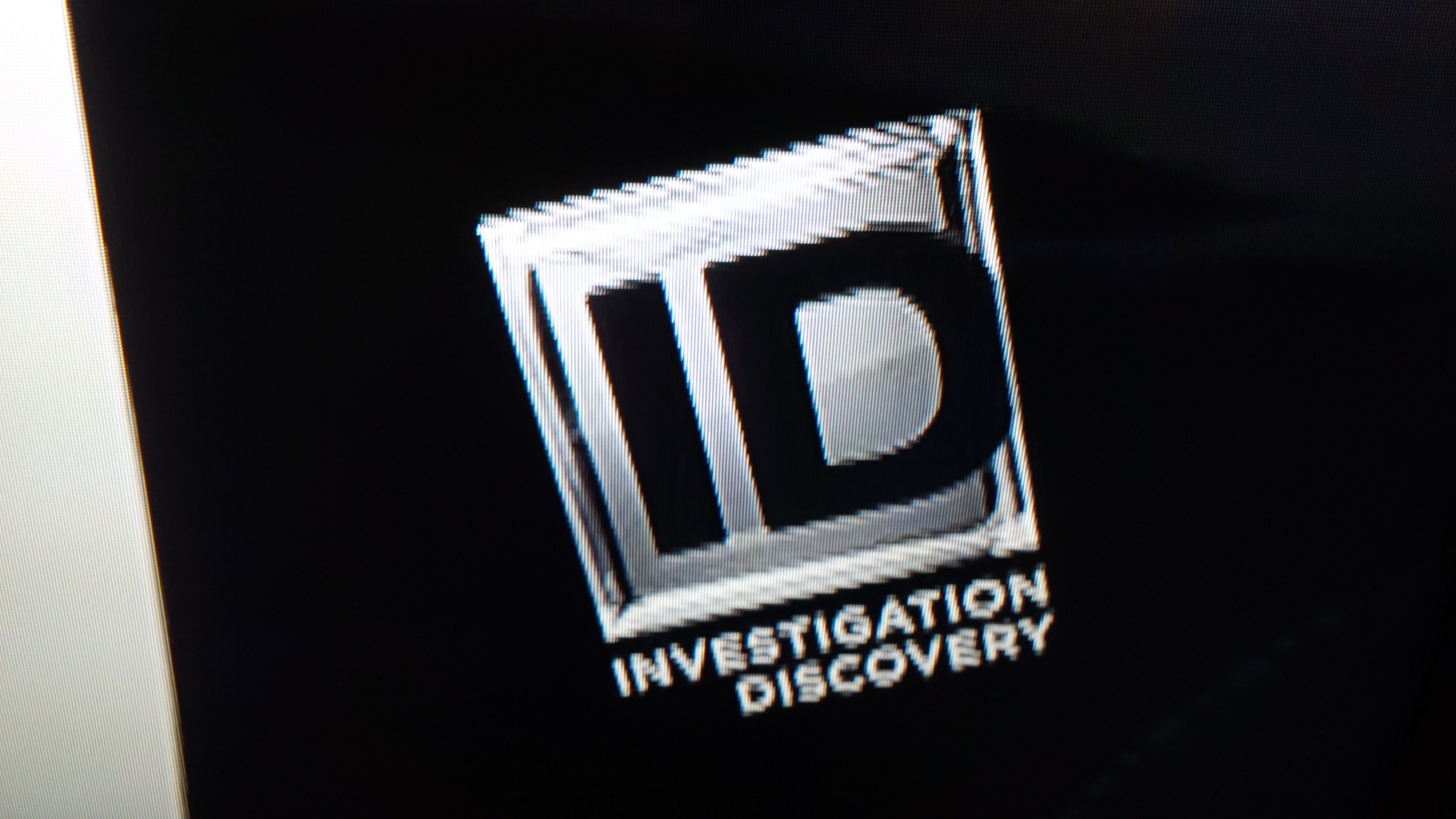

Some Channels Have Bad Quality
This is what it looks like. And any lettering on the screen or other straight lines are just as ragged.

I just turned to 720p and to ID and DISC and it looks just as jagged on the logo and straight lines. All the other channels that are fine seem to be sharper on 1080i vs. 720p. I switched back to 1080i.
It looks like the provider may be using an SD logo on the HD feed. If the rest of the picture is fine, there is nothing that you or Dish can do about it.

OK, so after I got a replacement receiver the channels problem was still there. Then a few days later, the quality of the channels went back to normal without me changing anything. It must have been the feed from Dish.
On ID Channel, Discovery Channel and a few others, the logo on the bottom right is looking all jagged and also if there is letters anywhere else on the screen it also looks jagged. The CC looks normal.
Also the picture itself looks a little blurry as well. Anybody else seeing this?
Hello~ I am sorry to hear you are having an issue with these channels. Do you have another receiver besides the 622? I checked the Hopper here and it seems to be fine. Have you tried unplugging the receiver? Also, is the issue on TV1 and TV2?
