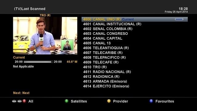

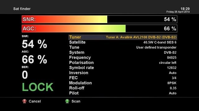

Definitely this TP has switched to DVB-S2.. I did manually scan using the Symbol rate showed in the picture 4025H / 12832
and I got again signal but My Signal drop drastically from 70=to ==>15-30 (bouncing):eek: ,also other channels from others tp's has moved to this Frequency.. So the Symbol rate was changed too..I dont know but I am seeing liitle bit better the picture quality;)..Using Openbox S9
