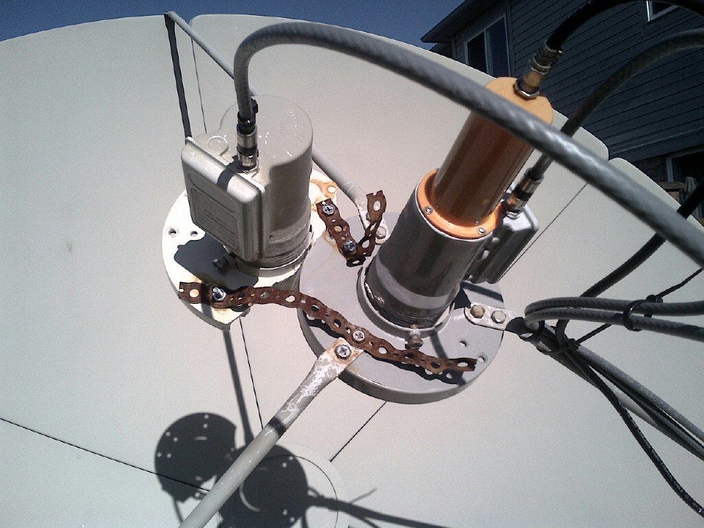

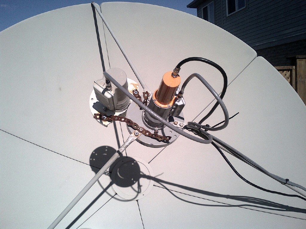

It is actually three-in-one: circular is the secondary and primary focus is a dual-bander c&ku.
The circular is the old reliable BSC-421; the Ku/C LNBF is the excellent new NS-741. If you want to try a Ku&C band LNBF, make sure you buy this model and from a reliable source.
I have an excellent repsonse in Ku Band with this solid dish and the NS-741.
36" actuator and polar mount Fortec 6' dish. Hope it helps.

Thanks for your pictures , Good installation and Idea
and I am "double" surprised that Ses-6 is your "secondary" and even receiving too much channels..wow:eek:..

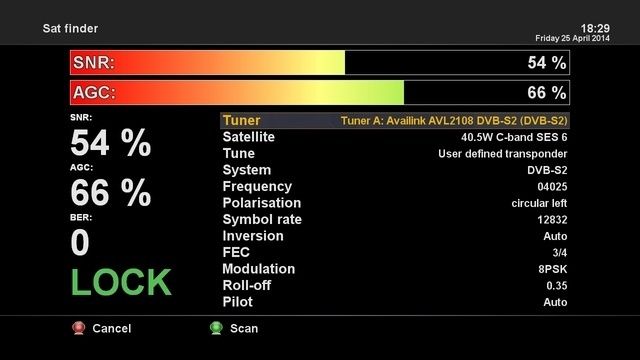

Yesterday I lost some Channels on Ses6 40.5W Mainly from Colombia(Canal1, señal colombia, telecaribe etc etc)..Last weekend those channels worked very well.
I have read on this page
http://www.portaleds.com/espanol/listar.php?sat=3195
and appears that some channels are emigrating to DVB-S2 . Anybody can else reporting changes?. Openbox S9 Can not detect if the channels are DVBS or DVB-S2.. Probably Users with 6 ft (like me) or on the border of footprint could start to miss signals. I hope not:eek:
