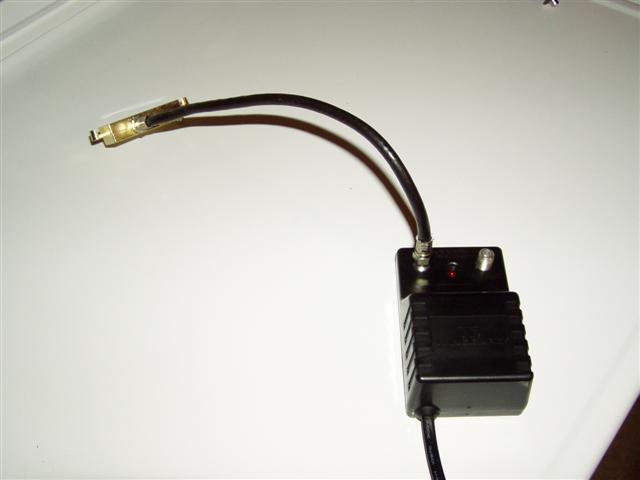

Rick0725
Rick0725
Nov 13, 2005
330
usa
tv out on power supply ...coax ...to splitter
see pic :)
the power passing stuff is too complicated for some of us. ..its like debit n credit.
Towerguy...explain the powerpassing thing to me though in detail...
see pic :)
Splitting between the power supply and TV would require me to run another cable back up two stories, which I'm trying to avoid. The antenna is directly above the bedroom where I want the 2nd feed to go, so I want to split either between the antenna and the pre-amp, or between the pre-amp and the power supply. I figured splitting between the power supply and TV would be the *best*, but since that won't work for me, I guess I'm looking for the 2nd best option.
