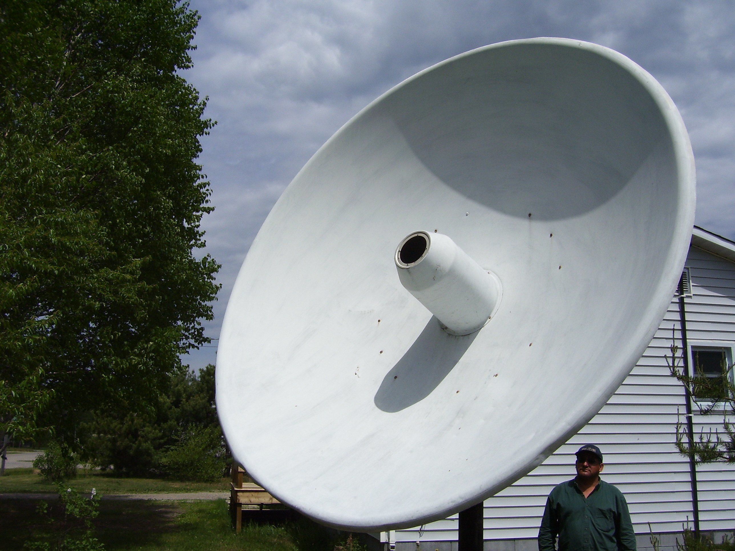

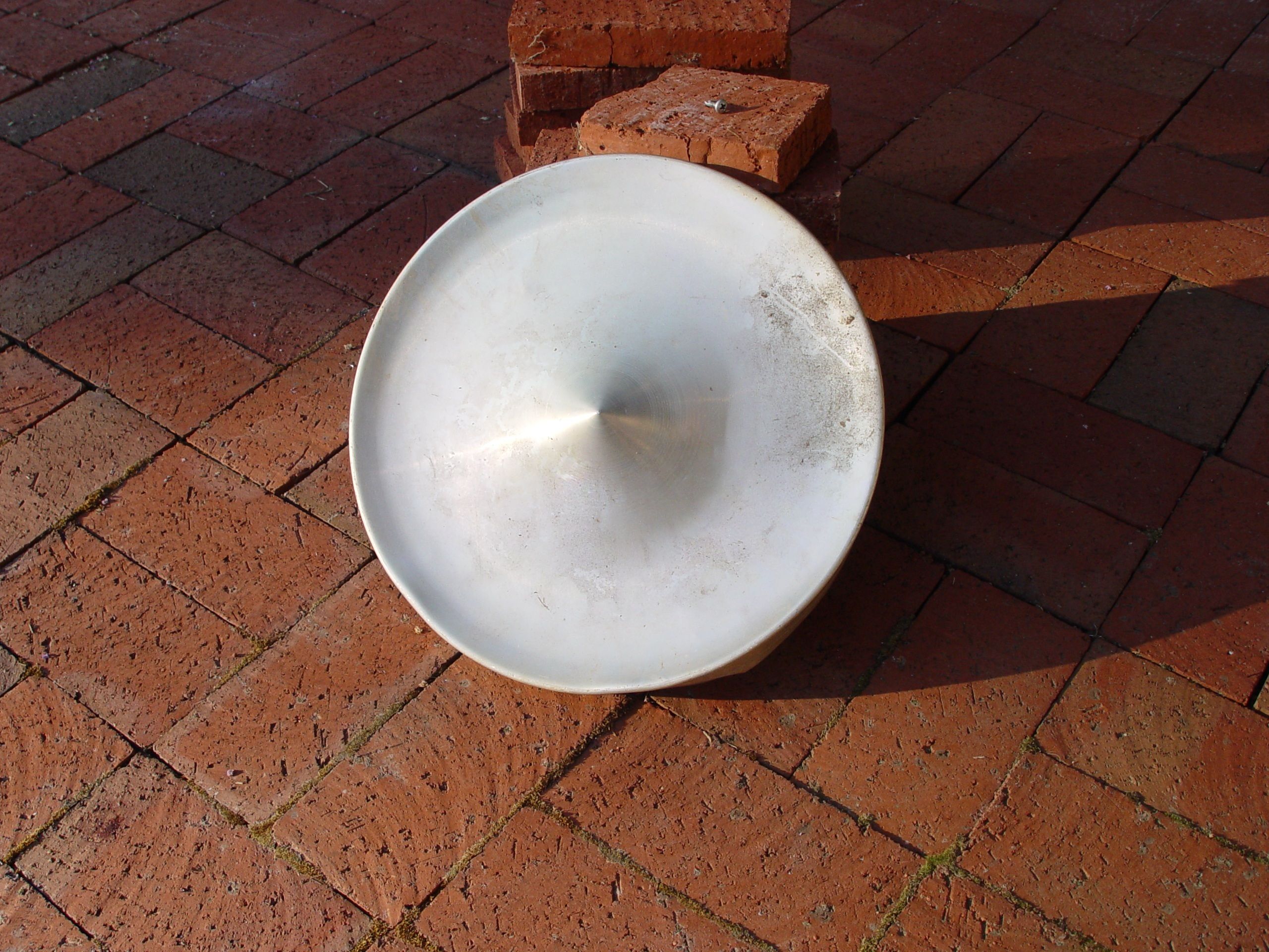

We took this one down today, it's still sitting on the trailer.
It's an 8' spun aluminum, 19" deep and about 3/32" thick.
Only the glue is left, where a name plate once was on the back.
The owners knew nothing about it, other than it was there when they
bought the place 10 yrs. ago, and no spare parts laying around anywhere.
It has a few dings and dents, but none too serious. I'll try to smooth them out.
Would this be a Cassegrain type dish with the secondary reflector missing? The
center looks like the scalar and LNB would have faced the sat.
How much C/Ku fun will I have with this one?
Thanks for looking.

Some noticeable edge and surface dings show in the pictures
Still, I'd think it would do fine on C-band.
Of course, all things are relative... if you've got a good 12'er, this might not do as well! - :D
Unless you want to try to restore the original feed, I'd calculate the focal distance, and outfit it with four legs to hold a scalar.
The legs could be made from conduit, or maybe anodized aluminum tubing, according to your budget.
Changing a button-hook feed (single pole up the middle of the dish) to four legs is a common mod.
Someone did a fine job of it just recently... and if I can recall who it was, I'll post. - :up

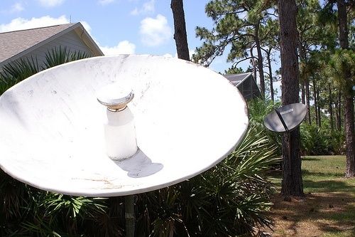

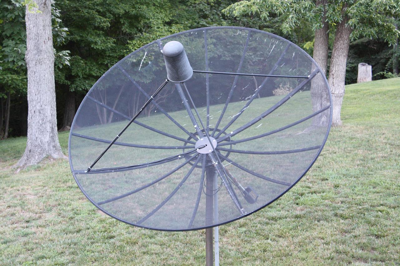

OH,OH, found this: C-band dish sold as "The Eliminator" out of Apopka, FL.
Code:
http://www.flickr.com/photos/ajmexico/3121410158/in/set-72157613646383797/
new info:
Cassegrain-feed 8 foot C-band dish sold as "The Eliminator" out of Apopka, FL. ...
The big dish is a spherical (not parabolic) shape.
Inside the cap is a weird-shaped secondary reflector that sends the signal into the feedhorn which faces the sky, not the dish.
Doesn't look like your dish has the sub-reflector.
Not sure my suggestion about adding quad scalar-support legs is a good idea, if the dish is spherical instead of parabolic.

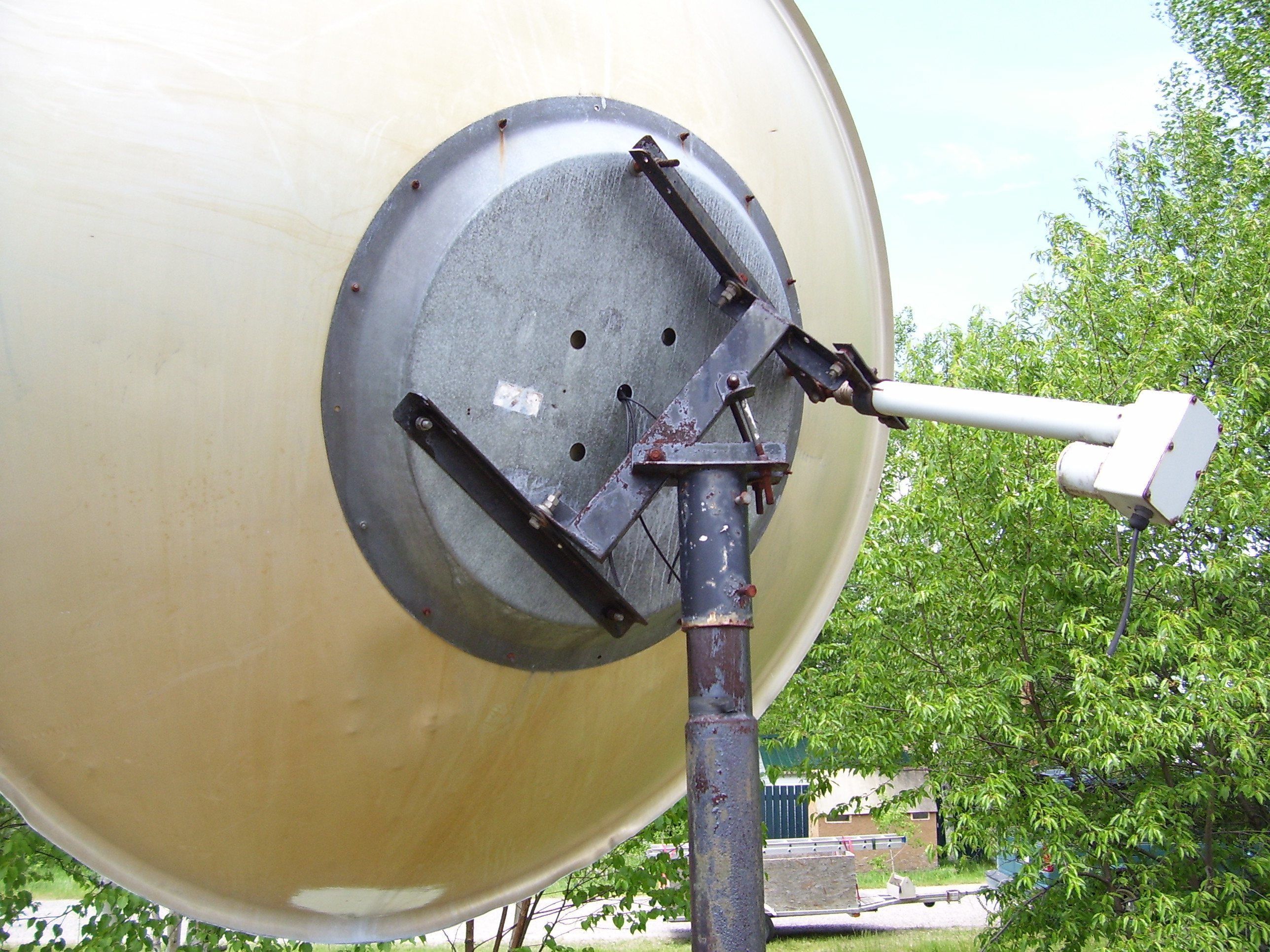

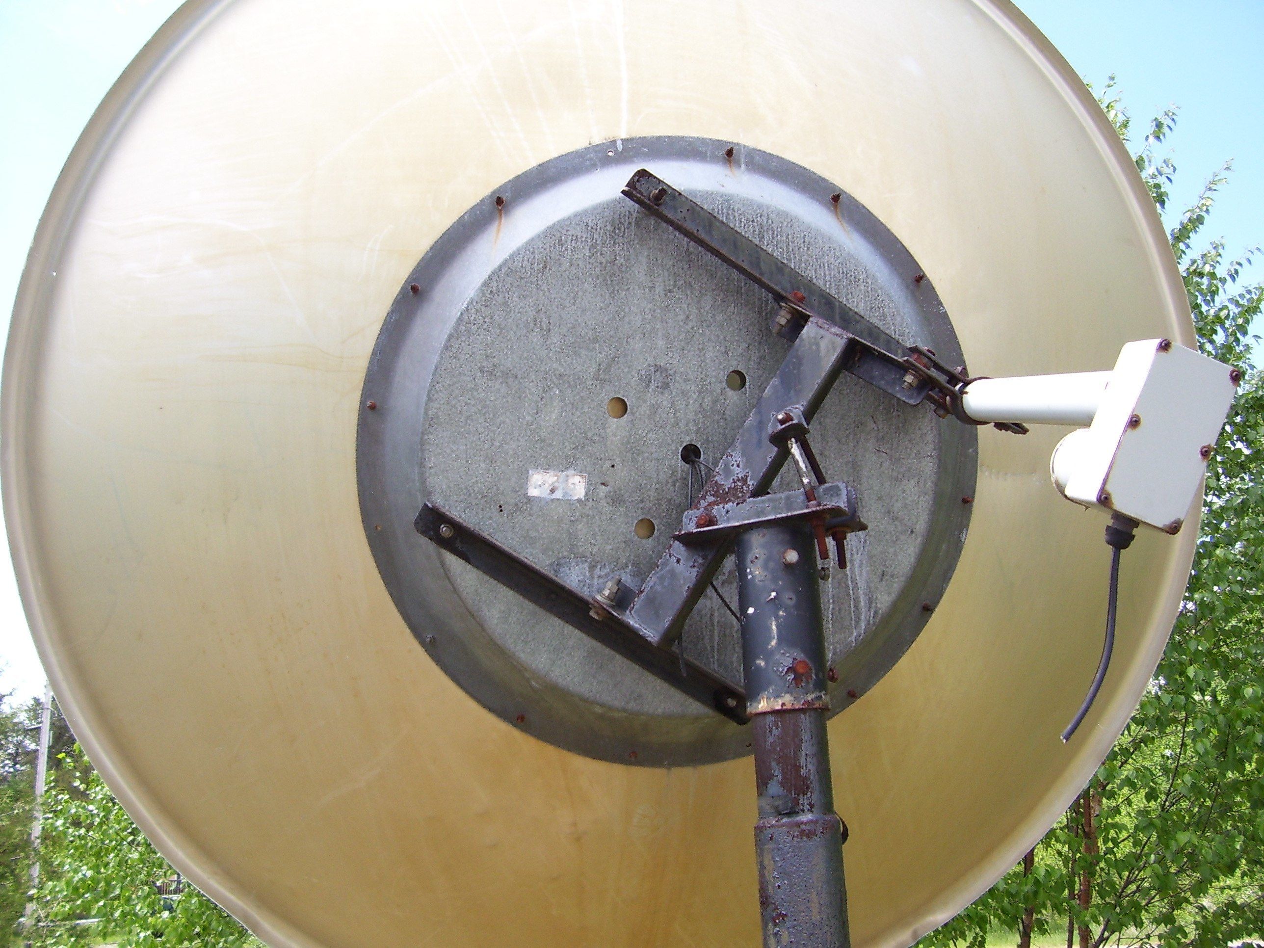

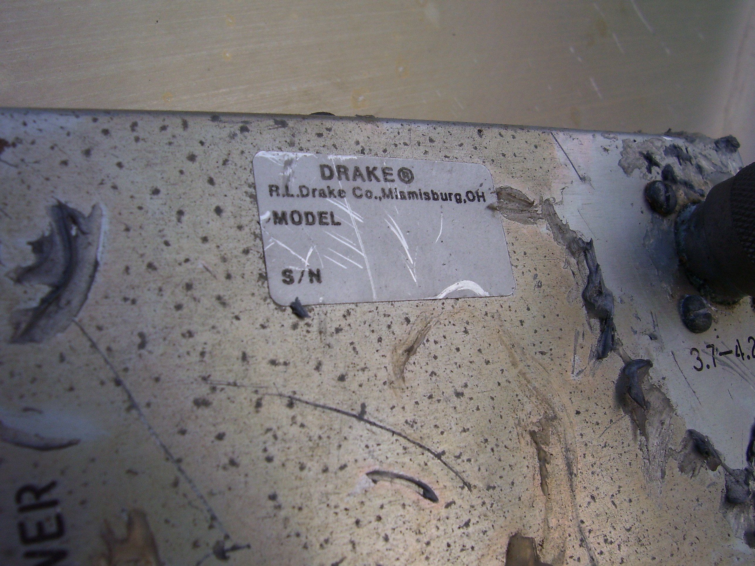

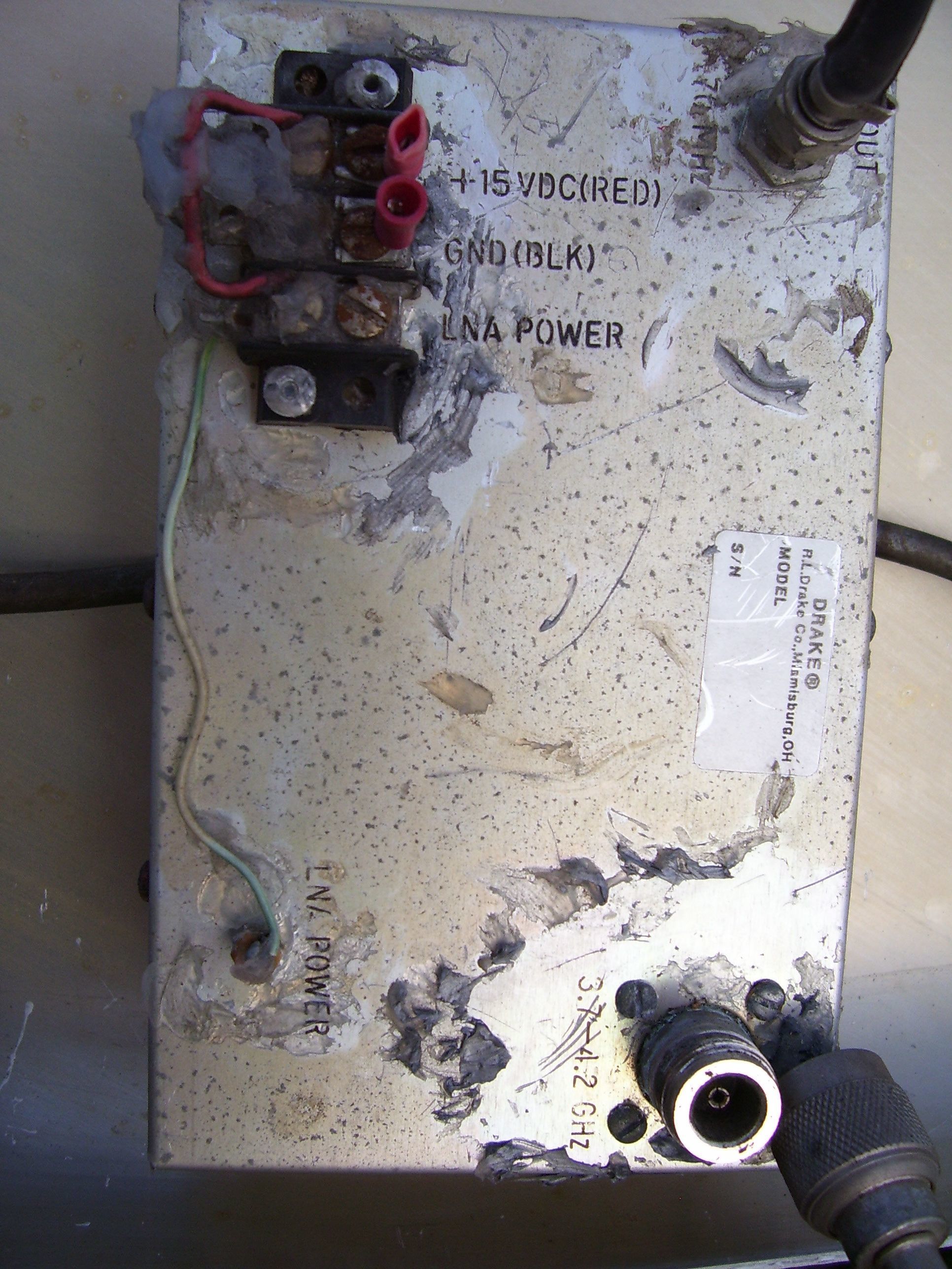

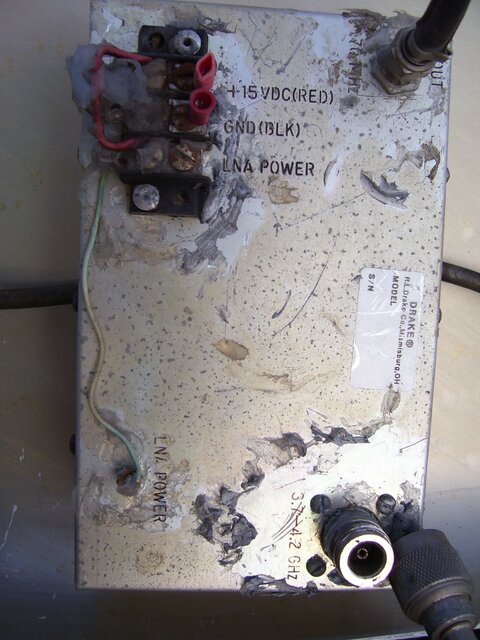

No LNBs, but I did find this box (1st pic) when I lifted the dish off the trailer. it must've been sitting in the feed base
for years before it fell out. No big deal though, modern stuff is far better anyways.
2nd pic shows who made the thing. Google says they make electronics, not dishes.
FaT Air,
Awesome find on the picture! (3rd) It's gotta be the same make and model! Too bad we can't get
more details from it!. Damn!, I wonder who made these things??

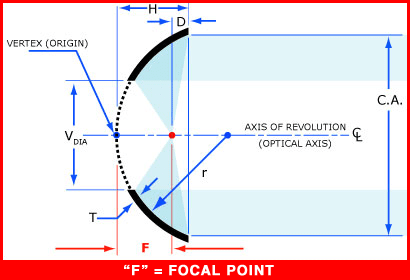

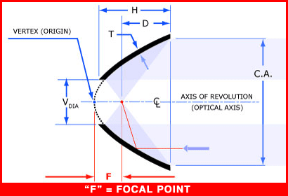

Spherical or Parabolic?
Time to brush up on my maths and physics, and put Google to work.
It seems my first task is to determine the geometry of this dish.
I believe this can be done by establishing the focal point and/or center of curvature, then taking
measurements from that point to various circumferences around the pan.
So, if it is an 8' spherical dish (1st pic), the center of curvature will be 4' from the vertex, along the principal
axis, and at all points along the reflecting surface . A simple enough task, I hope.
A parabolic dish (2nd pic) on the other hand, will have incremental distances to the focal point, along the
curve of the reflecting surface. The distance increasing, the further you get from the vertex.
Telling the two apart, I learned that on Sesame Street!;)
If the pan is parabolic, then I'll remove the old LNB holder (center tube) and rig the thing up with regular support arms for the scalar ring.
But if the pan is in fact spherical, I'll need the secondary reflector! That's where they come into play; correcting
the spherical aberration, and giving a coherent signal to the focal point. Can everybody say "Hubble"?

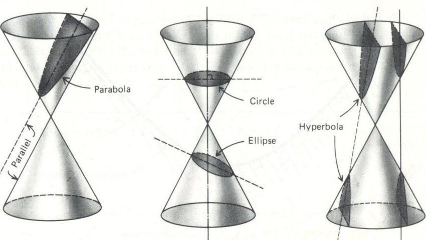

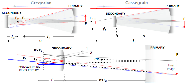

Two types of secondary reflectors can be used. Convex or concave. (3rd pic, top half)
Using a convex secondary, is the "Cassegrain" style, whereas the concave application is the "Gregorian".
"Gregorian" is used mainly for optics, I think it's the interference produced (F2) between the secondary and
the focus, that makes it unsuitable for microwave use. If anything, it'll be Cassegrain.

Spherical!
Well, that didn't take long!
The pan is spherical, but with a 5' center of curvature, not 4' as I was guessing.
It now looks like the focal point is at the hole in the center tube where the scalar
ring fits so nicely. Which is 18" to the back of the scalar, about 19-1/2" after the scalar
thickness and the LNB projection is taken into account.
Now I need to figure out the proper size and shape for the secondary. It's diameter is simple, just match the LNB tube dia.
I'm off to study some more formulas and plot the actual curve onto a cardboard. If have any

Why not contact the owner of the other dish in Florida?
Invite him to join our forum.
Maybe he'd be willing to give you some better pictures of the pieces you need, and the proper measurements and spacing.
Better yet, maybe he'd take an impression (mold) of his sub-reflector for you...! - :eek:

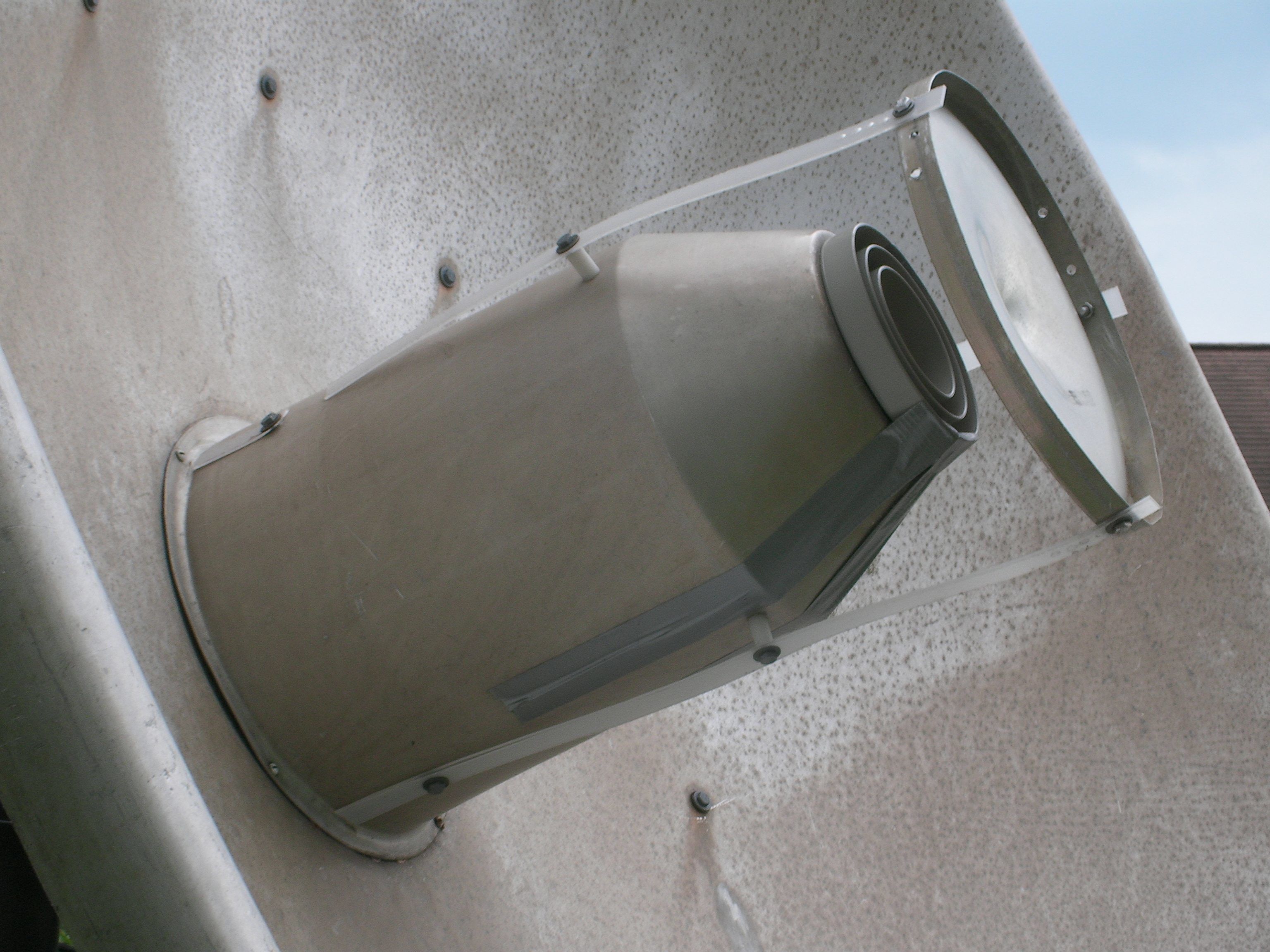

Hey, just found your PM. I just got rid of my old dish, literally in the last week. I picked up a 10' Unimesh a couple years ago, and my Cassy has been laying on the back of my old lot. I just sold the old house and the new owners closed on Monday. I only brought the 10 footer with me when I moved. Wish I'd have seen this thread sooner. I could have sent you my secondary reflector. The secondary reflector is circular with a little raised up place in the middle. Think about a post in the middle of a circular tent. I'll see if I have any pics laying around that may help you out.
I found this pic. It will probably help some. I'll look some more tomorrow to see if I can find a better view of the business side of the reflector.

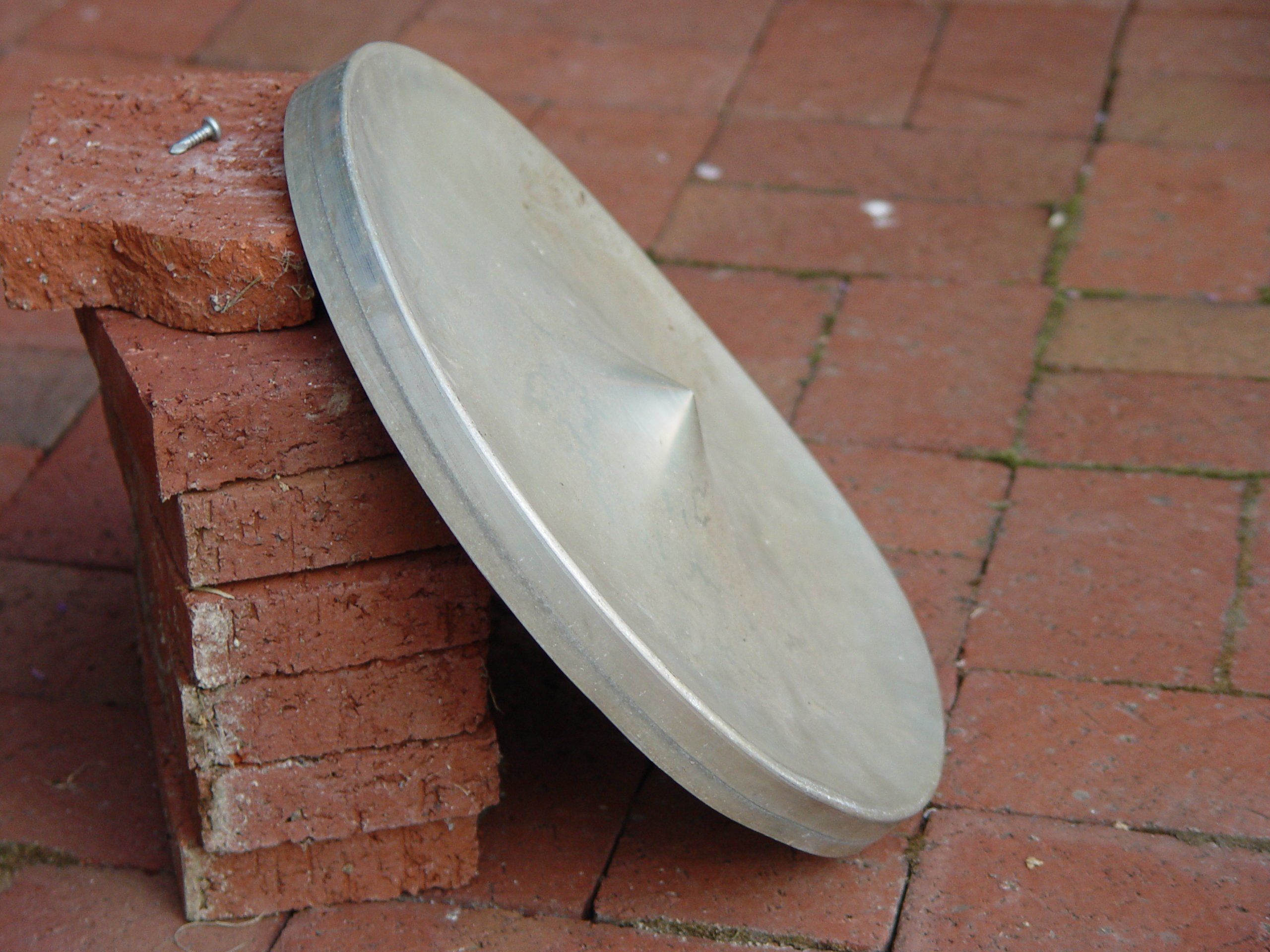

Here's a couple of good ones of the secondary reflector.
So THAT's what it looks like!
Hello Iammike, great to hear from you! The pics say a thousand words!
Now I know what the secondary looks like.
How well did this dish perform for you? Is it really worth my while to continue?
I must say, reproducing a piece like this, will take some doing! I'd pretty much need to have one in my hands, in order to copy the dimensions.
Did you ever locate the manufacturer of the dish?, in order to get replacement parts or specifications?
Is there any chance at all, the new owner might let you retrieve the part?
I never did find any useful formulas on the net. Anything I did find, dealt with the primary reflectors being parabolic, requiring an hyperbolic secondary.
Anole, I followed your suggestion and contacted the fellow in Fla., the best he could offer was some pictures too.
Now I understand his description of "weird-shaped secondary reflector".

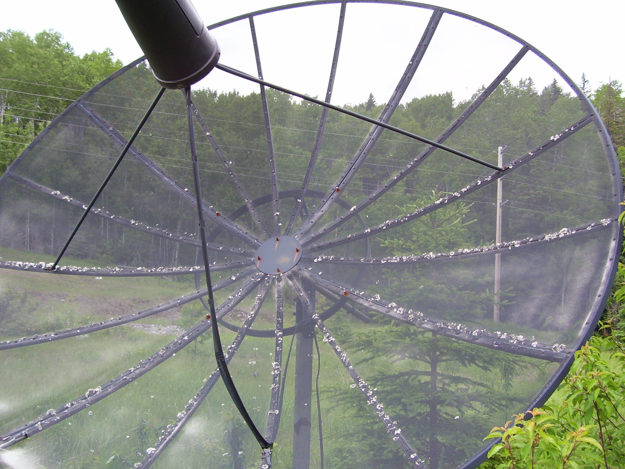

Oh-well, it looks as though this project is going to be on the back burner for a bit, as I was just given permission to pluck a 10' mesh, (pic)
from out near one of the power-dams in the area. A bit if moss and lichens growing on it, but still in very usable condition!
Oh, by the way, the jack that came with the 8' solid dish still works!
