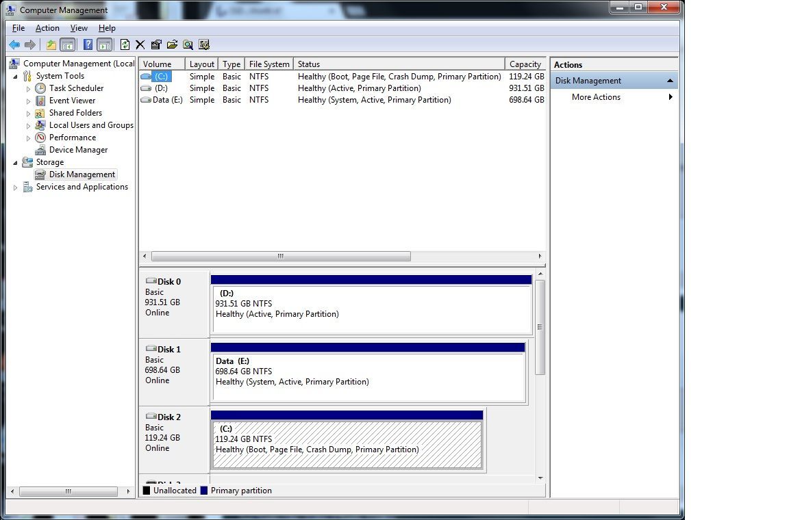

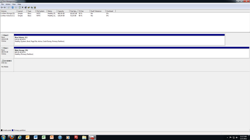

On my newly installed SSD, Windows did not create a system reserved partition. Instead everything is in the same partition. Is this normal for an SSD?
You mean the 100mb partition? Yes it does. It just does not have an actual drive letter. It is only accessible from the emergency startup/F8 menu (Repair your computer). I can't be sure because I'm not near a computer right now but I believe it does show up in the disk management console (run > diskmgmt.msc).
Here you go.. It does show the reserved partition in the disk manager, but it will not show up in Explorer as a lettered/accessible drive.
It is my understanding that the "System Reserved" partition is only needed for BitLocker. If you are installing a version of Windows 7 that does not support BitLocker (Starter, Home, Premium, Professional), then it will not create the partition.
BitLocker is only included in Ultimate and Enterprise.
It is my understanding that the "System Reserved" partition is only needed for BitLocker. If you are installing a version of Windows 7 that does not support BitLocker (Starter, Home, Premium), then it will not create the partition.
I have Windows 7 Professional
Interesting. I was under the impression that it contained the repair tools, regardless of bitlocker. I've done hundreds of installs of all different versions of Windows and I never actually paid attention whether the reserve partition was in all of them..
If you restart your computer and hit F8, do you get an option to "Repair Your Computer"?
I have Enterprise and I don't see the system reserved partition on my SSD drive.
It's not showing up on mine either. Hopefully this won't lead to any issues down the road.
