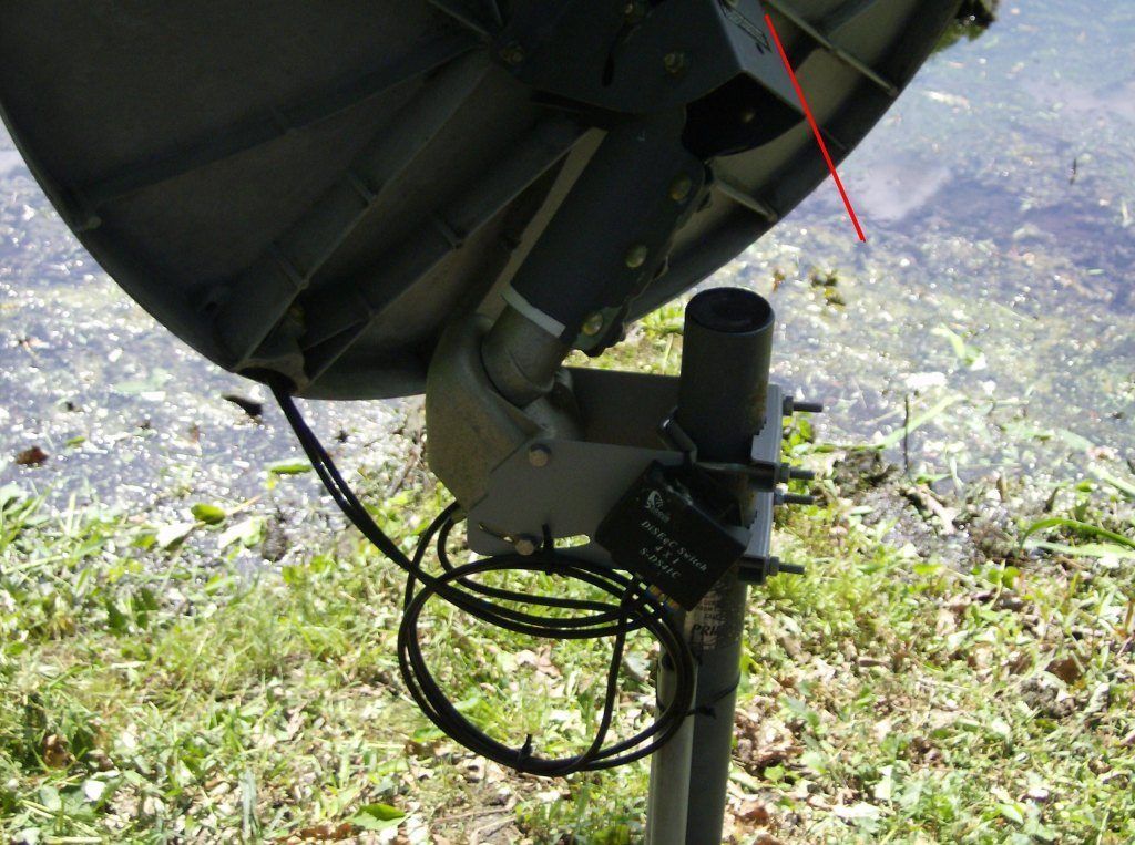

I have come to the conclusion that the top of the bracket on the back side of the primestar dish is perpendicular to the dish. It works out that the elevation for my southern satellite is 45 degrees. Even though that bracket is angled in the opposite direction, If I set the angle of that bracket at 45 it puts me right on my southern sat. If I am correct about this, you should be able to subtract the elevation angle for your southern sat from 90 and the result would be the angle of the bracket. Make sure that you set your motor angle for your latitude before setting the elevation of the dish.
I borrowed chuckboozer's primestar picture and marked the angle that I am talking about.
The primestar dish is the only offset dish I have ever used. Setting it up this way did not require figuring for the offset.
I may be wrong, but you can give it a try.
Thanks! If that's true, it would be incredibly helpful. I've tried putting my angle finder on that spot before, but I never thought to subtract the value given by the finder from 90, which makes sense now that I think about it. I came up with an idea for aligning the dish relative to the motor as well, and if it works out I'll post some pictures here. Thanks again.
