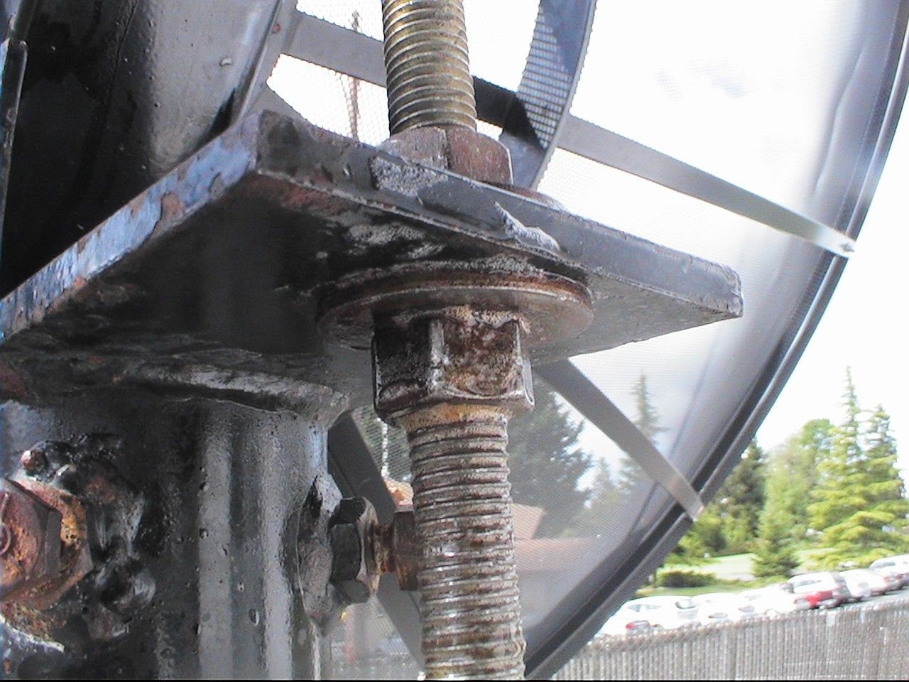

Hi,
On my 10 foot mesh dish antenna, I have a problem...
The lower nut on the elevation bolt is STUCK!!!:mad:
Enclosed photo attachment of the lower nut on the
elevation bolt. It's 12 years old.
It all stared out on Friday May 9th, it was raining that cuased the problem.
I cannot loosen or tighten the lower nut on the elevation bolt. It's STUCK like it won't turn either way. Cused by the rain on last Friday. I shouldn't have make any adjustment IN THE RAIN!!!!
So, have any of you successfully made a suck nut to loosen????
I have NO problem with the upper or top nut on the elevation bolt.
I can loosen it or tighten it.
It's the bottom nut below it, is STUCK.
When I loosen the top nut a little bit, and tried to loosen
the bottom nut, it's stuck. Usually this doesn't happen.
So, I'm using the "PENETRATING Catalyst" spray can.
www.BlasterCorp.com.
The assistant manager at ACE Hardware store gave me this one.
Could "LIQUID WRENCH" work better???:confused:
On Sunday, I used the "Penetrating Catalyst" spray every 2 hourse, and twice, today on the lower nut on the elevation to hopefully loosen it. But as right now, nothing!!! It's still stuck like "LOCK-IN". Maybe that 12 years old nut is ja
So, I am wondering what would you use, or have you use stuff that works to loosen the tighten nut on the elevation bolt????
HELP???

Here ya go Eugene..That PB Blaster that was recommended to you is a good penetrating oil also.
http://www.amazon.com/s/?ie=UTF8&ke...vptwo=&hvqmt=b&hvdev=c&ref=pd_sl_2k4ruwn6ry_b
Once the nut and allthread get rusted up like in ur pic then a combination of remedies is needed....Like I mentioned a torch is a big help..Try to keep the heat on the nut so it will expand and break free..Obviously the heat will spread but you get the idea.
I agree I would put a torch on that.
I prefer larger torches, acetylene. Hotter so the nut gets hotter, quicker, than the all thread. If that's not an option I go with MAPP gas (Dang- can't get it any more - close alternative )
Another solution is a nut splitter.
After you get it working again, coat with a water repellent, of which WD-40 is amongst. I prefer an aerosol automotive grease. Think it lasts longer. I apply it to the adjustment bolts/nuts and the actuator inner tube twice a year. (Spring/Fall)
With stuff like that I usually sandblast what is visible of the threads and then spray PB Blaster onto it and that usually works.
If that's not a viable option for you, I'd clean the threads with a wire brush and then heat it up with a torch.
That threaded rod and the bolts don't look real super bad, I'd think that a torch and heating it up real good would work.
1. wirebrush bottom of the nut, PB blaster and let it soak an hour or two. Or, maybe , #2. Loosen upper nut, pull down on dish and see if you can turn the bottom nut UP instead of down, to break it free. You can paint a dot on one flat surface of the upper nut and count how many times you turn it, if you don't want to get too far off with your original elevation setting. You'd think spraying that upper one with the PB blaster would drip some of it down the bolt, to loosen the bottom one, but who knows?
If none of that works I'd go with the torch, extreme heat method. A welding shop could probably make you another elevation bolt if it ends up breaking in two.
Box wrench and a hammer ;)

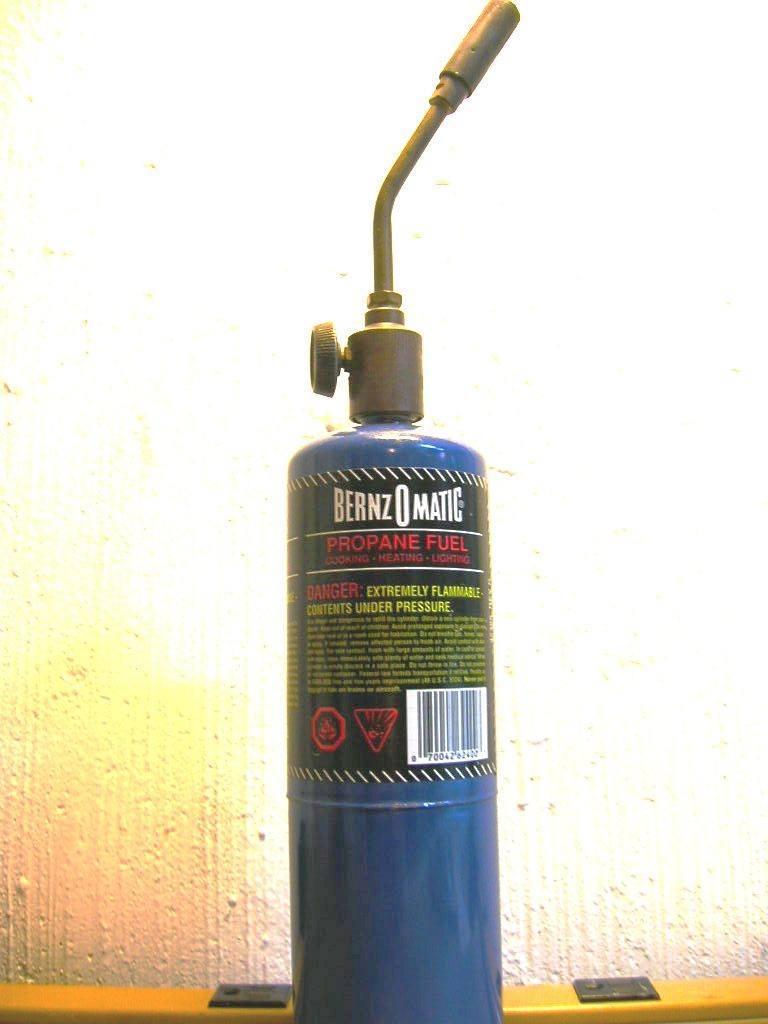

This is what I use. Great to loosen seized and frozen rusted nuts and bolts. Becareful working around gas tanks could be fatal. Also useful in the kitchen to brown crème brule or meringue.

GENTLE tapping with a hammer and punch helps to fracture the rust granules. Use heat and penetrating oil - let soak and allow heating/cooling cycle(s). If using acetylene - heating it RED HOT is not a good idea, as it allows atomic matrix of nut to rearrange and shrink- making it even tighter - also burns galvanized coating causing more lock-up and fumes to poison YOU. Apply alternating tighten and loosen wrench action.
If using acetylene - heating it RED HOT is not a good idea, as it allows atomic matrix of nut to rearrange and shrink- making it even tighter...
I guess I just got lucky when I have used a fire wrench to heat up some stuck fasteners red hot, it seemed to work well.
Got lucky a few hundred times...;) :D
I recommend a metal pipe or something that can give you more leverage on trying to turn the bolt. I've had good success with spraying and waiting with a PB blaster type product (forget what one I used) and then using a wrench with a metal pipe over the end to give me ridiculous leverage to get the bolt loosened.
