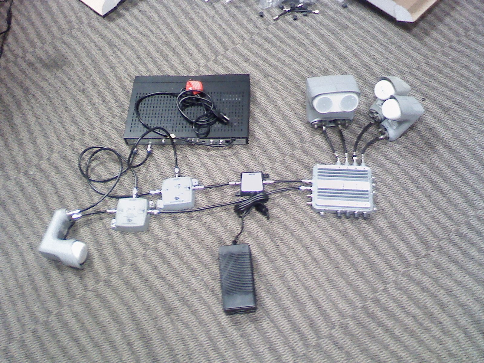

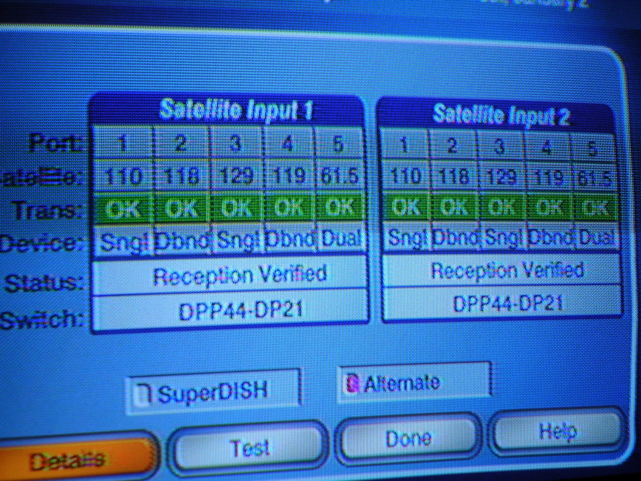

I was able to successfully hookup 5 satellite after surfing this forum getting several ideas.
Here it is:
Dish 1000+ kit (110,118,119,129) to DPP44
Port 1- power inserter to 211k
Port 2- 211k
Port 3- 612-ran to DP21(sat 1 from 61.5 on DP dual/out 1)sat 2 out to tuner 1
Port 4- 612-ran to DP21(sat 1 from 61.5 on DP dual/out 2)sat 2 out to tuner 2
Check switch ran successfully for 5 sat locations on both tuners.
