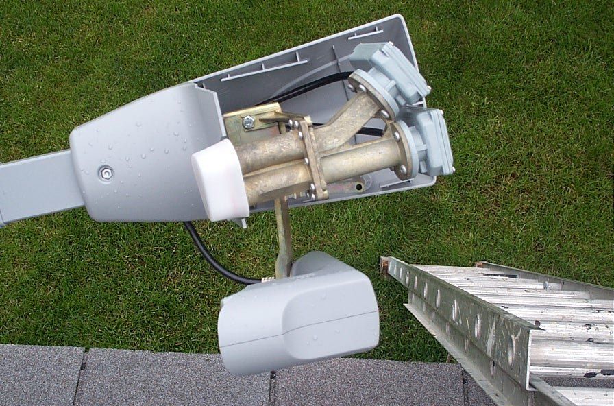

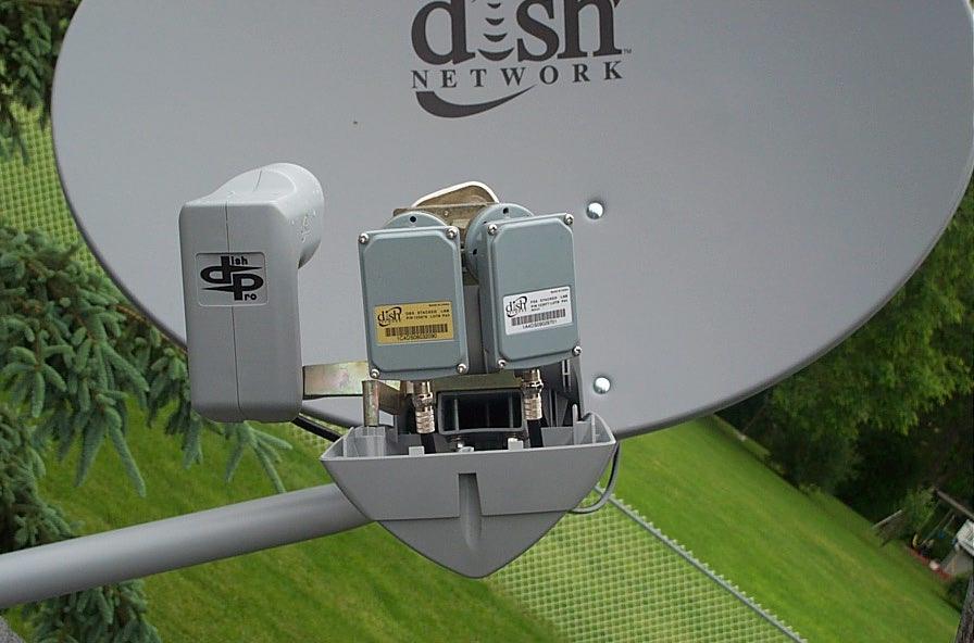

This is a bit strange sounding configuration to me - definitely want to see the pics! Please upload both a view from behind the LNBs and in front (showing the eyes), and any other angle you think might be useful. Definitely looking for clues as to what satellites these things are setup for. :)
A type 1 superdish for the 121 location should have 3 LNBs. The 121 & 119 are in the same molding but have separate "eyes". Then there should be a separate single(I guess in your case a dual) LNB for the 110. Dish advises folks to peak the dish on the 110 first(outermost LNB).Then go back & fine tune the 121 signal,since it is FSS & has a lesser strength.
Type 2 superdish for 121 will have an oval type LNB in the center for the 121,with the 119 next to it & the 110 LNB off seperate.
For the 105 location the 119 & 110 are reversed.119 is the seperate LNB & the 110 is next to the 105.
There really is no use for the other port on on your dual LNB. One line from each LNB go to the 34 switch,making all three signals available for alll receivers hooked up to the switch.

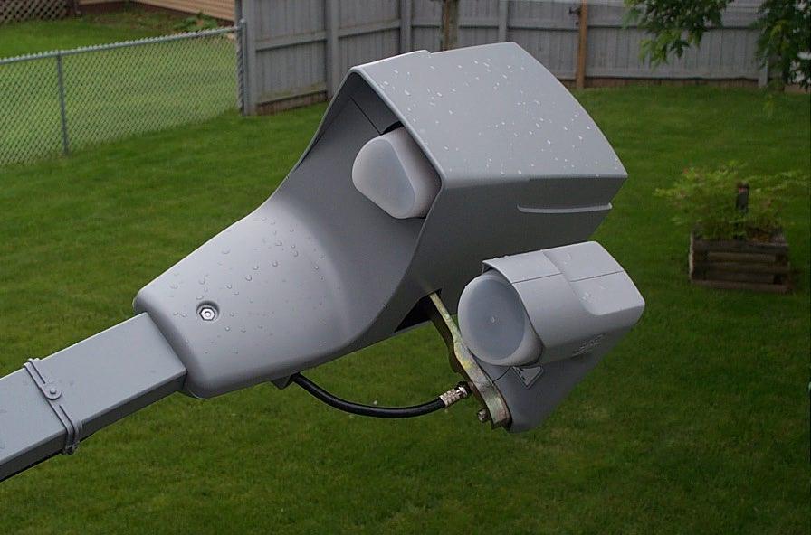

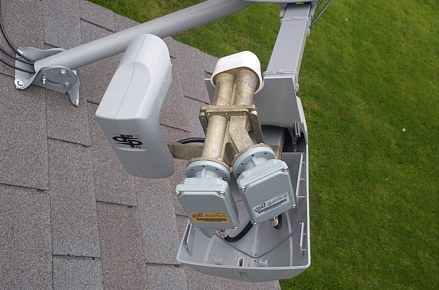

Ok heres some pic's of my superdish 121 LNB assembly:
121 LNB
FSS Stacked LNB
P/N 122677 Lot# P41
1A4DS09029701
119 LNB
DBS Stacked LNB
P/N 122676 Lot# P43
1C4DS08032090
110 LNB
DishPro
Digital LNBF
P/N 151019 Lot# 0401
mski
