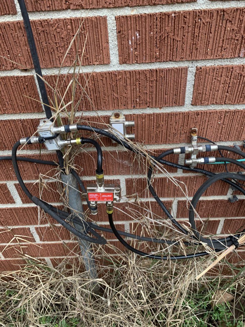

Currently my receiver is downstairs connected to tv1. My new tv is upstairs but looks awful because it's just coax. How can I switch them around? Is it an easy fix?

It depends on how it's cabled, but VIP's are a dying breed. I'd definitely look into a Hopper 3. and a Joey
It is Vip722. We have had it forever.

On the silver "Splitter - which is a diplexer, not a splitter, the cable out on the single post, labelled In/Out goes to the Receiver. The one coming from the UHF/VHF that feeds an actual Splitter, one of those goes to your TV2 and the other goes to a Mirrored TV that you have or had at one time. Disconnect, one at a time, the 2 cables coming off the red Splitter to see which one kills the feed to your TV2. When you find it, swap that one with the cable coming off the In/Out port on the Diplexer, the move your Receiver to the new TV and connect the cable to the back of the former TV1, put it on Ch 670 or 73 or whatever TV2 is set for and you 're good, other than programming the remotes to work the TV's and I can give you the codes, if you need them
