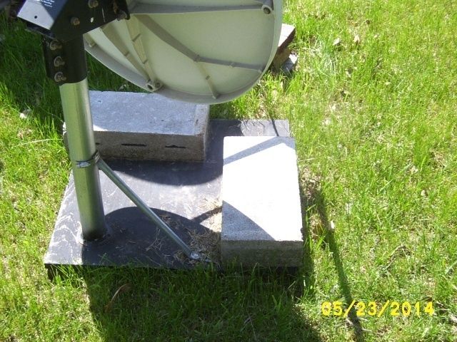

Home built NPRM
I built NPRM for a 30 inch 'in a hurry' last fall. 5/8 ply base, some conduit, a hose clamp and a few deck screws. Hose clamp allows 'limited' plumb fine tuning. Flange welded to bottom of the pole. (Bearing cap from the local hardware for $1.29)

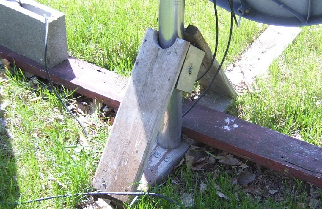

Also have a 1.2meter still on it's temporary 'stand'. (Too Long I've put off building a more permanent stand) Recycled decking and a pile of deck screws. Bolt goes thru the pole to stop 'spinning' while the bottom rests on the bottom plank passing thru another piece with appropriate sized hole.
attachment.php
Pole the 1.2's are on is truck exhaust pipe. Way cheaper than tubing . (Here anyway)
Both survived 50 mph winds :eek: last winter without requiring a 'tuneup'.

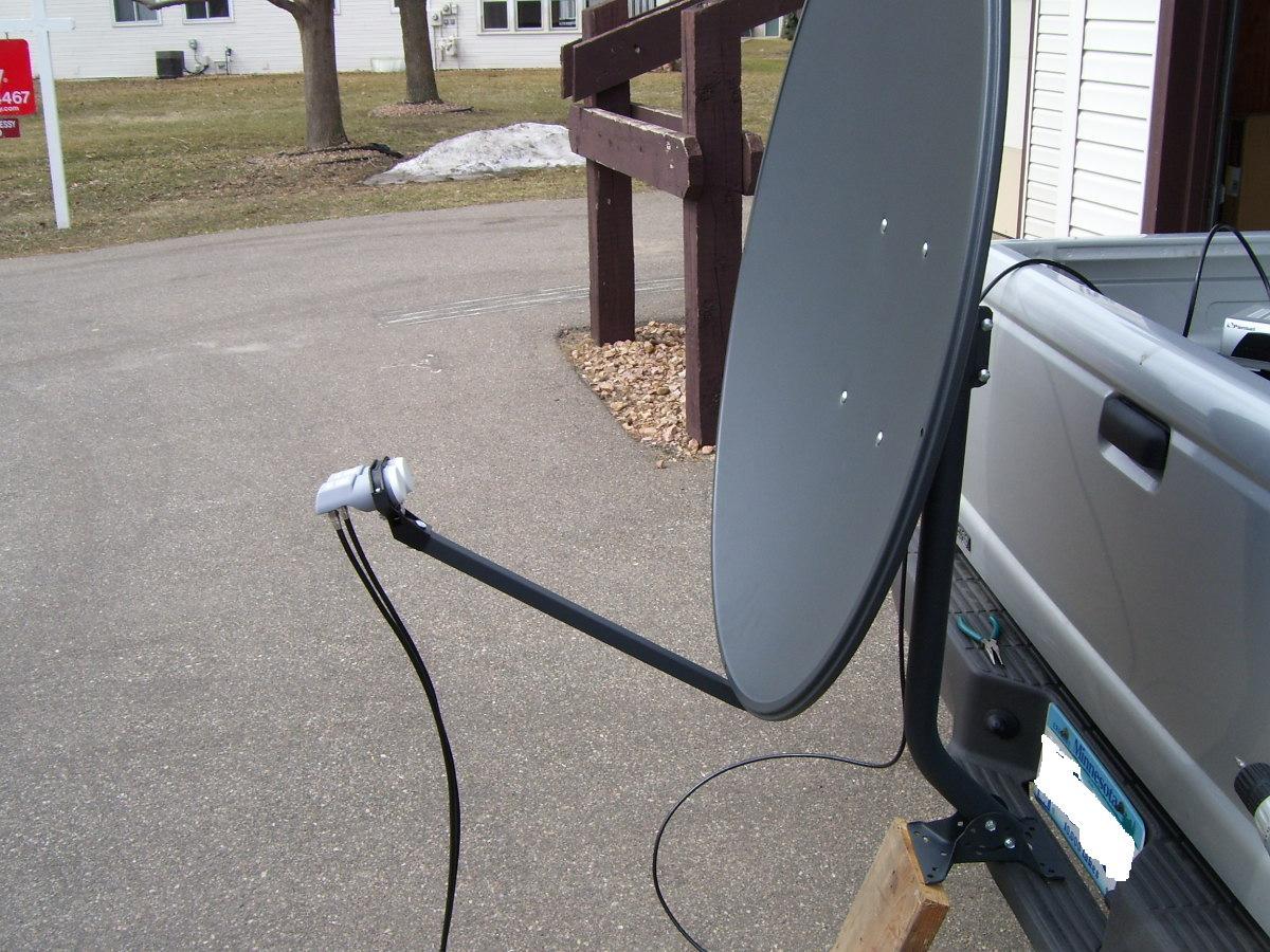

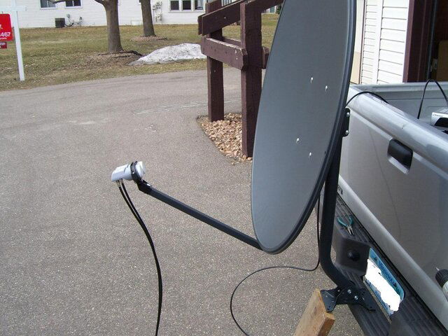

I use to have a setup that was in the bed of the pickup so I could get G10 at the lake on the Primestar dish...sadly the mount got destroyed :(
I did bolt a mast to the trailer hitch on the truck when I did a review one time

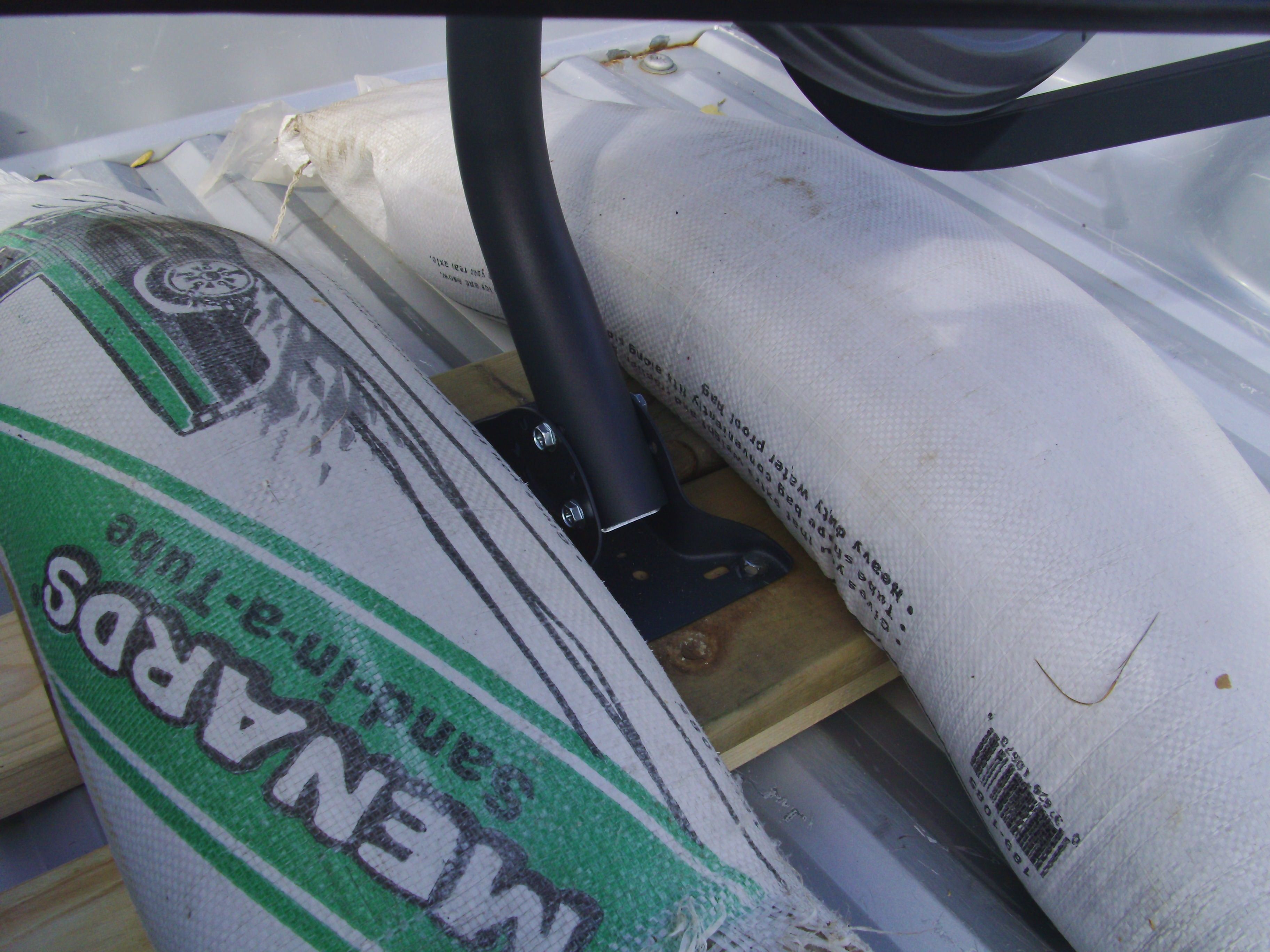

Interesting Ice, I have wanted to try building a temp mount/pole that would fit in the bed of my pickup, something that would lean over flat while travelling. I'm sure it could be done without a lot of welding. But I have no welding equipment nor the skills!

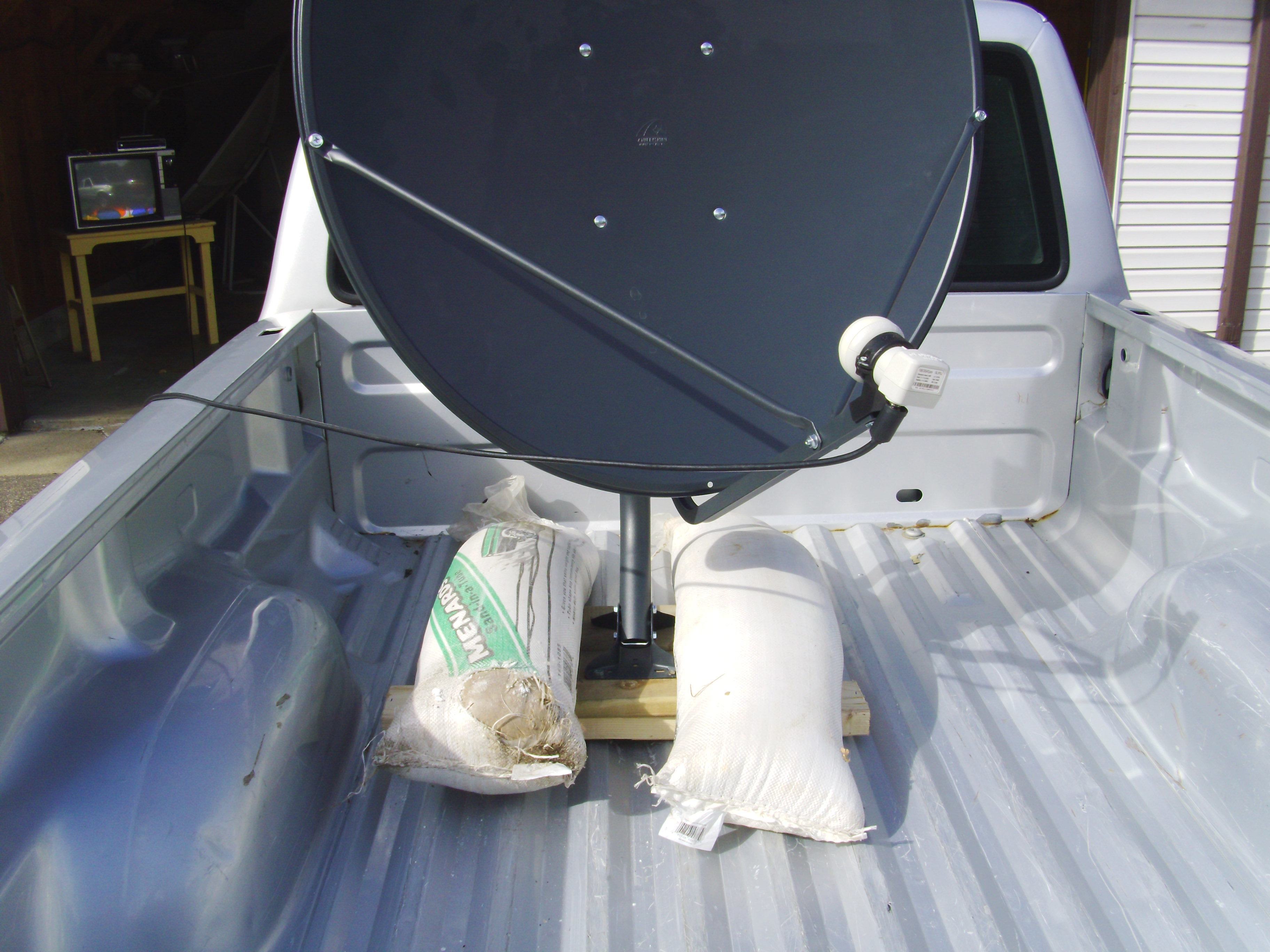

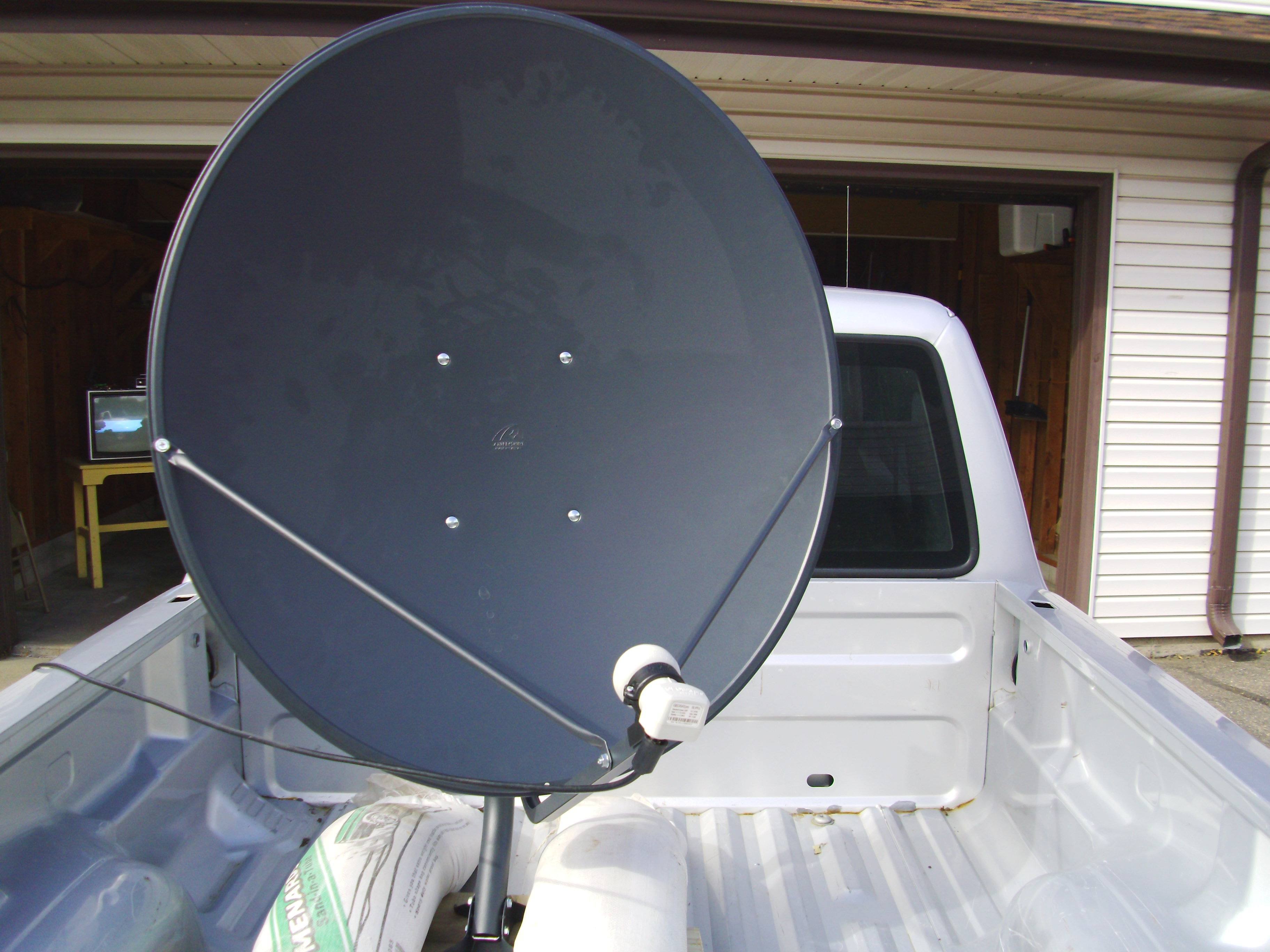

mine was just scrap 2x4's and plywood
the 2x4's looked like an "I" in the bed of the truck. The plywood laid on top and was on top of the wheel well. I could put blocks (or in my case sandbags) to keep it from moving but the plywood had maybe an inch on each side clearance so I could just slide it in and out
I mite have a picture of it (or one like it)
Here was one that I had near the end of when I lived in the house (wasnt the one described above)
Having that SatAv adjustable pole helped :)

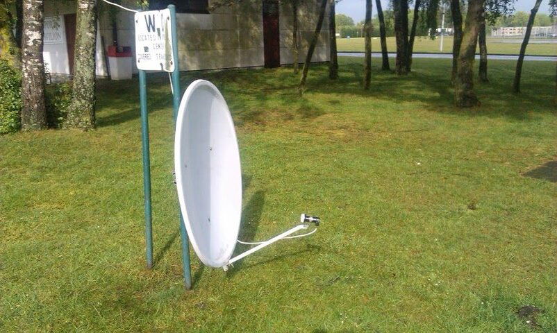

We had a party couple of weeks ago, and, of course, we watched some TV, hockey game. Temporary pole was already installed, I just attached 1,2m antenna.IMAG0241.jpg
