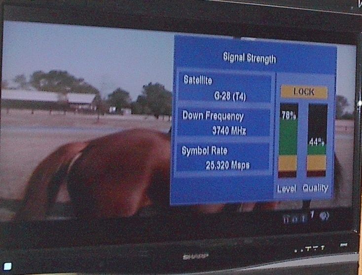

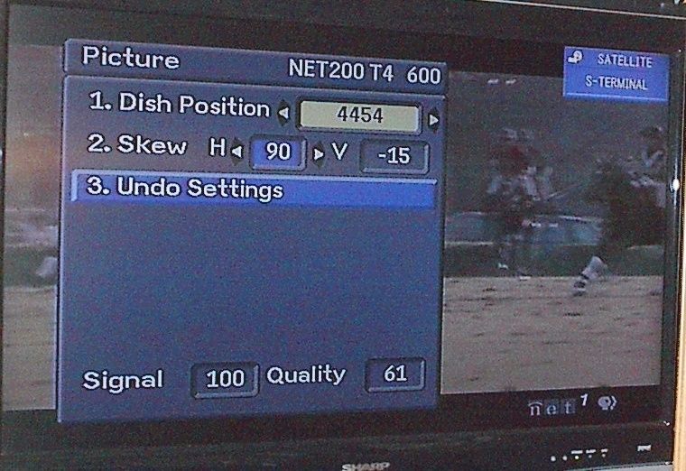

I did some tweaking of my settings and did a DVB rescan with scrambled channels included and ended up with these numbers (see pictures) both solid.
