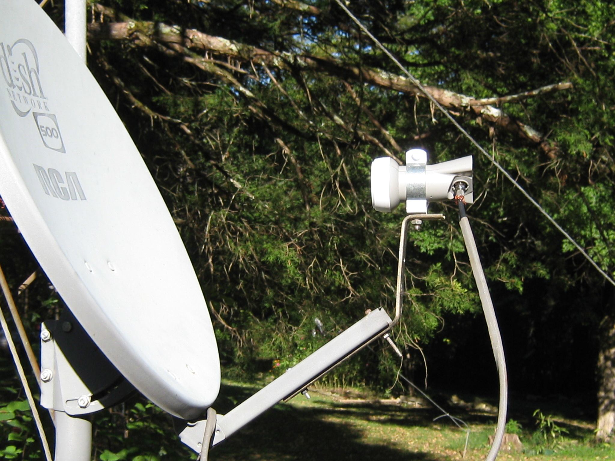

BTW, while visiting home I picked up a 30x24 Dish Plus with no LNBs attached on the side of the road... figured it might be a decent start. Anything I should know about using this dish? What type of adapter or LNB should I use?
Here's a stock photo of the Dish with stock LNB: http://www.dishuser.org/pictures/ts2009/dpp500plus-1.jpg
If it has the lnb-support arm still attached, sure you can use it for some fta. A little undersized but should get most of the stronger feeds once you attach a linear lnbf to it. I think SatelliteAV, one of our sponsors sells a linear lnbf that attaches to the stock lnb support. If not, you can fashion one , Ill try to attach a picture of one I cobbled together on a dish500 dish. And yes, even that small dish gets a lot of signals. And please ignore my crappy test cable-connection, I had run out of connectors !
