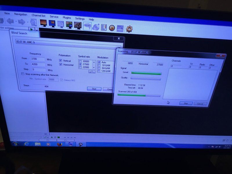

I got my TBS 6920 in and got one of my computers with a fresh windows 7 install and updated. I downloaded the driver and ran setup and it started to install but then it hung so I closed out and ran the installer inside of the 64 bit folder and it installed successfully.
I downloaded ProgDVB and ran a scan and nothing. The weird thing is, every time ProdgDVB changes TPs the program hangs for almost exactly 30 seconds and then repeat. Is that normal behavior for a PCI tuner card? If not how long do they usually take to search a TP?
Im hoping the card isn't bad. Thanks.

Yeah so I tried SmartDVB basically the same result. Every time it goes to tune something the application goes not responding for exactly 30 seconds and then comes back no signal found. Under device settings I tried the automatically found TBS 6920 option and the TBS new interfaces as I saw suggested on another forum. One thing I found strange the LO default for c band was 5150000 but I tried it both ways, at that default value and 5150. It tried the blindscan device and it said that the device doesnt have blindscan capabilities but Im pretty sure it does. Doesnt matter because it wouldn't bring in the Pennsylvania network when I manually entered the info. I know that channel is strong and it should have have no problem and signal wise it showed 98 Q L 0. I think the card is bad, it came from a guy selling tons of electronics on eBay. I guess I better contact him, unless anyone can think of anything I may be missing. Some weird trick that is important when setting up a TBS card and SmartDVB?

It does show up and it does say its working fine. It shows Q98% L0% on the meter in smartdvb too, all the time. Just no signal. The card gets pretty warm when trying to tune a channel. Card is not on the list for supported cards by EBSpro. Does not have external power input.
