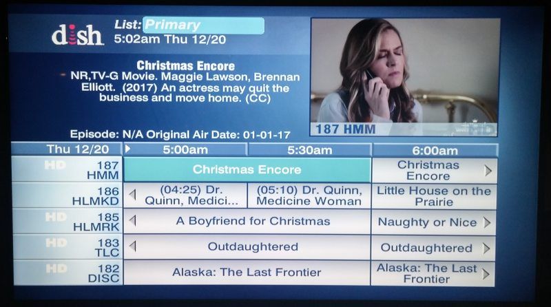

And again this morning. A 2 hour movie on Hallmark Movies & Mysteries blocked in 1 hour segments in the guide. It would be a full time job trying to keep up with all the screwups.

For 3 straight days the listing for Hallmark III is nothing more than "To Be Announced". :rolleyes:
I see what you're saying. For channel 186 (Hallmark Drama) I have the current program and the next program, but everything after that is "To Be Announced."
