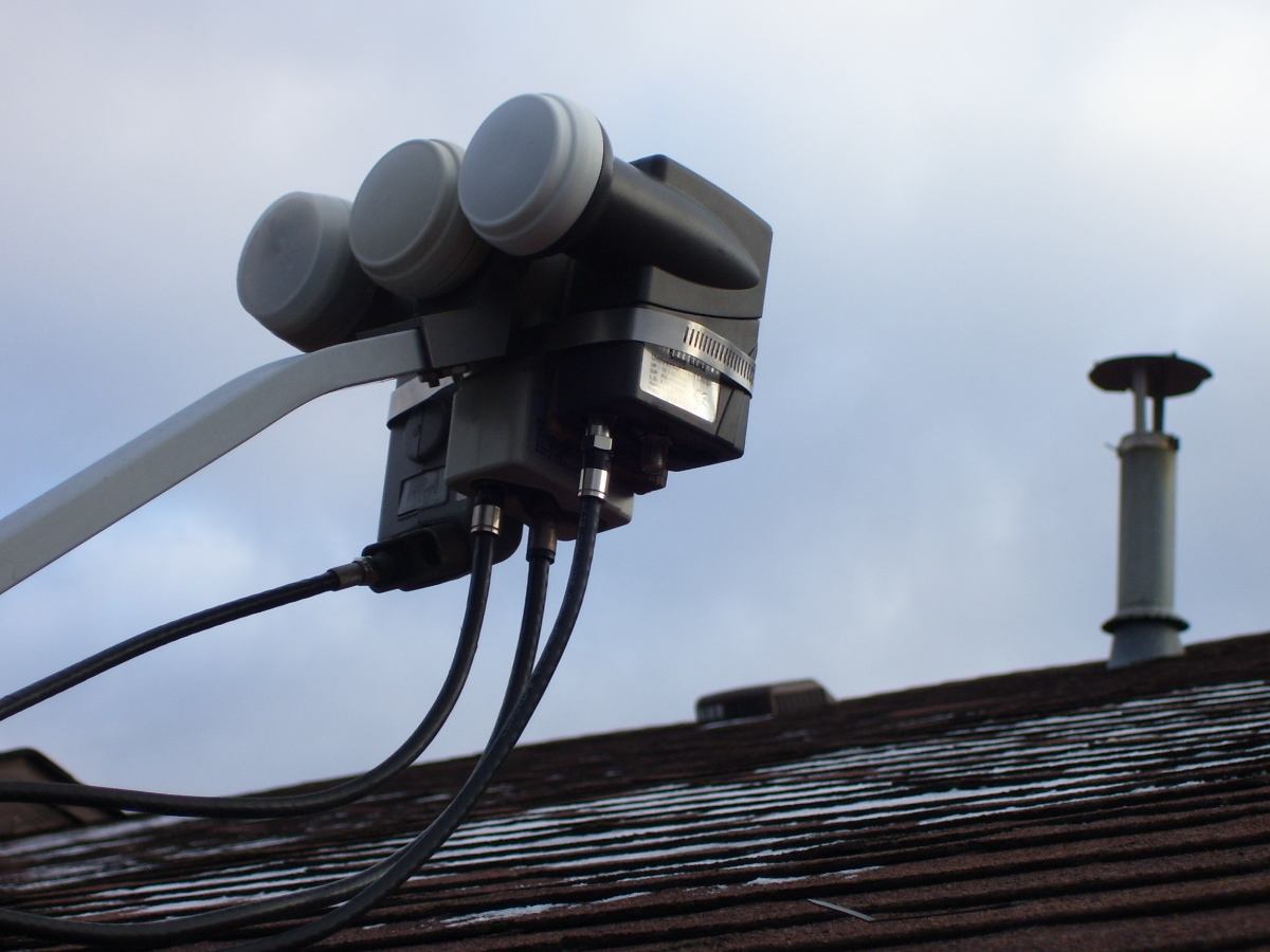

depending on your KU LNB and what shape it is, some DBS LNB's are easier to mount on there
I have a Sadoun dual which looks like a "block" LNB...the DirecTV DBS rests right next to it and a hoseclamp holds it together
The attached pics are when I had a Universal (for IS9 58W), the standard and a DBS....the Universal has since been removed

Mine is one of those little geosat bullet lnb's, very small.I might try to make a mount for it to attach to the support arm?
