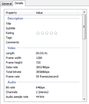

So I'm watching this feed, and am recording it, but occasionally get the message "Device too slow to record" or something like that. Am using a SanDisk 32GB drive. The feed was high bit rate, see attached. Would this still have been an issue had I been using a regular harddrive? The recording sort of plays, but is botched in too many places to be watchable.
The message is displayed due to the USB drive not being able to support the sustained throughput. You will not have this issue with a hard drive, 2.0 or 3.0 USB controller and external power supply.

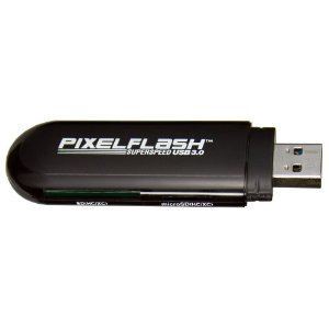

Tron, is this (+ some memory) what you had in mind?
Although I've never used that particular brand, it should work. I've used an SDHC Sandisk reader in conjunction with a Class 6 card without problems. Class 10 would be even better, for example the Sandisk Extreme III series cards. These tend to get a bit pricey though, but I already purchase them for use with my 3D camcorder.
