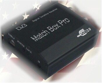

DVBTech is USB 2.0-to-8 psk Turbo card Adapter similar to Genpix Skywalker-1. The card itself can't receive DVB-S2 channels, same for the Adapters. Matchbox Pro is also DVB-S tuner that supports QPSK demodulation only.
