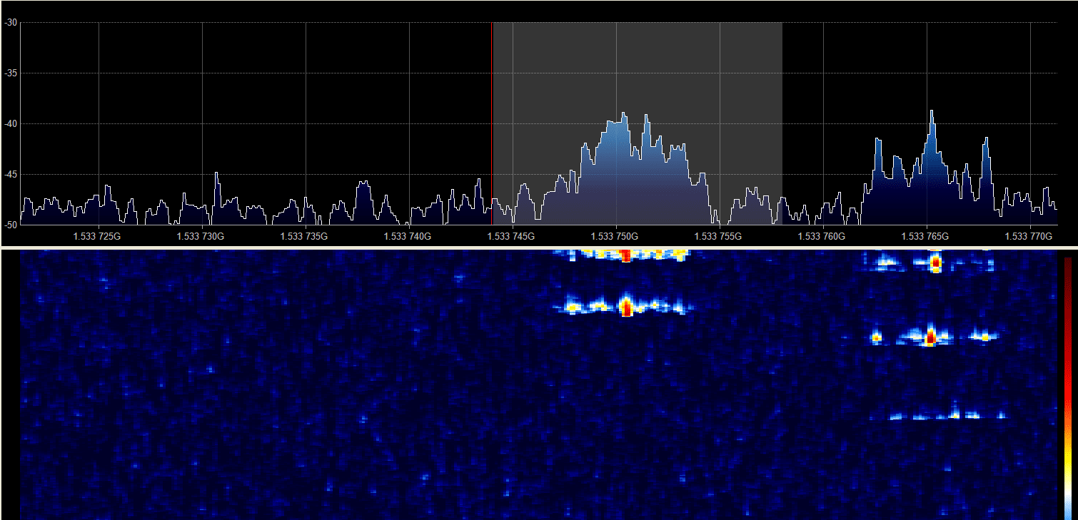

As luck had it the list of requirements that John posted perfectly matched everything attached to the PC under my bench so it was a five minute job to get it running. The 1.8m dish connects to a ProfTuners 7301, that loops out into an Airspy SDR running SDR Sharp tuned to the IF frequency and virtual audio cable allows the recovered audio to be used in Jaero. DVB Dream runs in the background to power the card and set the polarity.
Talking of polarity that is circular so you'll need to insert the depolariser plate into the LNB, I'm using a homebrew version that improves circular reception with good results from the two satellites I've been monitoring at 15W and 64.5E. I'm going to do some further searching today to see if 54W is active on C-Band. Jonti has a PDF showing possible activity on 98W and 178E but worth checking these on N2YO if you don't hear anything because 64.5E is quite heavily inclined so there are times when it's at +/-3° from arc that I don't see it.
Although I'm using an Airspy this does work on nothing more than a ten quid sdr dongle so no need for a lot of expensive outlay if you're set up for C Band and have a receiver with loop out. I think some of the dongles work better than others so worth checking which chipset it has before buying one.
The next stage of development is to add support to Planeplotter, Jonti has already added UDP streaming output to Jaero so hopefully Bev will soon have a test version of PP that accepts the streamed data. If you're into transoceanic flight monitoring, C Band and HFDL should cover all bases!

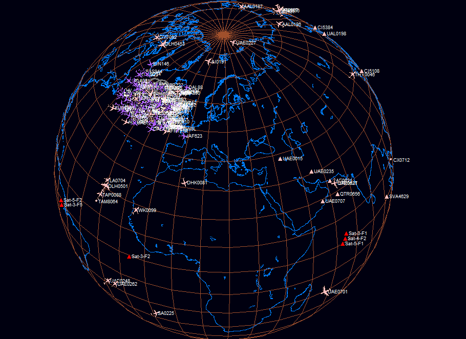

Just a brief update on this project, there are now versions of Jaero and Planeplotter that display planes on maps. Jaero does the hard work and can output data to either Virtual Radio Server or Planeplotter. I've been experimenting with SDR Sharp and can now decode both channels on each satellite to increase the available data even further. This weekend I've added a second actuator to my dish so I can track the inclined orbits of the Inmarsat I3s over the Western Atlantic and Eastern Pacific.
A short video showing decoding of two channels being merged into one feed on VRS.
Hope no one minds me updating the thread here , but above is the latest development from PP for those receiving and viewing ADS from Inmarsat at C band.
Thanks to some hard work by a number of dedicated sharers we now have a wide network of satellite ground stations .....but we still need more ! :O)
