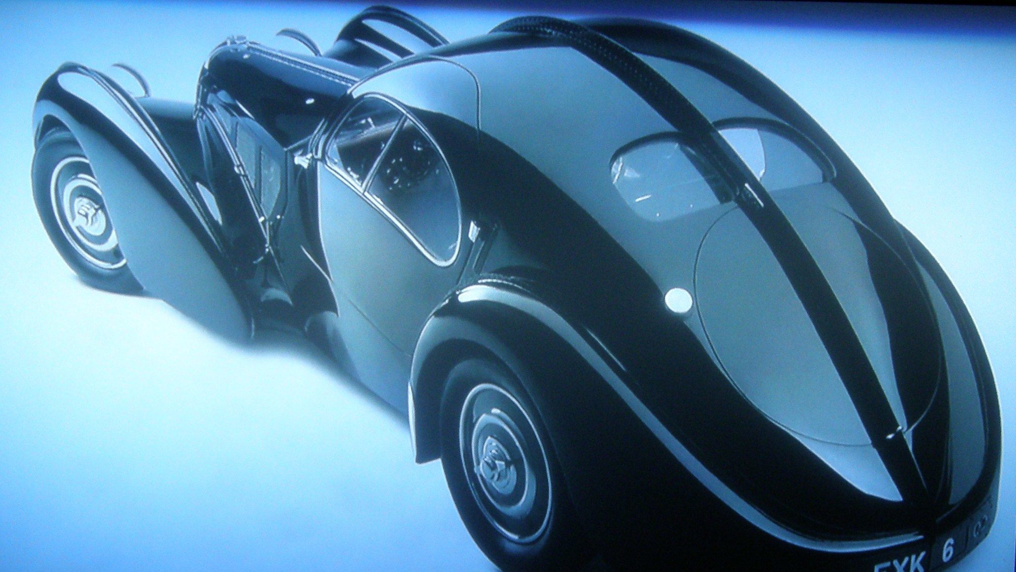

I currently have a Toshiba 50HM66 DLP TV that has just begun having an issue today.
Please notice the nice dark wedge on the top of the screen. Does anybody have a clue what might cause this? This happens with both my Directv HR20 and PS3 connected via HDMI and component.

I have a 56HM66. This is a known issue at Toshiba and you will need a new light engine. Fortunately, Toshiba issued an extended warranty on this problem and will replace your light engine at no charge. For further information, check this site:
TACP Customer Support

This is good news as my serial number is one that shows it may be impacted. I also have a extended warranty that will also help with the fix. Now my question is should I allow Toshiba or Best Buy replace the light engine? I am assuming that Toshiba just outsources this type of work also.
I think you need to contact Toshiba and they authorize the repair. Don't know who they send. It may very well be BB.
contact your warranty provider (if you still have extended warranty in effect). Do not contact Toshiba if you have an valid extended warranty.
For recall issues, the warranty companies will usually refer you back to te manufacturer. Their problem, their cost. Happened to me with my Mits.

Exactly. Greg is right for normal warranty, but this is a special extended warranty by Toshiba, tied to a known problem. If you read the page I referenced above, you will see that they say to contact Toshiba in this case. (oops. reread the page and the statement to contact Toshiba appears in the page after they validate s/n)
I tried to call Toshiba but they were closed for the weekend and holidays. I was able to get through to Best Buy and they will be here on Tuesday morning. The worst thing that happens is that they say to call Toshiba and I will do that. I won't get through to Toshiba until Tuesday so I figured I would at least give Best Buy a try.
Well Best Buy was out yesterday and they put the new light engine on order for me without any question. They were well aware of the Toshiba recall and that did not make a difference. Now it is just a waiting game for the part to get here.

Thanks to everybody that responded with information. BB was out today and replaced the light engine and bulb. Now the picture looks just as good as the 1st day that we brought it home. The only thing I wish is that they would have just left the bulb and let us replace it at a latter time. The one that was in it know was only 4 months old.
