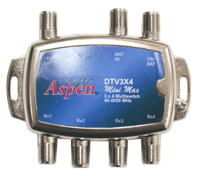

BUT you said the cables "were the ones that were running to the box and then the house" what do you mean by "the box" ? Do you have a multi0switch in the cable run? Similar to this one. cause if you don't have more than 4 receivers, you don't need it. AND if you do do over 4 I am not sure, but I don't think the old one works with the new dish. Could be wrong.

I'll have to take a look at the switch that's in the box. The box is outside where the lines from the dish go in. I do have tivo in one room which takes two of course. I am only using 3 receivers.

Well I would say if you have a switch between the dish and your receivers, that it is the issue. The PhaseIII dish has a built-in 4 port switch, so the RG6 cables so go directly from the outputs on the dish to the receivers with no stops. Up to 4 tuners as we discussed before.

Cool, if you can take a pic of the switch (if its there) and uplaod it here. some switch are perfectly OK but need to be wired correctly. See ya later.

I did have that switch. I have pulled the cable and run it straight through. I can pick up 101 and 110 but not 119 today. I have to believe that it's an obstruction problem and will relocate the dish and see if that helps.

That very switch is in there. I still haven't taken it out. I left it in there with the other two receivers. That wouldn't make a difference would it? The cable for the hd is running straight to the receiver. the other two are hooked up to that switch because there are two more rooms that could have tv if i wanted. since the whole house was prewired they are hooked up to the switch.
