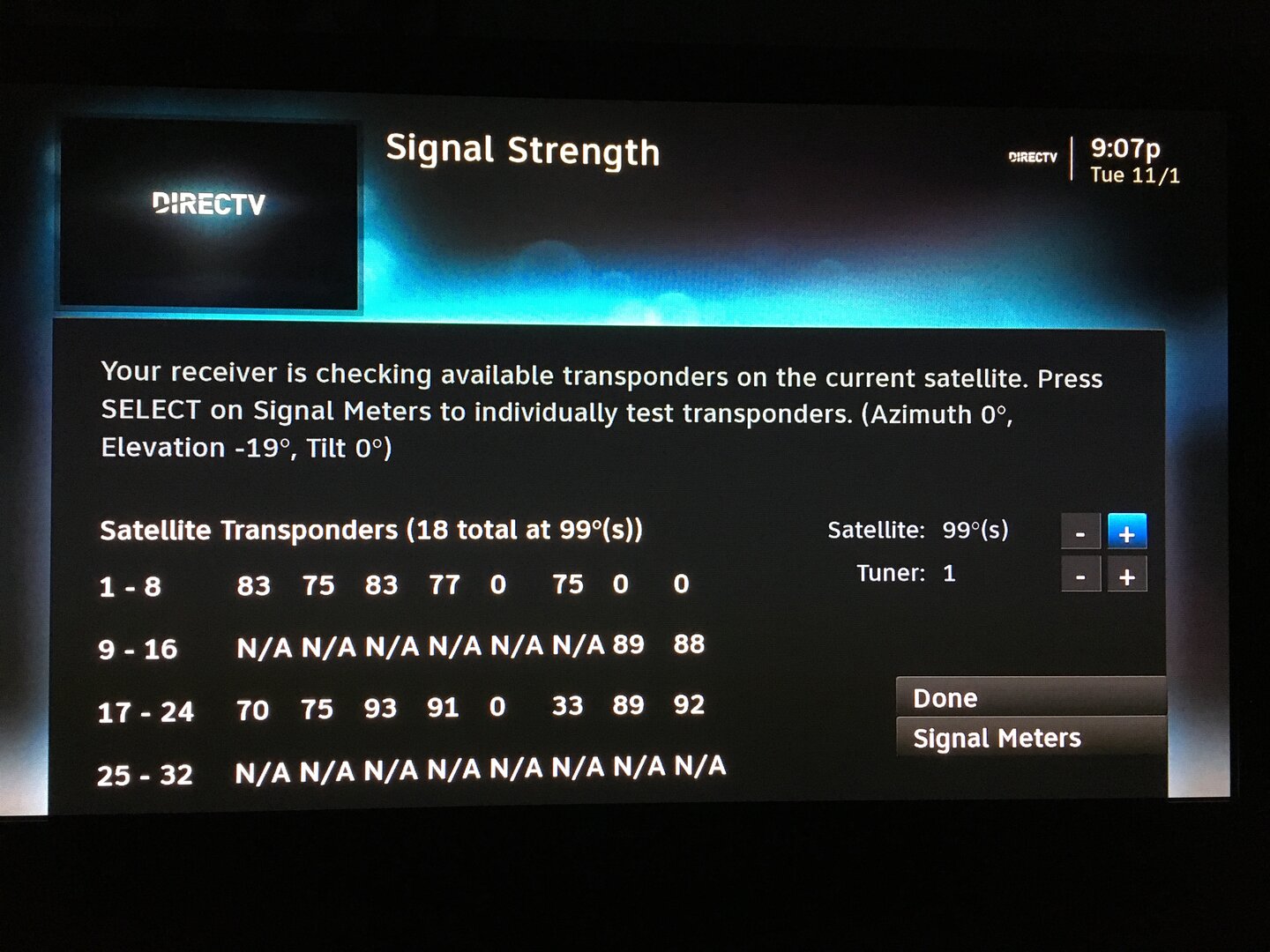

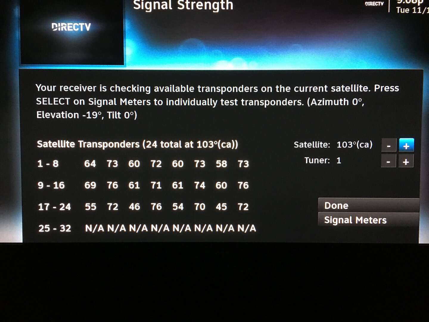

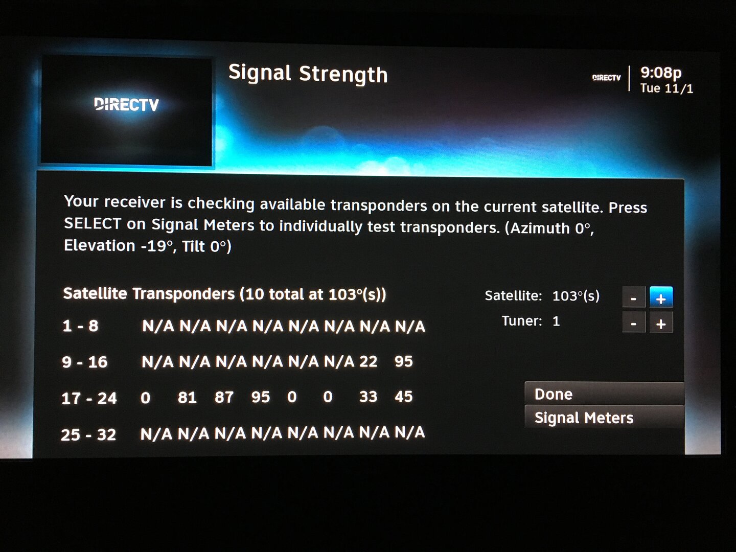

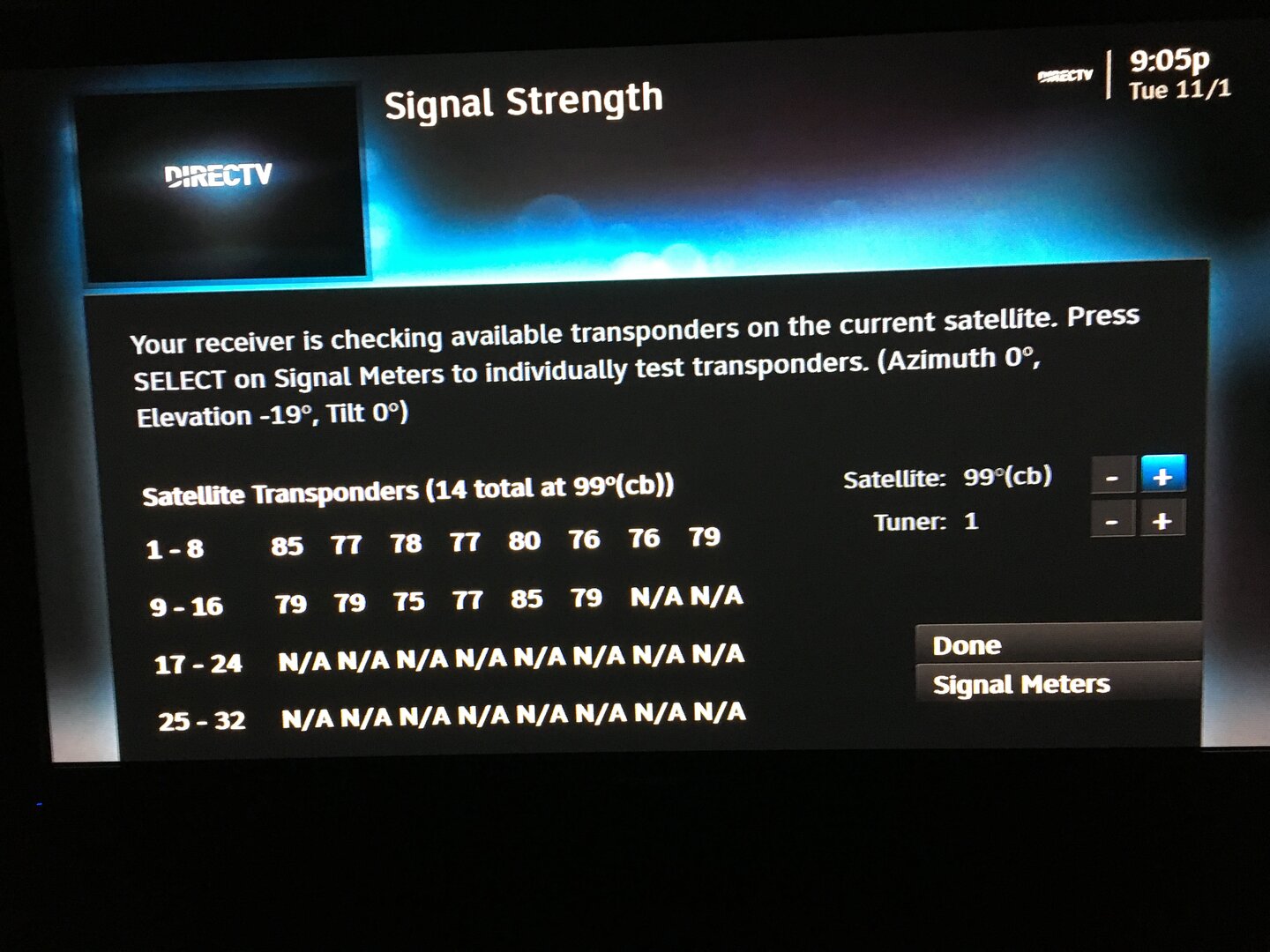

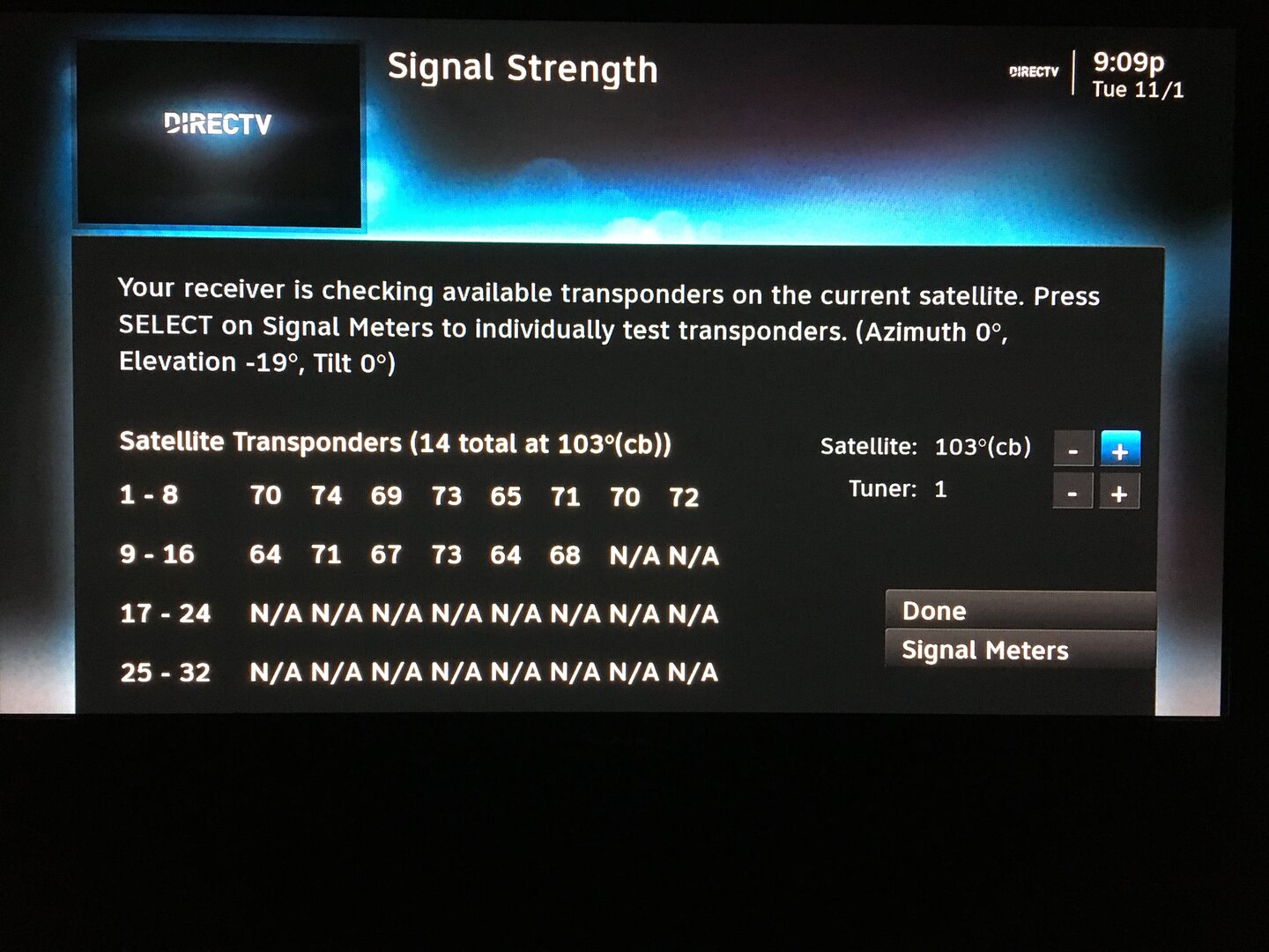

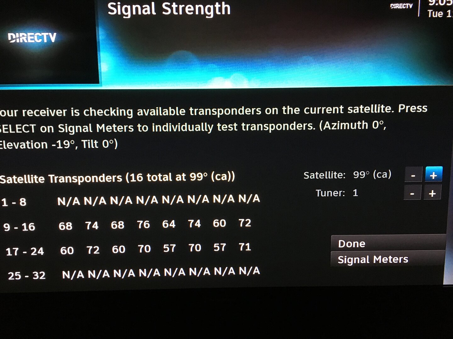

The numbers I quoted were for Satellite 101 Transponder 1. Like I said, I moved the dish before checking this forum for replies so I don't know what 99CA T14 was but, now it's 74
OK, you need to tweak more when you get to it.
I would while looking at your numbers, gently put pressure on each side of the dish and see if it improves ... this will give you an idea where its got to be adjusted.
