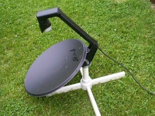

Here's what I did when choosing a spot for my Ku setup. Made a temporary mount by bolting a Super Dish mount to some 3/4" plywood and sat some blocks on it. I could freely move it around the yard then and explore the arc to verify good LOS.

It does not change the angle that the signal comes down at! I think the main reason they designed off-set dish was to exclude as much background noise as possible.
Have a look at the below off-set dish!
Does not matter what type of dish same elevation angle coming down from the satellite.
