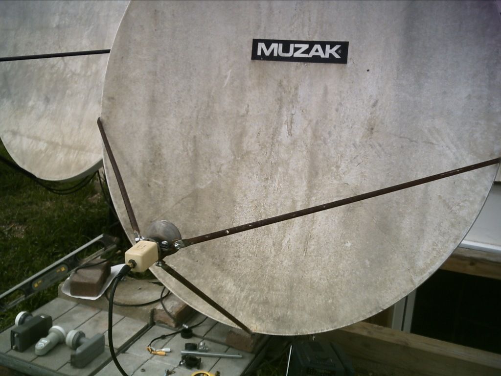

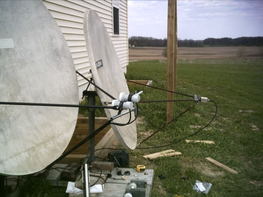

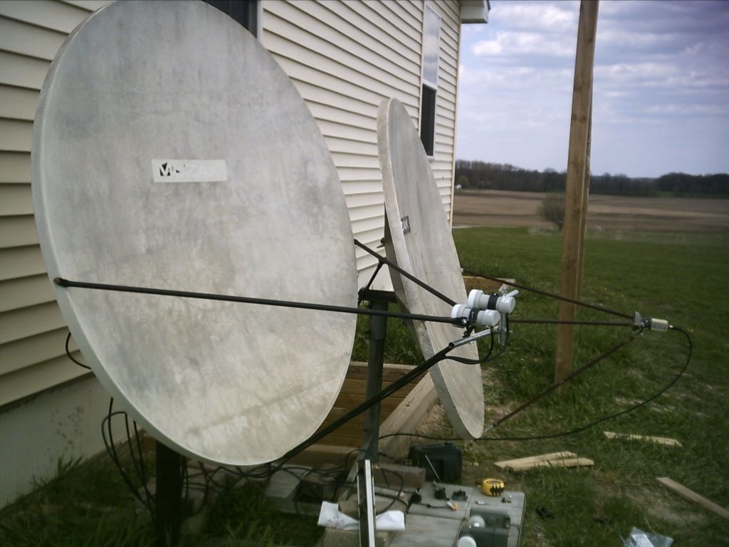

I finally got it tuned in on a stationary 1.2 dish that I may in the future motorize. I had a tv out there and satellite finder and tried 4 lnbs till I got it tuned in. I tried and tried with boughten lnbs, I tried a linear dual that I know works, I tried a boughten universal that I know works, I tried a dss to find 81 bird and I was right on my pointing and elevation. I figured out from elevation that it should be from Sadoun sat find program that the elevation should be 1.4 higher than my dish on sat 97 which I set at starting point. I tried and tried till I thought as a last resort I would put the commercial lnb on the dish that was on it when I pulled it down on a roof. It is a muzak dish. I do not know what type lnb it is but it works great. I have both horz and vert channels working with a 87% quality on both RTN channels. See pictures below.Thanks for bearing with me through this set up and thanks for input from all.
