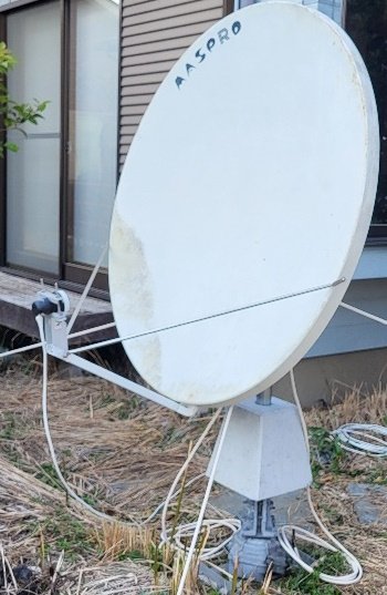

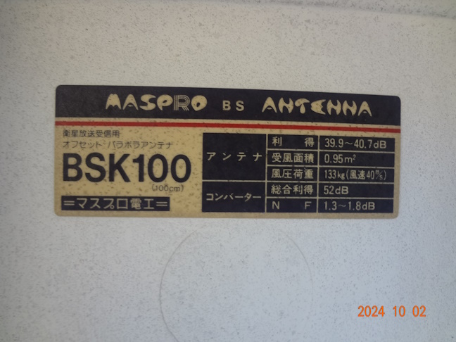

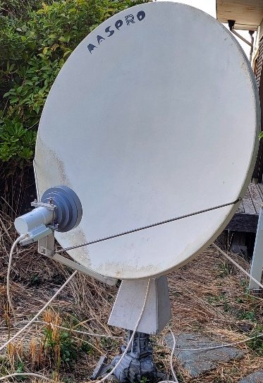

I have a lead on a Maspro 1-metre dish not too far from my location. This is a high-quality dish as you can see in the photos attached. The owner is getting older and feels he needs to get rid of some things. He is only asking US$35 if I can take it away. My challenge is to figure out how to transport it when I have no personal car.

I have a lead on a Maspro 1-metre dish..... My challenge is to figure out how to transport it when I have no personal car.
The local courier company advises they will pack and ship the dish to me as they would handle a large household appliance. I should receive it next week. So total cost including purchasing the dish is only going to be about US$90 delivered. Sometimes I get lucky. I can install it in my driveway on the ground to start and see from 144E through 86E between the houses.

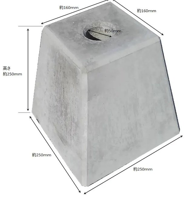

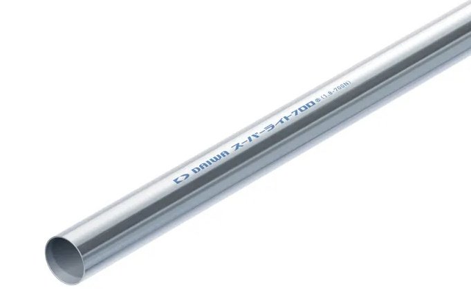

So I have a new idea. I will source a 50-lb concrete block and a 5-foot long 2" pipe from my local DIY store. Both are available at reasonable cost. I must put these on my bicycle and push the bike home. They won't deliver concrete blocks, for some reason. What we do for our hobbies!
You can use your imagination of how I will use these items to create a mount for my 1-metre dish at ground level with easy access. I will combine them with multiple strong tether ropes to hold the portable mast upright and level. No motor is planned for this installation to keep things simple. I need to be able to re-locate the dish at different spots at different times to be able to cover the visible arc here from about 100E through 172E.

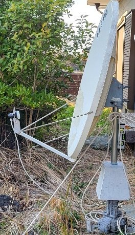

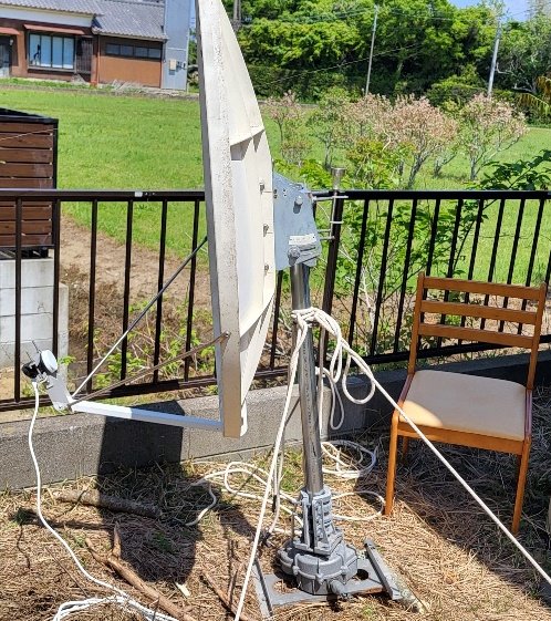

I have signals! The dish is ground-mounted sitting on an old heavy-duty azimuth rotator only to hold the base of the mast fixed yet loose enough to allow manual azimuthal rotation and a 50-lb concrete block to help stabilize the assembly. All supported by heavy ropes. So nice to have non-rusted bolts to allow easy elevation adjustments.
First sats received were 124E and 128E both JCSAT with SQ at 85%. Not much to see so far since most channels on these satellites are encrypted but I am seeing promotional channels and three ever-present shopping channels. It's always thrilling to receive your first signals from a new installation. Now the fun part comes exploring the rest of the arc. Looking for 113E which should have BBC English.

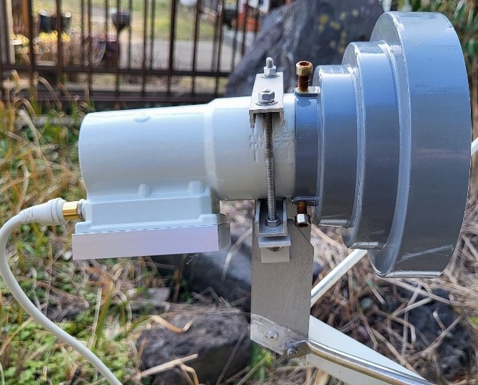

Today I tried C-band. I wasn't expecting much since I have the Titanium LNBF mounted on a 1-metre offset dish. Was I surprised with the results.
I was able to blind scan in four video and four radio channels on the AFN encrypted circular transponder from 169E Horizons 3e. Nothing to watch or hear but it was great knowing I could receive it. It's C/N lock value is just 1.0 dB which helped.
I also blind scanned in 19 transponders from 166E Intelsat 19. I could lock all but one transponder. Per Lyngsat, there are many encrypted tps. But I am able to view NHK World/Premium, Arirang TV which is Korean TV but in English, a Philippines Knowledge channel, EMTV from Papua New Guinea, and others. Also there are many radio channels.
I also blind scanned in transponders from 159E ABS6, 154E JCSAT 2B, 145E Express AMU7 and 138E Telstar 18. Though I scanned in many tps from these, only 145E allowed me to lock one well enough that I can view two Russian channels. Though I can't understand the language, it's still interesting to see the images that Moscow is showing its audience.
C-band is certainly more interesting than Ku. There's still more of the arc to explore. No evidence of 5G interference here yet. I'll try for 96.5E Express 103 tomorrow and see if I can scan in Korean Central TV from North Korea in HD. Lyngsat says it's available.

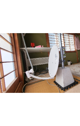

Now a 2-dish home. I just received via Amazon Japan today a 45-cm dish with LNB compatible with the Japanese domestic satellite system. Complete assembly just US$48 delivered free to my front door.
Installed indoors, it looks through a window and receives SQ81% signals from 110E. Very easy to point. Now receiving many HD tps with it.
Mounted on the floor using a 50-lb concrete block with a 3-foot long 2-inch diameter mast.

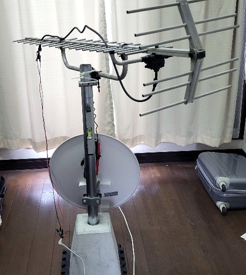

ADDED: Next plan is to add a high-gain UHF yagi on top of this mast to also look through the window to pull in OTA channels.
