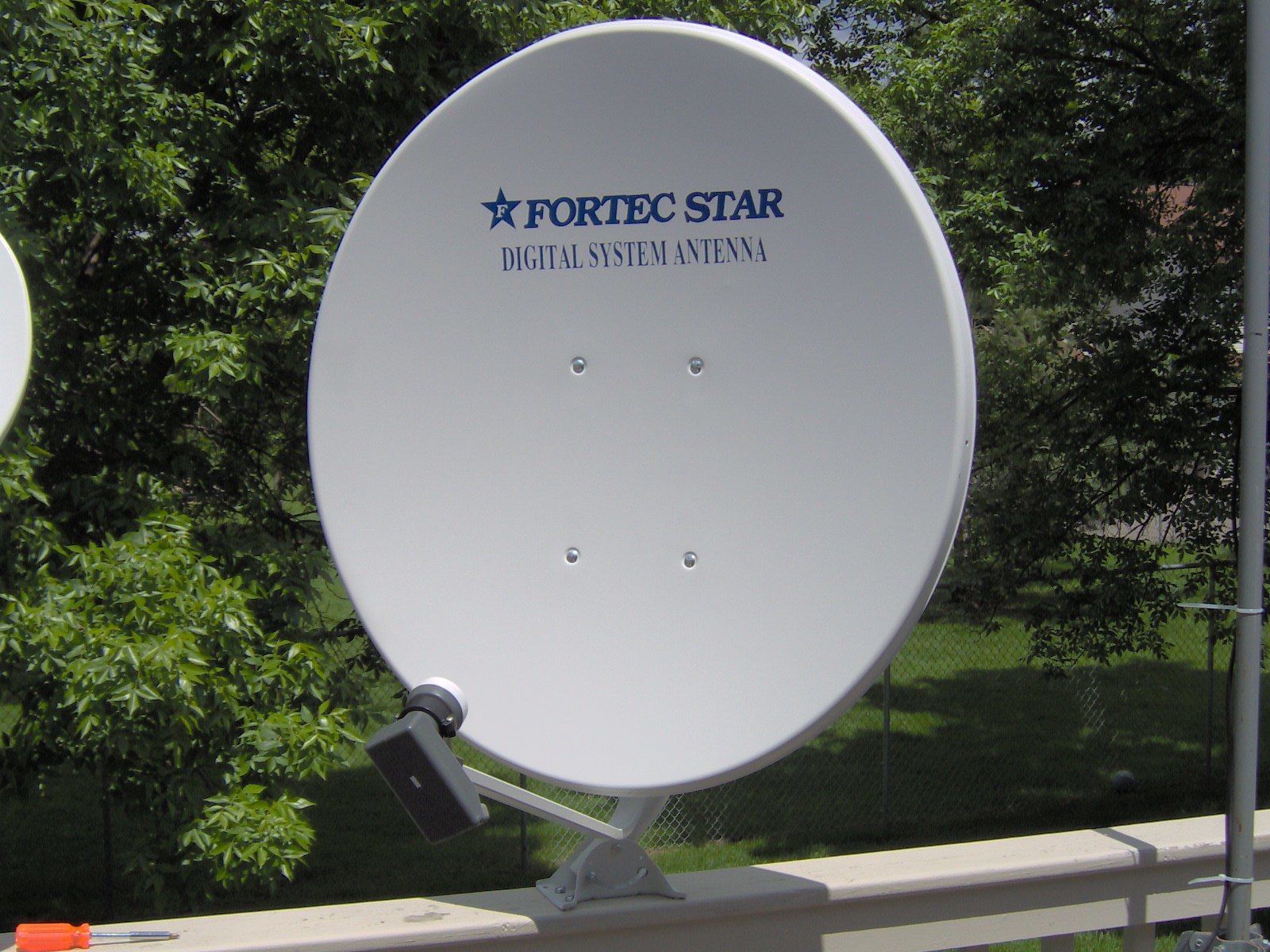

M Mr Tony SatelliteGuys Pro Supporting Founder Nov 17, 2003 4,439 18,234 Mankato, MN Jun 21, 2011 #6 LNB frequency needs to be 10750 the skew needs to be around 35. skew the LNB counterclockwise (if you stand in front of the dish facing it) like in the pic below Attachments Fortec with dual.JPG 306.4 KB · Views: 230
