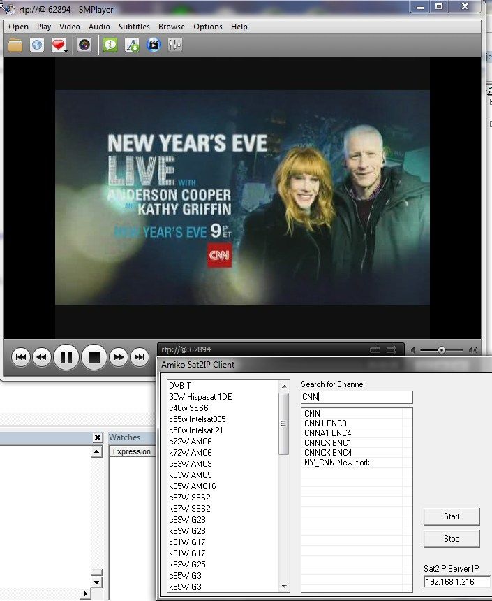

Thought you Amiko and Windows users might appreciate this picture. It feels good to be the first person to officially stream a Amiko onto a windows machine. I have some clean up to do on the code, but I thought I would post this MILESTONE :
