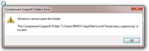

I downloaded the zip file. It says the zip is invalid. Can you check it?

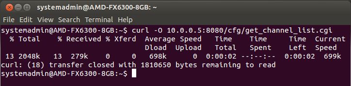

Figuring this out is getting a bit above my skill set :rolleyes: but fyi, I ran curl in terminal on my own system. I had to use 10.0.0.5 since that is the address the Amiko Mini HD SE is located on my network. I got this result:
After executing the command there was a file in my home folder called get_channel_list.cgi which, when opened in gedit, showed a list of my satellites and the channels associated with them.
You can also specify a name of the output file to something more suitable with the '-o filename' instead of -O

I downloaded the zip file. It says the zip is invalid..
Could be blocked by windoze. locate file , right click on it and select properties. UNBlock.
If that's not it, I'd suggest the 7Zip program.

Also I just downloaded and extracted the nasa ZIP file with no problems here. Win7, 7zip.
