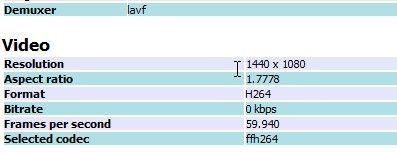

I think i might have found a/the problem. The High bitrate is decoding using
But, the video is in MPEG4. This explains a lot. So, i need to figure out if i can force the DEMUXER to be used.
Okay, i got the Stuttering licked. It was a matter of getting the correct settings on the MPLAYER so the demuxer is properly handling the Mpeg stream. I am now successfully watching SD and HD programs on Windows through MPLAYER.
