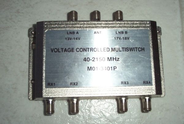

You could use the old one and buy a frequency stacker that would place one of the polarities above the other in the 1450-2150 MHz range.
... or use a Voltage Controlled Multiswitch.
I have one here. It has two lines for lnb's, one for H and one for V; it's switched automatically depending on the voltage given. The ideal addition for an lnb with seperate H/V plugs ;)
Yeah that will work too, I am just trying to over complicate it as I always do...
Wholeshoe
Charred can you explain that a bit more. just a simple layman here. voltage controlled multi switch, does that go on sat or receiver? i think maybe i have one of those for a old c band receiver someone gave me? is that possible?
It's very possible. As I understand it, it's an old device used used for combining 13-14v and 17-18v lines into one cable. Basically (I forget which, somone chime in and fill in) H is one of those voltages, and V is the other. This thing detetcs 13v and then switches the signal over to one plug on the lnb, or else detects 17v and switches over to the other plug. Nowadays lnbf's do this automatically, but if you DO have an old two plug H/V lnb (like old PS ones) then this will let you run a single normal line from your modern day receiver to the dish, into this switch, then have two lines into the lnb.
If I'm dead wrong about this, somone correct me, I haven't had a use for this yet :D So I haven't experimented on it.
Charred...you're right
The old Primestar LNB's did have a separate V (13) and H (18) lines. The polarity couldn't be changed. Using the multisiwtch above would combine them so you don't have to flip cables or a switch. When you are on a verticle channel, it would go to that side of the LNB.
Don't confuse this with a dual LNB, which looks like that but both polarities run through it.
A multiswitch also is good if you want to hook 3 receivers to one LNB (like G10)

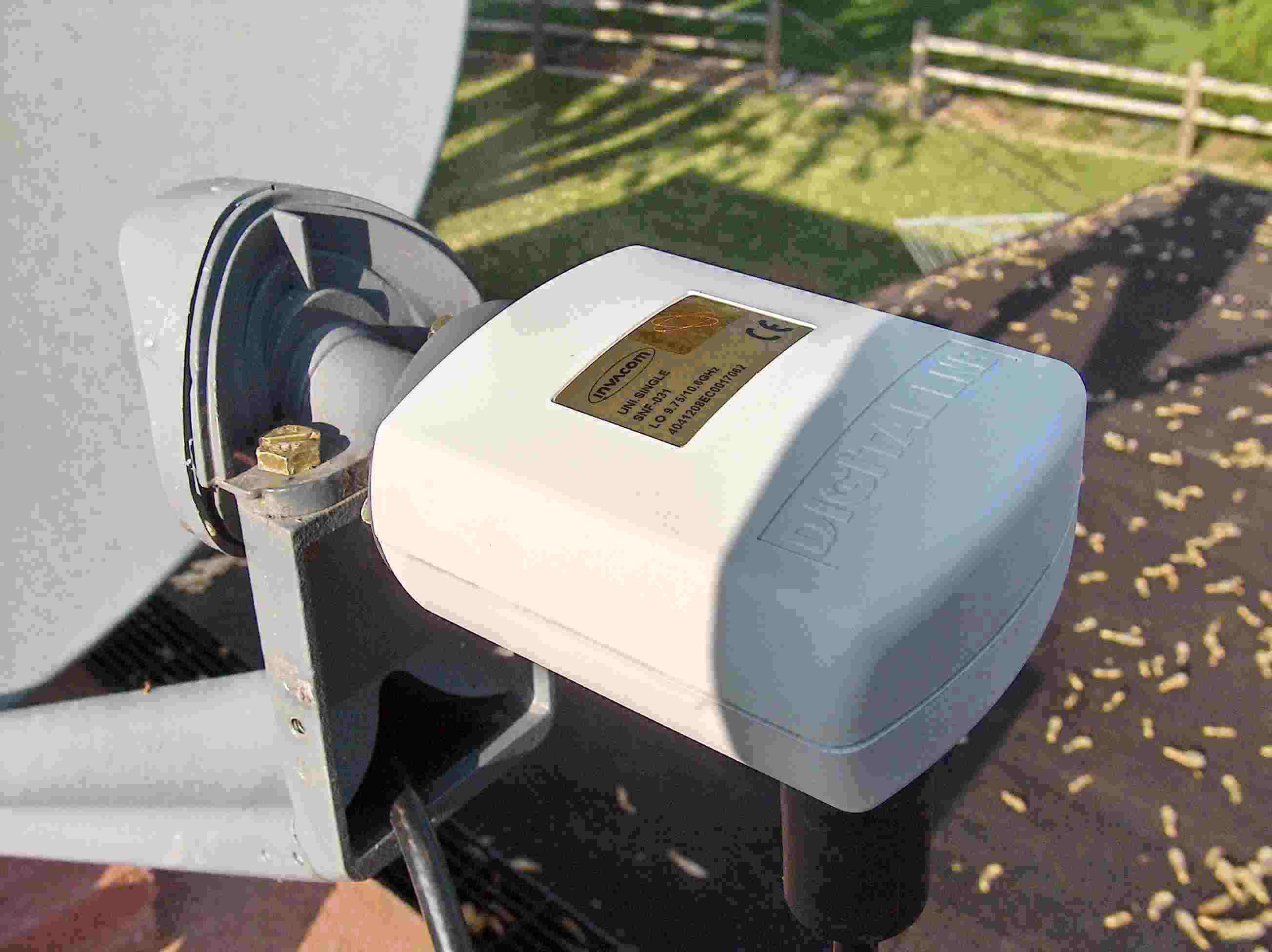

The Invacom SNF-031 works great on my 84cm Primestar dish. It fits right on the C120 flange and works like a charm!!! Thanks, Mike
Ice I just love this Invacom LNB. I'm trying to save up for a HH motor. I'm sorry I didn't have a lot compare this to to do a review. My signals on the best transponders on G10 max out my Fortec Ultra. I hope this helps . Thanks, Mike
NICE picture Mike! I will use that again and again. I like the peanuts in the background : )
