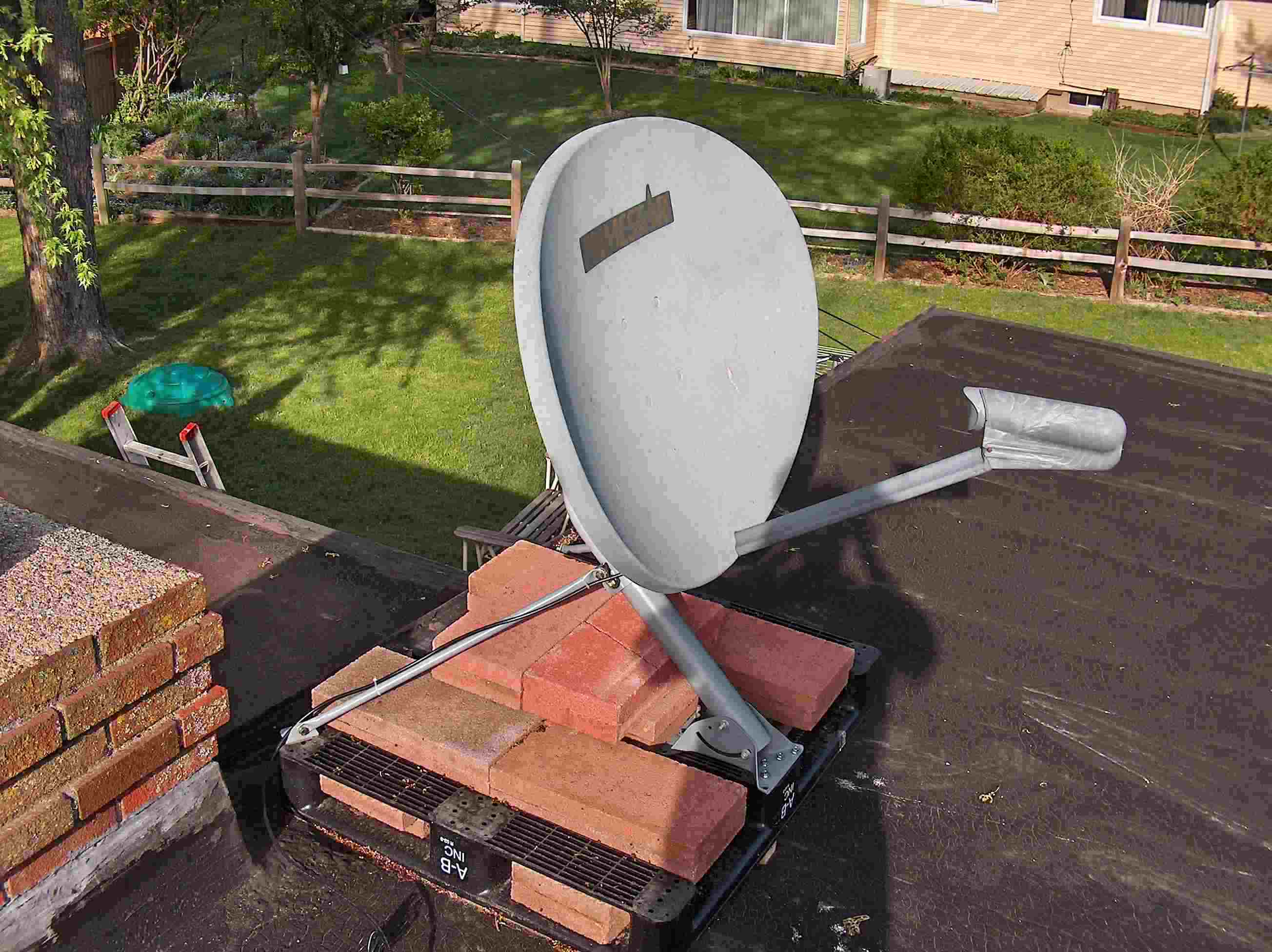

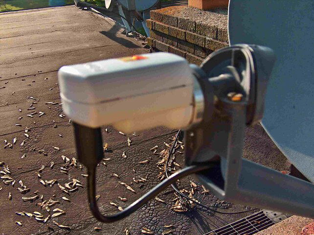

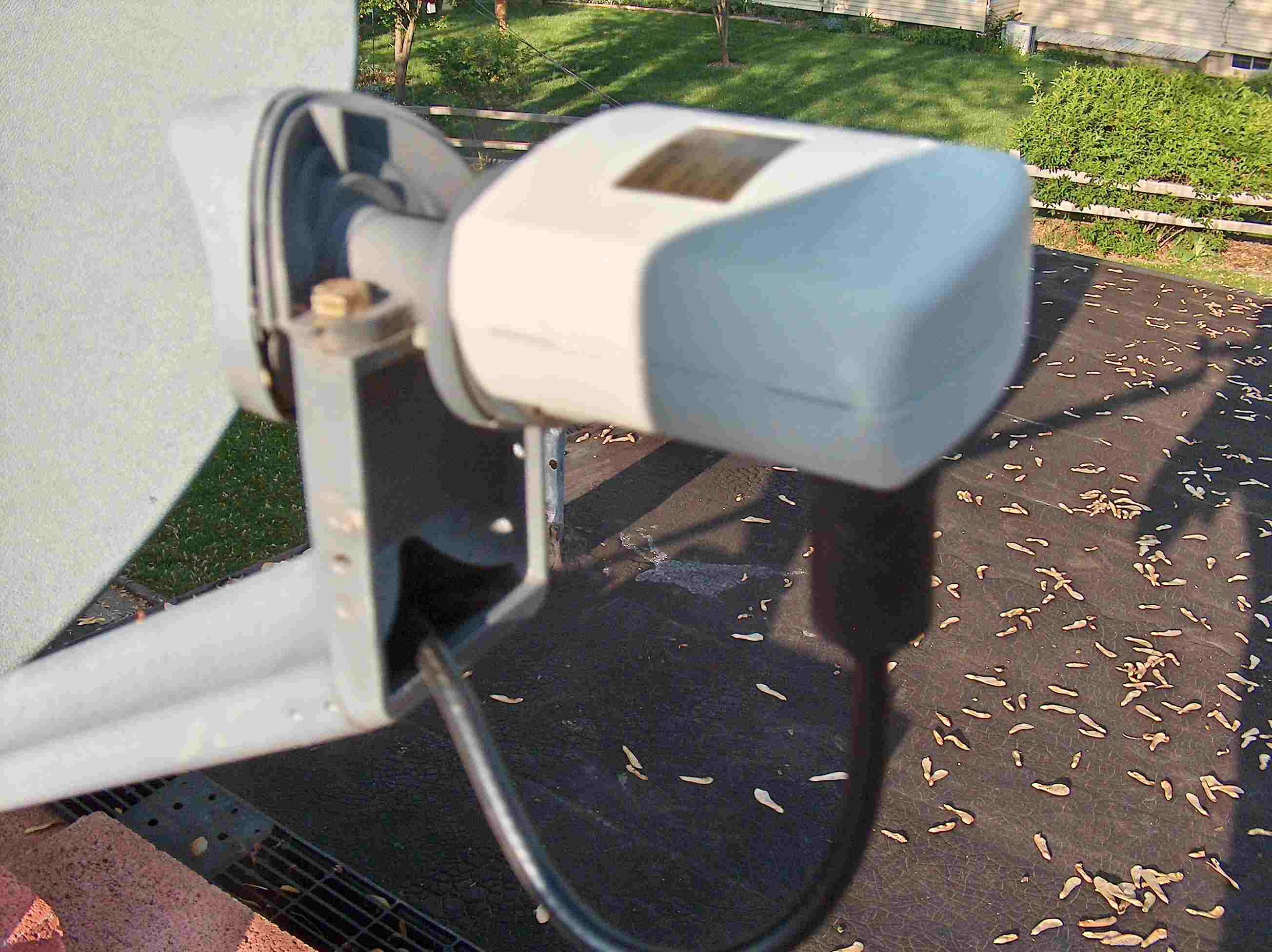

I'm sorry the Invacom pictures are a little blurred. Stefan it sure looks like the same.I hope these pictures get others to try the Invacom LNBs. I'm extremely pleased with mine! Mike

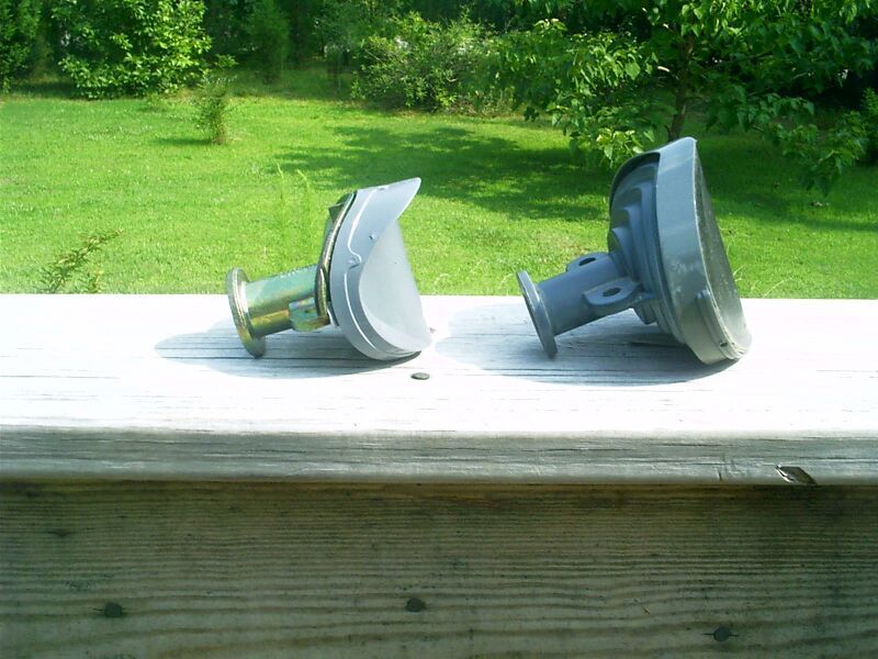

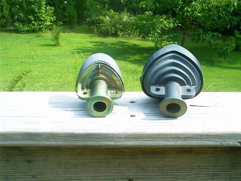

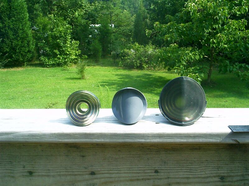

Here are some pics of the 2 different primestar feedhorns. The smaller one is around 2.5 or 2.6" in diameter. The larger one is 3" or perhaps a bit bigger. In the first pics 2 of the smaller feedhorns are shown. The 2 smaller ones are the same. I included 2 of them in that pic to show the feedhorn with the grey plastic cover on and with it removed. I didn't take any pics of the arms but on dishes that came with the larger diameter feedhorn an arm that's just a tiny bit shorter was used. So, if anyone uses one of these larger feedhorns just make sure you use the arm that it was originally attached to and everything should be fine. Anyway, the smaller one is the most common. I believe the larger feedhorns were mainly used on dishes made later.
