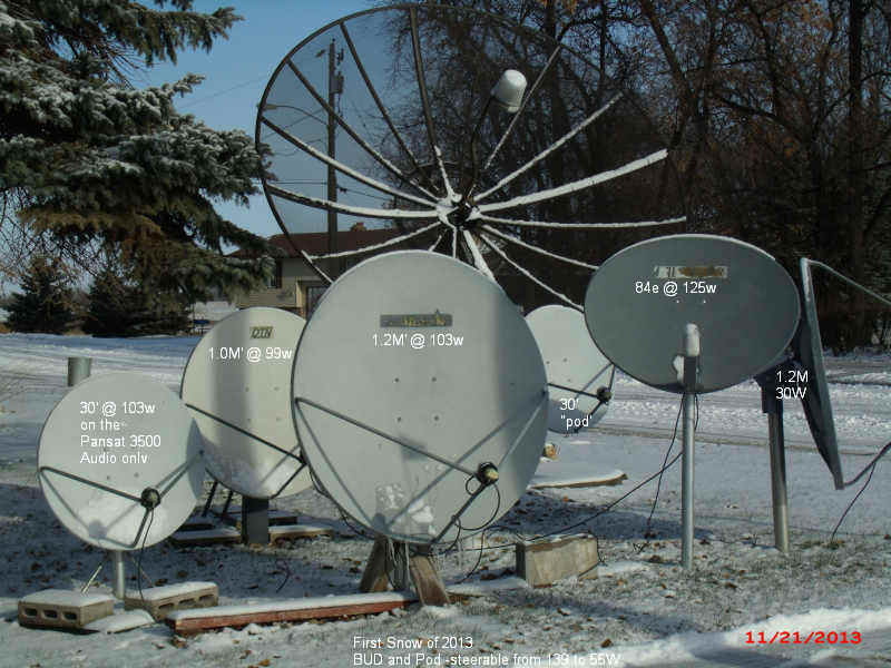

Yeah, A 10ft is the 'normal' for C band. 2° satellite spacing means dishes smaller than 10 may experience adjacent satellite interference. Getting worse as the dish size decreases. (this applies to Ku also, with a 90 cm, being the size that smaller will run into the same interference. Larger, than 10ft for 'C' and 90cm for Ku, offers more signal gathering(gain) so even better weak signal performance. Sometimes wish I had a 16ft BUD.
