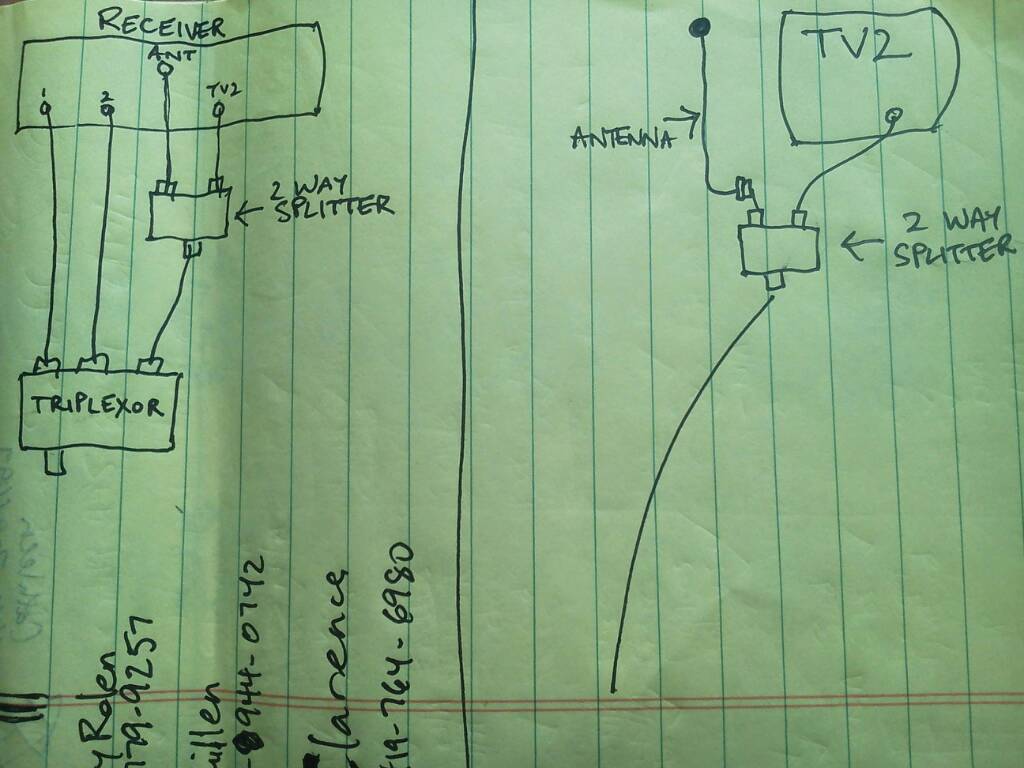

Do this...

Do this...
this
for tv 2 then there is a set up called joe's magic I install this regularly on those tv2's that have some distance away from the receiver.
you need 2 splitters and you need some short coax cables 4 of them total (well any length will do).
To start remove the antenna and disconnect the cable from the home distribution network off the back of the 722 receiver, then you hook a coax to the home distribution port and to the coax port where the normal little antenna goes(save the antenna) and connect those to the two out ports on the splitter and the input port you connect with coax from there to the home distribution port on the triplexer. then take the other splitter and antenna go to your tv 2 disconnect the coax from back of tv connect it to the input port on the splitter connect the antenna to one port and take the other coax and hook it to your tv port.
this will solve tv 2 remotes having control issues.
