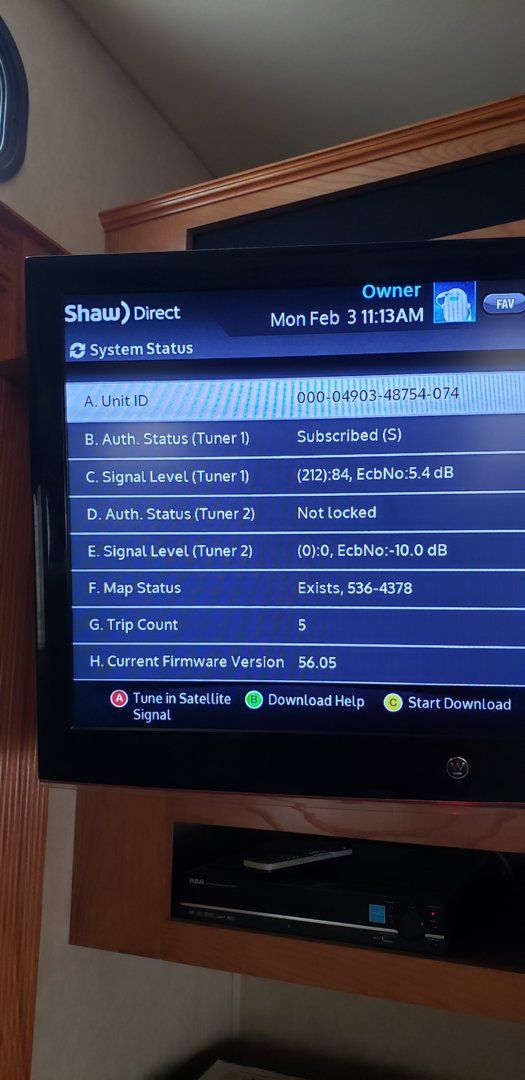

I am in Arizona and know that I wont get channels dedicated to G1 but I don't know if my problem is related to the following or that I have an issue with my HDPVR630.
On channels between 210 and 220, I get only the EVEN numbers.
On channels between 901 and 920, I only get the ODD numbers.
On channels between 300 and 305, I only get the ODD numbers.
On channels between 258 and 262, I only get the Odd numbers.
I have attached a pic of my screen if that helps. Thanks for any help. Gary

Looking at the transponder maps that Shaw offers, adjacently numbered channels are typically lined up on the same transponder so it would not appear to be a polarity issue.

Just to add to this confusion, If I'm watching ch 212 then try 258, it says "Receiver has lost signal". If I then click a channel in the 900's, then ch 212, it says "Receiver has lost..."
BUT 258 will work. So to switch between 212 and 258, I must first go to 9xx to allow the switch. It seems this causes some kind of reset or reversal of tuners? Gary
It is possible that the other tuner is being used (even though the tuner you're using is already tuned to the appropriate transponder).
If your Tuner 2 is truly dead as the picture you posted suggests, that would explain everything.
I really do not see anything wrong with your picture, except your ebno is really low at 5.4. I am not with Shaw now, but was for 10 years. Never had a Pvr unit but if you switch to channel 213, then tuner 2 should lock. Each channel alternates between tuners. You have the newest map at 4378 so you must have the Xku lnb for it to work correctly.
I think you have to adjust your dish because those signal levels are way low to lock reliably, especially since they went Mp4 HD recently.
Catamount
Every time you change channels, the receiver toggles between tuners, hence the on/off until you change the pattern.
I assume that you have two coax lines from the LNB to the receiver? If not, then you need a second line. If you do have two lines connected, then you either have a coax problem, or a tuner problem, or a port on your LNB is the problem. An easy check is to shut off the receiver, and unplug it, and then switch lines. If tuner 1 still works, then it is a tuner problem, and, obviously, if tuner 2 now works then there is a coax problem, or one of the ports on your LNB is the problem. Process of elimination will determine where the problem is.
Just remember to always unplug the receiver before switching lines, or ports on the LNB.
If it is a tuner problem, then to be able to watch any channels you get on only the one tuner, go into Preferences, then Tuners & Storage, and change the setting Single Tuner Mode from Disabled to Enabled. Of course, it will restrict viewing if you do any recordings (there is info that explains the restrictions with Single Tuner Mode).
You have been given some great advice here. If this does not help maybe take your prv to someone who has a working system. Where is your location in AZ?
In the interim until it is determined what the issue is that is causing tuner 2 to fail, in settings you can set the PVR to single tuner mode. This way you will not have issues tuning to every other channel.

easiest way to check this is put receiver on a working channel, then swap cables from the dish on the back. if the channel comes back on then both cables are fine. No need to unplug the receiver to do this either.
