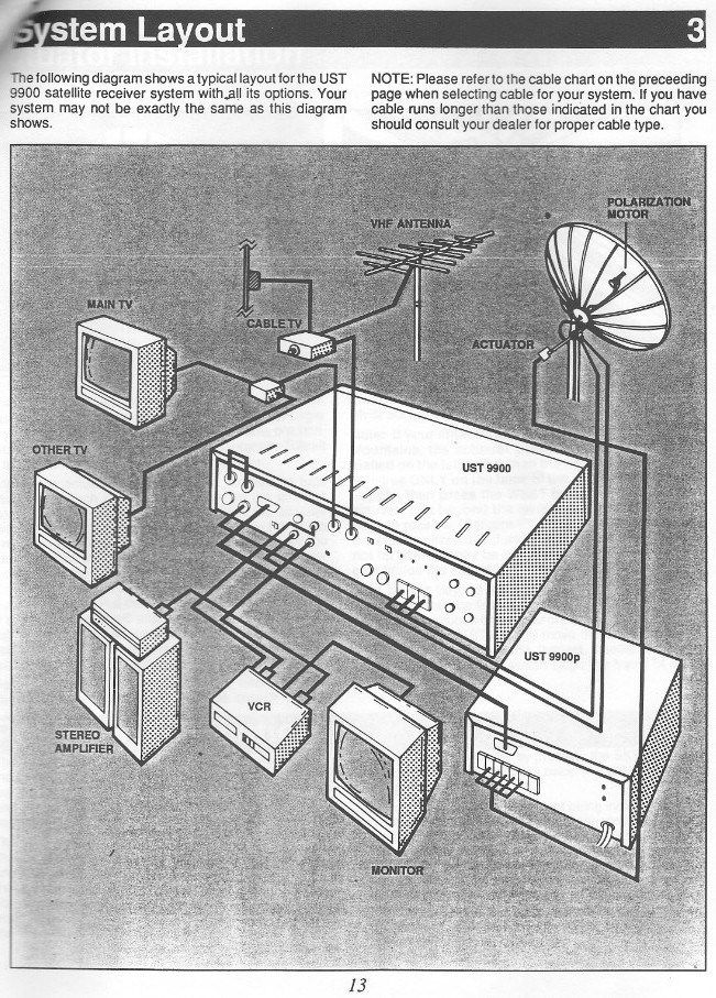

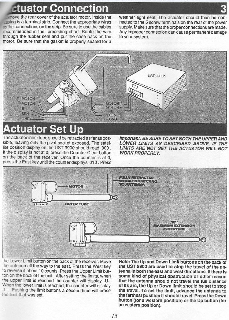

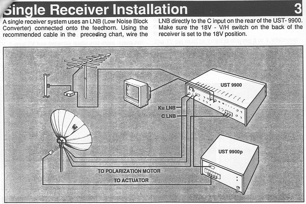

UST-9900/UST-9900p Connections
I have this equipment, though I've never used it. Following are lifted from the instruction manual. You can zoom in to see the detail.
UST-9900 Connections.JPGUST-9900 Connections2_crop.jpgUST-9900 Connections3_crop.jpg
