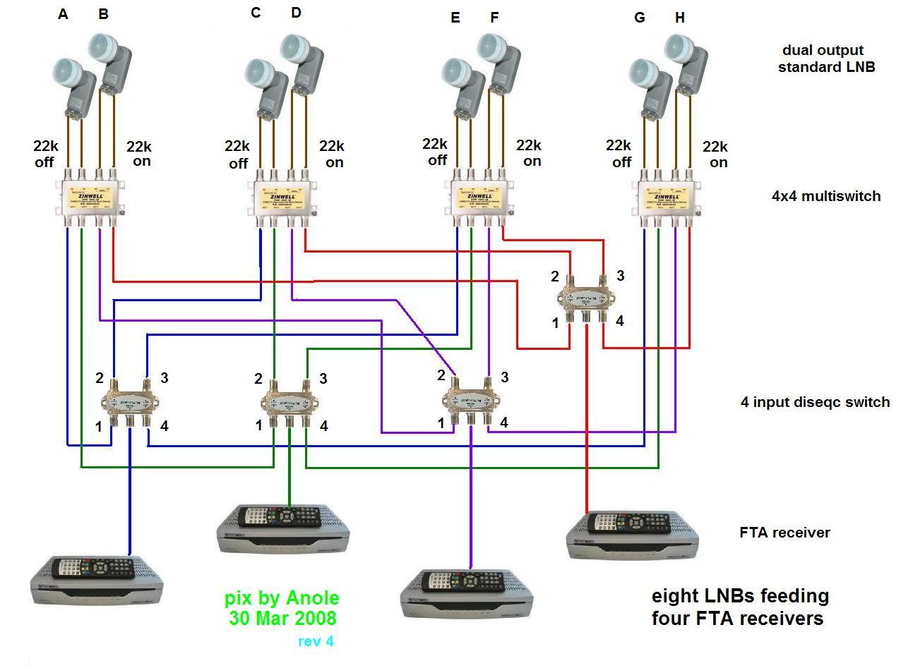

Here is the real question. If get 4 Dual C-band lnbs can I connect each of the 3 lnb to a Zinwell 3×4 multi-switch for H/V then connect a 8x1 diseqc switch. The the 4 receiver out on the multi-switch will go the Lnb in of each of the diseqc switch and the ku quad lnb will be connected also to the diseqc switches which will then go to each receiver.
Will this setup work or is there another way to go about this?

Yes (simple answer)
Or get 4X4 multi switches and then it's less parts

Here is a pic that would visualize it easier (yes it's wrong lnbs but concept is there)
Adding to the excellent advice provided by Mr Tony, powered multiswitches will make the setup more reliable.
Also if you can get quad LNBFs, then all you need are the diseqc switches. I just don't know a reliable source for quad C-Band LNBFs. But for the Ku LNBFs that should not be too difficult
Also note that if using multiswitches that also use 22 kHz, the Ku LNBFs should be standard 10750 Mhz LNBFs, rather than Universal LNBF - which these days are not easy to find
