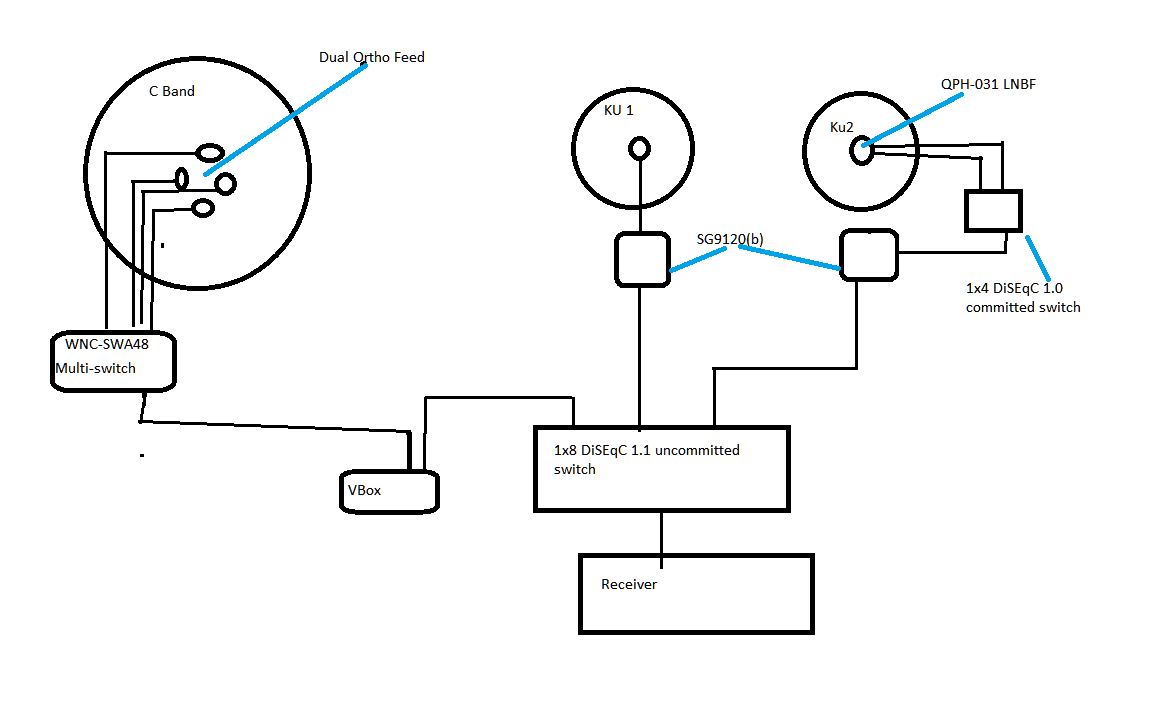

Here is a digram of what I'm doing right now with 1 Cband and 2 Ku band dishes. This setup uses three different DiSEqC switches. I have no problem with 2 motors moving at once.

Can you help me with what "uncommitted" means on the switch vs committed? The diagram does help me to a degree, having a few more parts than I do in my system.Much appreciated
To clarify for me, the C-band guy just now getting more into this.... I do the following via Coax: RECEIVER-VBOX (for Large dish) -4-WAY DISECQ (PORTS 1-3 FOR LNB SIGNAL ONLY--PORT 4 TO FEED H-H Ku MOTOR AND SIGNAL ON DEDICATED DISH
I assume any satellite I'd set to use disecq port 4 would send signals only to that smaller H-H Ku dish and not to the big dish?
DiSEqC has different protocols. DiSEqC 1.0 switch is also refered to as committed, DiSEqC 1.1 switch is refered as uncommitted. DiSEqC 1.2 for motor control. You have the VBox after the receiver and before the switch, it will read all motor commands sent to either dish, unless as someone pointed out, you use different position numbers than the ones in memory on the VBOX for the SG2100. The VBox would ignore positions that it doesn't have in memory. You cannot cascade switches with the same protocol, so I use the Uncommitted switch first than Committed or tone 22mhz control. I put the VBox after the switch so it doesn't see the commands sent to the other dishes.
