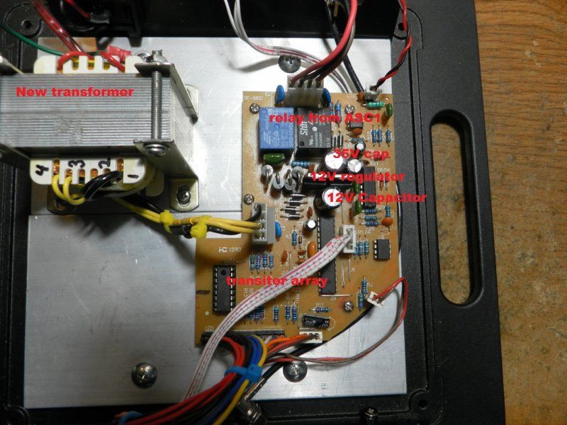

Tried to post this in the "conversations" section but there's no way that I can see to upload a picture?? So here it is and you can delete this post after you look at it.

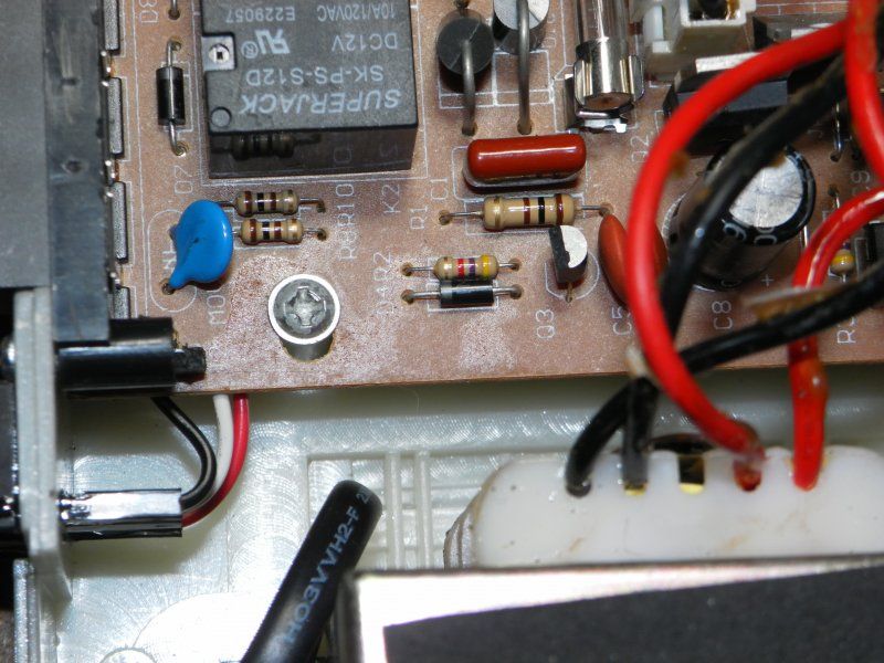

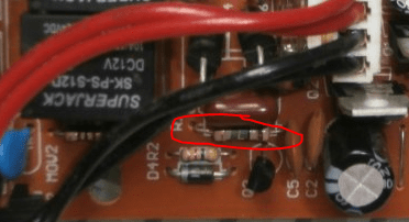

Looks like a resistor here that needs replacing....look at one of your others to get the value as this one appears too far gone to get a proper reading.
Is that transistor below that one that you changed?
R1 looks to be a 100 OHM 1/2 watt resistor 5% tolerance

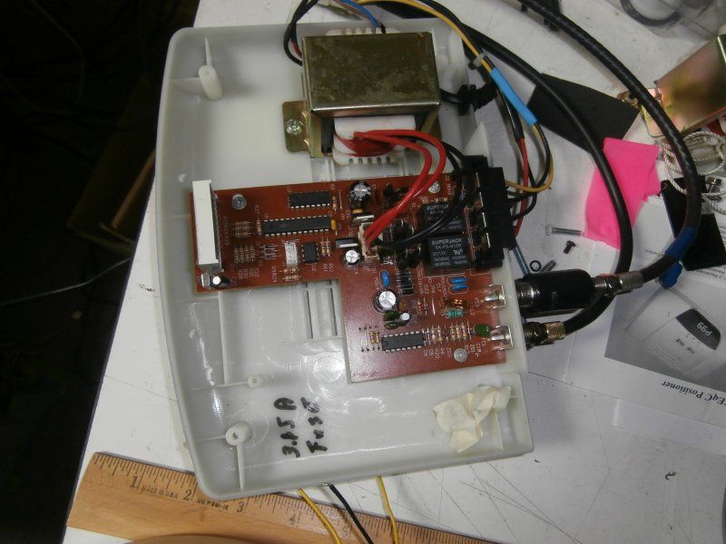

I was a mechanic like you. And I can't stop fixin' stuff. I just can't do the heavy stuff any more. But I like this electrical repair :) I know what you mean about fixing the VBox. My first VBox X is still kicking with a whole list of fixed stuff ;)
