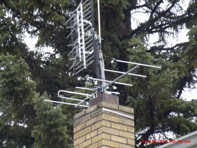

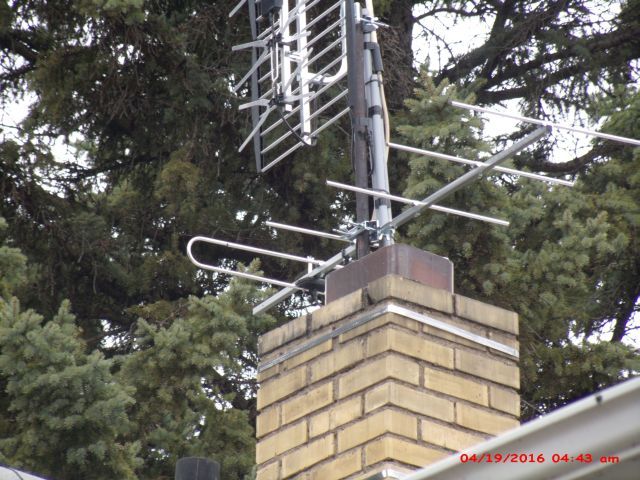

Problem I have is 2 VHF Hi stations around 170 degrees to one onother.
One could be received with a rabbitears (with some fiddlin).
The other, not a chance, even with the supposidly strong level that tvfool shows for it.
I ordered a Stellar labs 30-2475 VHF Hi antenna
But I did not install the upper and lower reflectors hoping to degrade the F/B ratio and aimed it a bit north of of the weaker station. Rear of antenna aims a bit north of the stronger station.
Rear of antenna channel signal - 4 bars (Strong by the TV's description)
Front channel - 5 bars
Well, that worked all winter, until the drizzling rain a few weeks ago.
Signal had been a solid 4 out of 5 bars for ~6 months.
But with the drizzling rain, that extended from past the strong VHF transmitter to past my location to the east, the signal was AWOL. GONE.
The signal level to the front of the antenna, the weaker station, did not change. Still showing 5 bars.
So between showers I removed the last reflector.
Signal levels now show 5 bars for the station 'off the back side' and the station off the front of the antenna. Appears that the forward gain hasn't been affected much while the F/B is degraded greatly.
It's been a couple of weeks and showers have not been a problem, although none have been as wide spread..
All stations have been showing 5/5 on the TV's through showers
FWIW: the bowtie is a Stellar Labs 30-2425 receiving UHF to the south @ around 60 miles.
There's another UHF received that is about 40 degrees east of south. (nearly 'paper clip' strong
The strong VHF is WSW @ 45 miles. and the weaker lower powered is ESE near 35 miles.
Using an RCA TVPRAMP1R to combine antennas and feeding to a 6 way splitter
