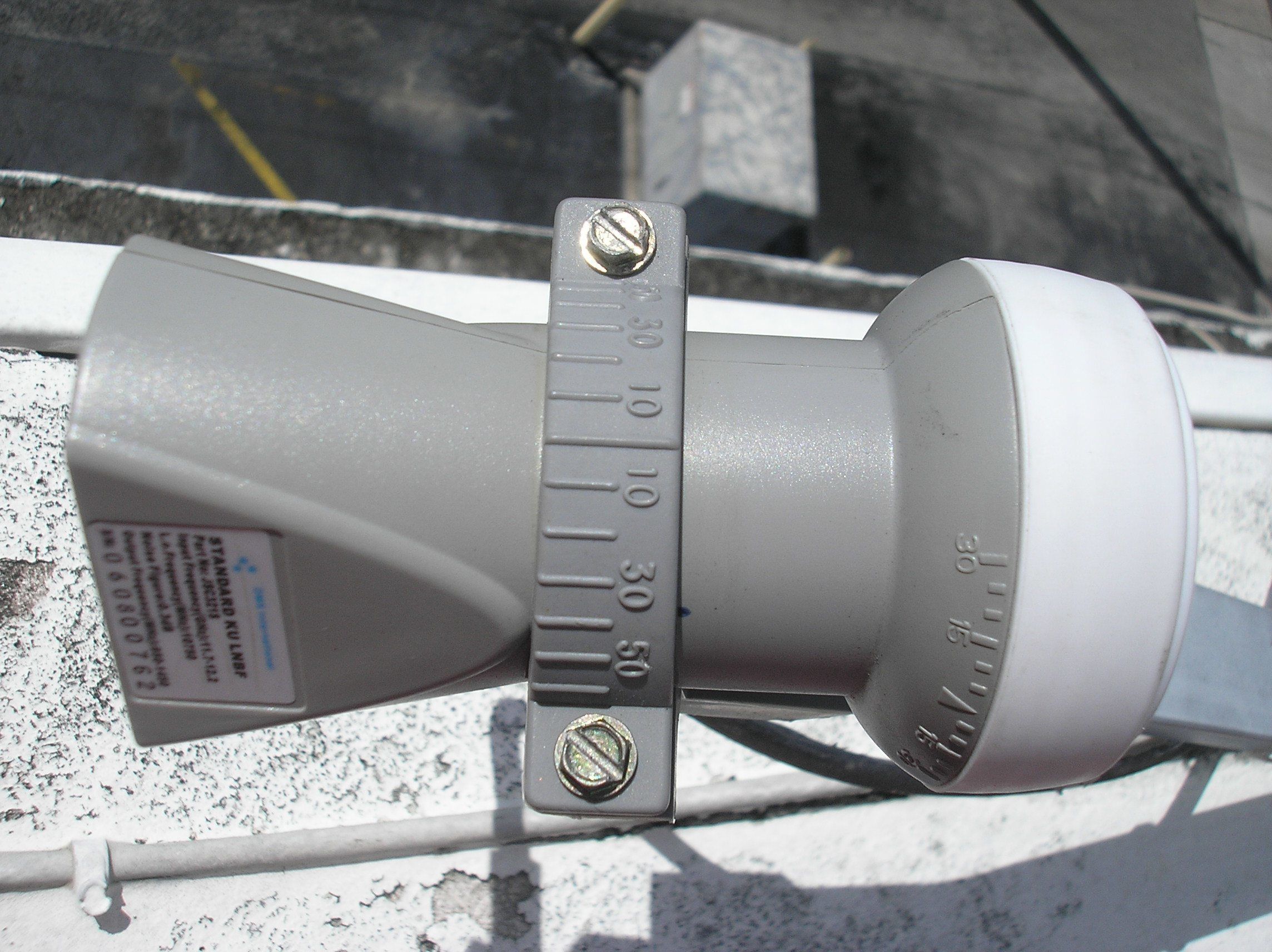

looks like your elevation and compass spot is right. Did you skew the LNB? That needs to be done. From Miami its a -58 skew. If you are in front of the dish facing it skew the LNB clockwise

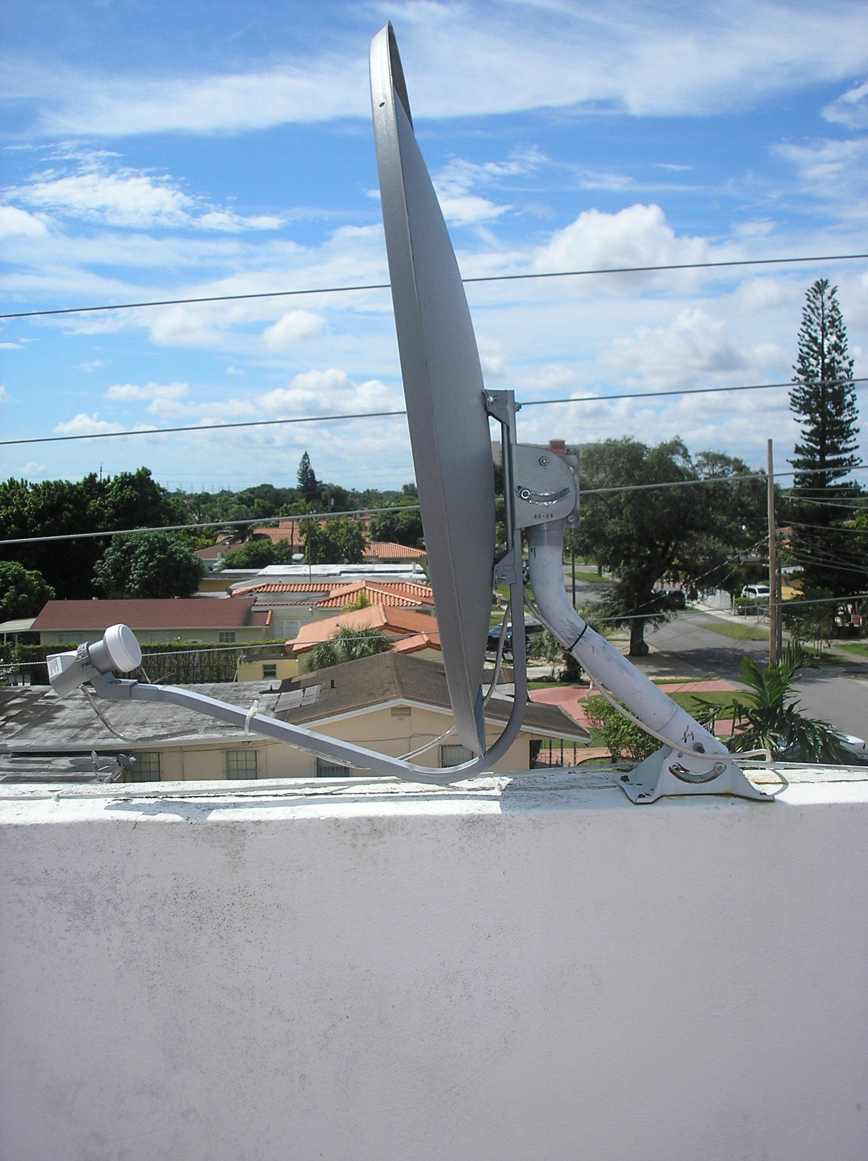

Do not place an inclinometer in the LNBF mount to set the elevation. No part of an offset dish is directly aimed at the satellite. The signal reflects off the reflector from an angle that is typically 23 - 26 degrees higher than the face of the dish appears to be aimed.

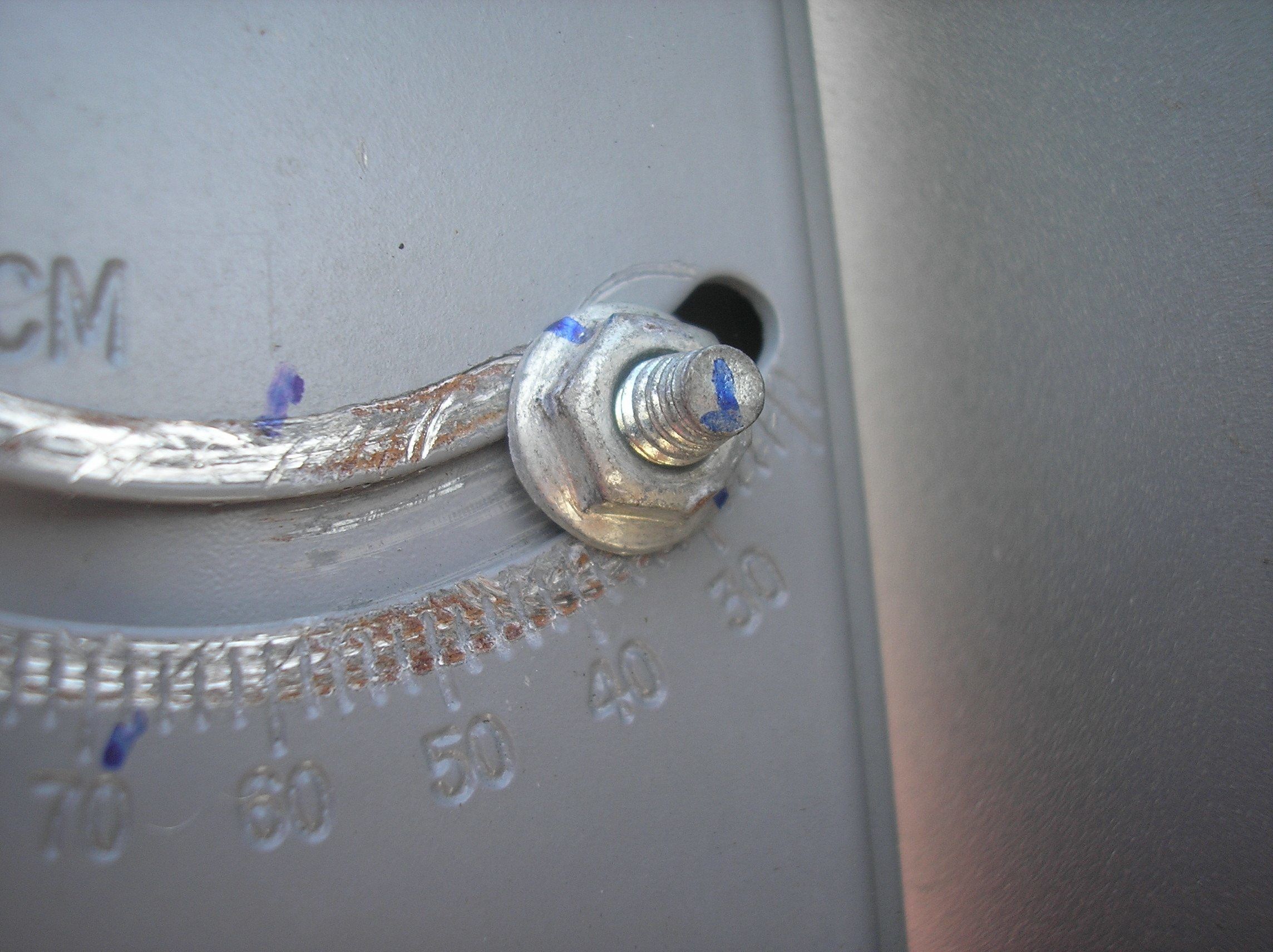

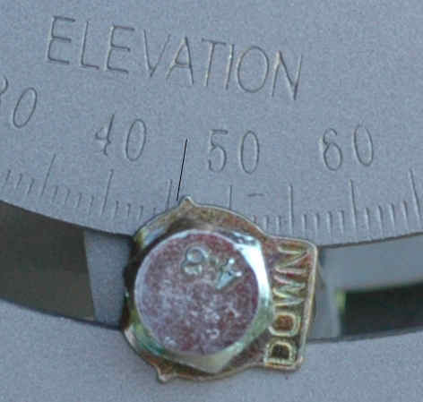

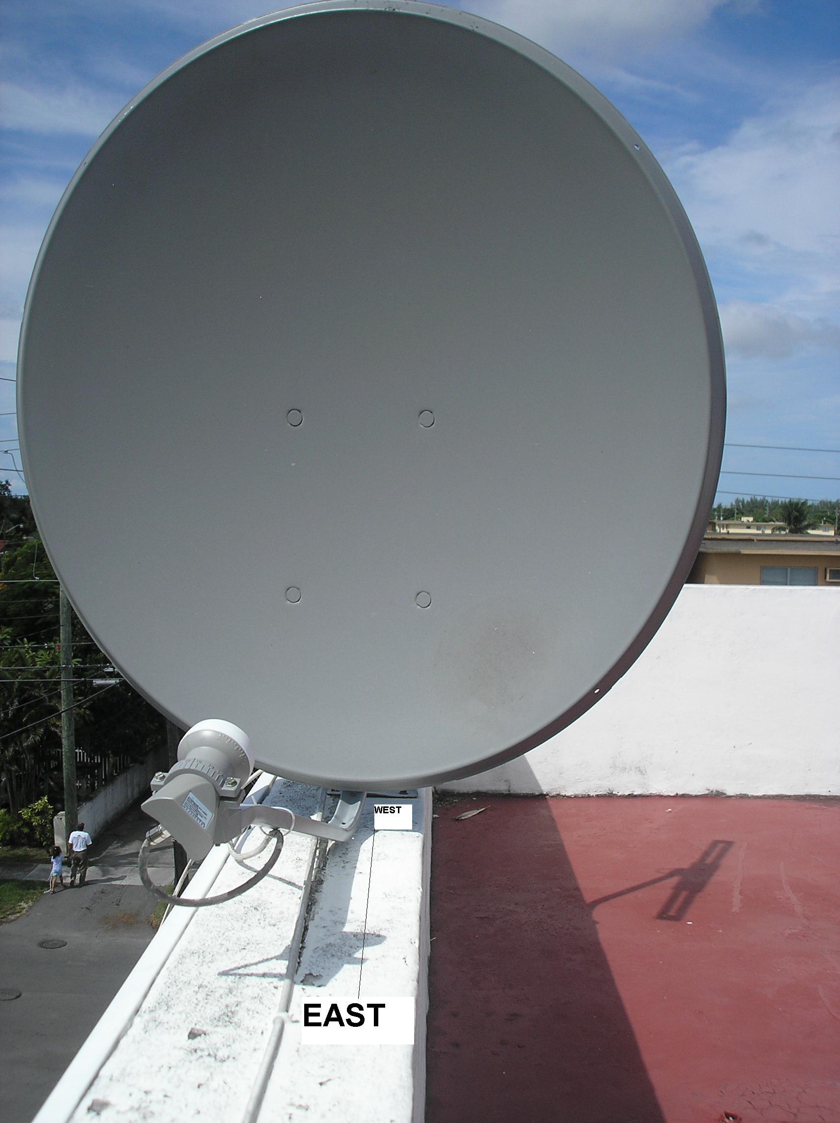

Does your dish have an elevation scale on the rear bracket? If so, use that scale to set the approximate elevation angle. The face of the dish will appear to be almost vertical. Could you attach a few photos of the dish, elevation scale and LNBF? It might help us verify the assembly and aiming.

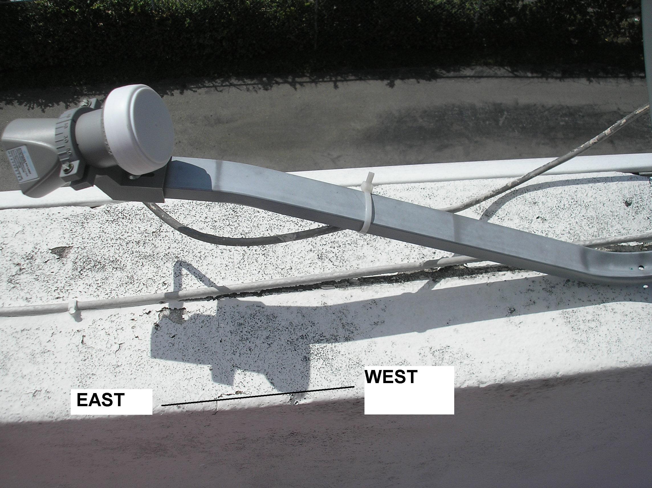

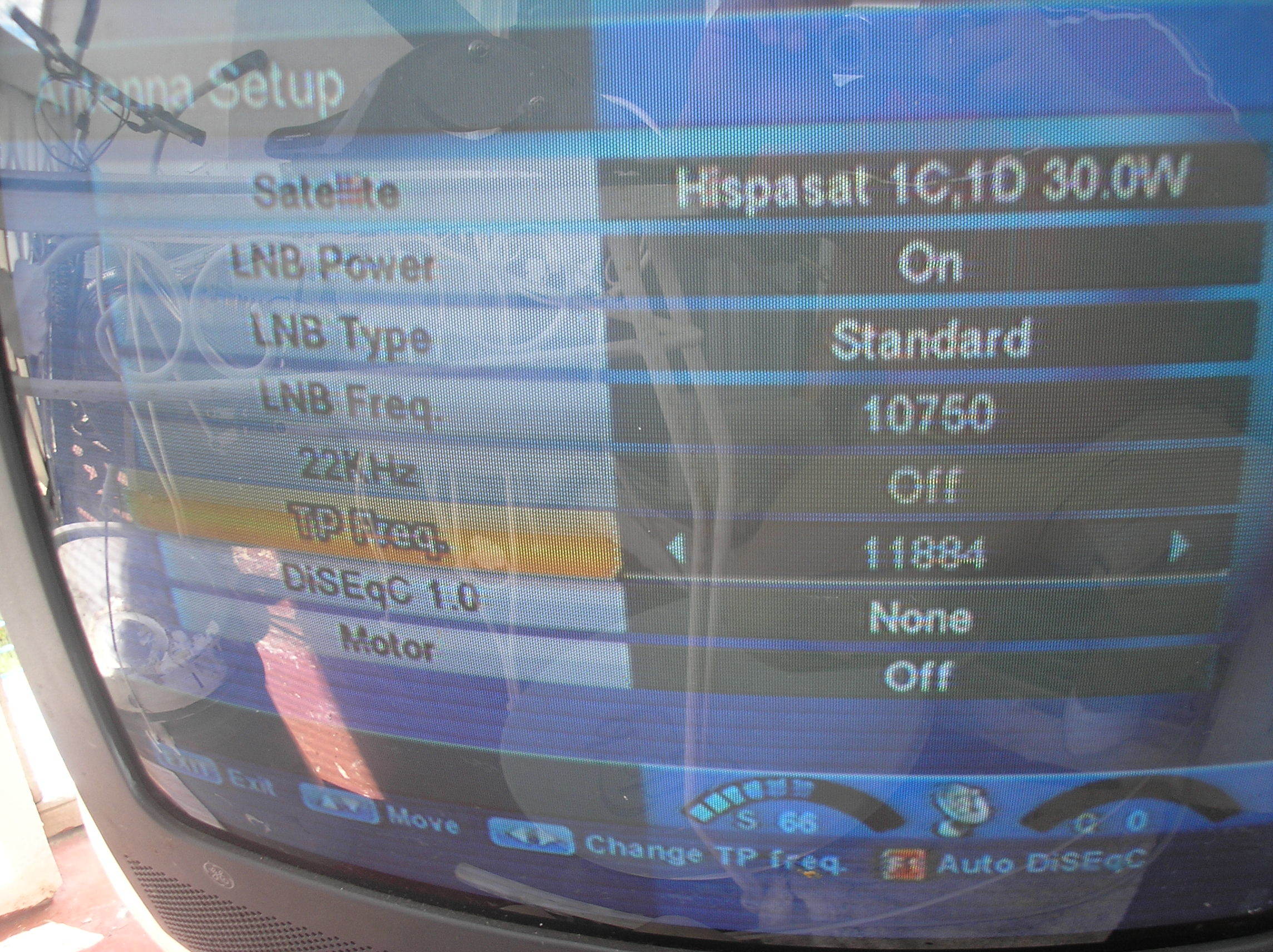

SatelliteAV: Thank you also for get me clear about this inclinometer stuff. So basically this tool is not worth to try to use it. I am attaching some pcitures as you requested.

Here a the pictures of my setup.

You look pretty close with that setup, have you tried varying the elevation on your dish by very much? I'd say go up and down by as much as 10degrees, slowly pan the dish side to side while your receiver is set to an active transponder on your target. The viewsat quality meter should jump a bit when you get close, takes patience and time. Unless there's some obstruction between your dish and the satellite, you should get it eventually.
Thanks for posting the photos.
  1. The receiver settings are correct as long as the polarity and symbol rate are set in the second window.
  2. The LNBF setting is correct. When aiming east, the LNBF is twisted Clockwise. When aiming west the LNBF Skew is twisted Counter-Clockwise.
  3. The dish setting appears to be possibly slightly low. What is the brand of the dish? Do the specification of the dish indicate the offset angle? If so, then the face of the dish can be used to measure the exact elevation angle using the inclinometer. Does the dish assembly instructions indicate what part of the bracket is used for the elevation pointer? Some dish designs use the center of the bolt as the pointer and others use a metal pointer which is visible through the elevation scale.

It will be better to use the Manual Scan screen to make sure what SatelliteAV said, that Vertical polarity , SR 27500 and FEC 3/4 are properly selected. Most factory firmware usually have that TP info ok but who knows (on viewsat's it usually has it doble at 11891 and therefore scan those channels twice when doing Auto Scan).
I second Iceberg on moving the LNB all the way back on the holder to grab it by the neck right almost at the head.
Make sure there are no obstructions for that bird and try a range of +/- 5 degrees around the elevation angle because most dish (and also because the pole not being plumb) could be up to 4 degrees off on their Elev Scale.

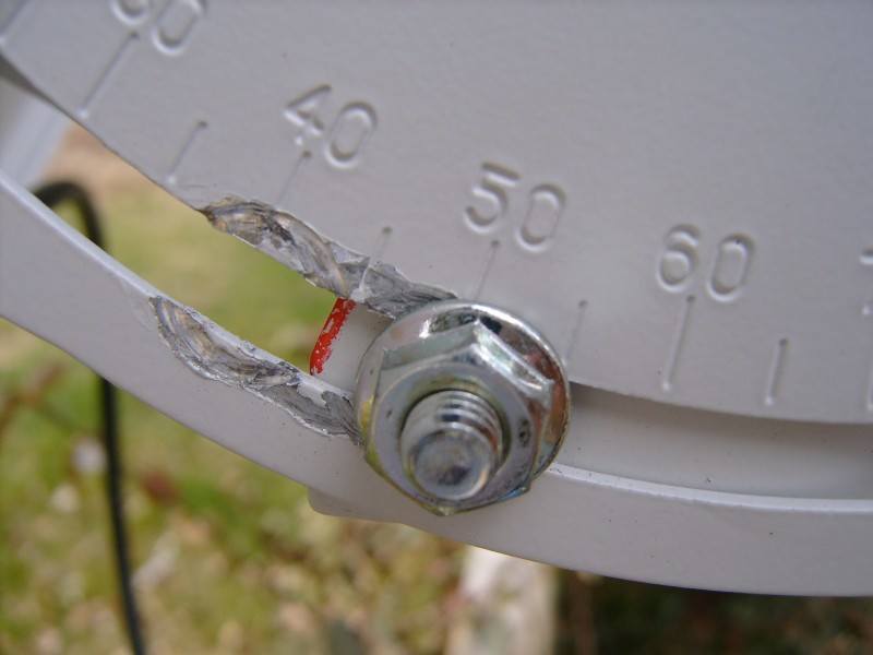

. . . Does the dish assembly instructions indicate what part of the bracket is used for the elevation pointer?
( the red line in the picture below)
. . . and some have a funny washer-like thing with points on it.

Hispasat from my location (Miami, Fl) look a little more that 27.5 elevation I would say almost 30. The same happens with the azimuth it looks like 120. What I did was to move the azimuth until I got the best Strength level that I could (83% while at the same time I had 0% in Quality). Then I move my elevation at very small step until I finally got some Signal Quality. I did continue ajusting my elevation until I got the best I could 73%.
