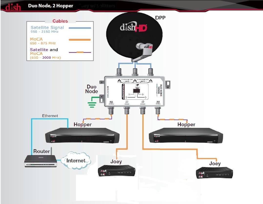

I expect that the installer will put in a 1000.2 dish if you don't already have one. He will then connect what is called a "duo node." Then there are various ways of wiring, but the simplest to describe is one coax to each TV location from the node. All coax today for Hopper use is supposed to be 3 GHz rated. Some drops can be less, but that is discouraged. So if your coax is really old, he may have to run new. He will most likely connect a Hopper to the Internet using an Ethernet cable and "bridge" the other Hopper to it, so all locations have Internet access. This is useful for diagnostics, seeing your bill, downloading certain titles, etc. He may also connect a phone line, so that you can have Caller ID (if provided with your land line service) on screen.
An example of one way it might be installed is below.
