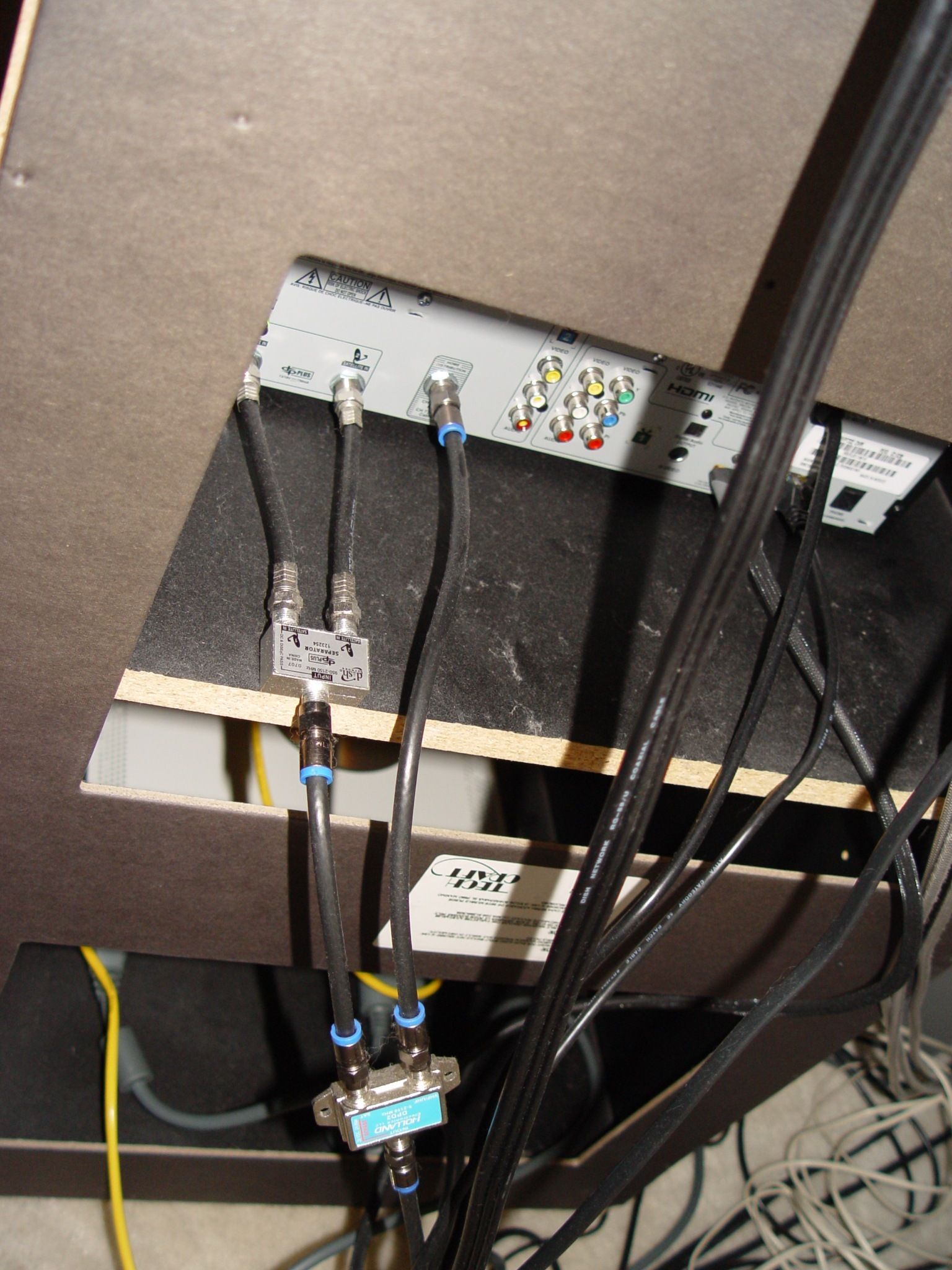

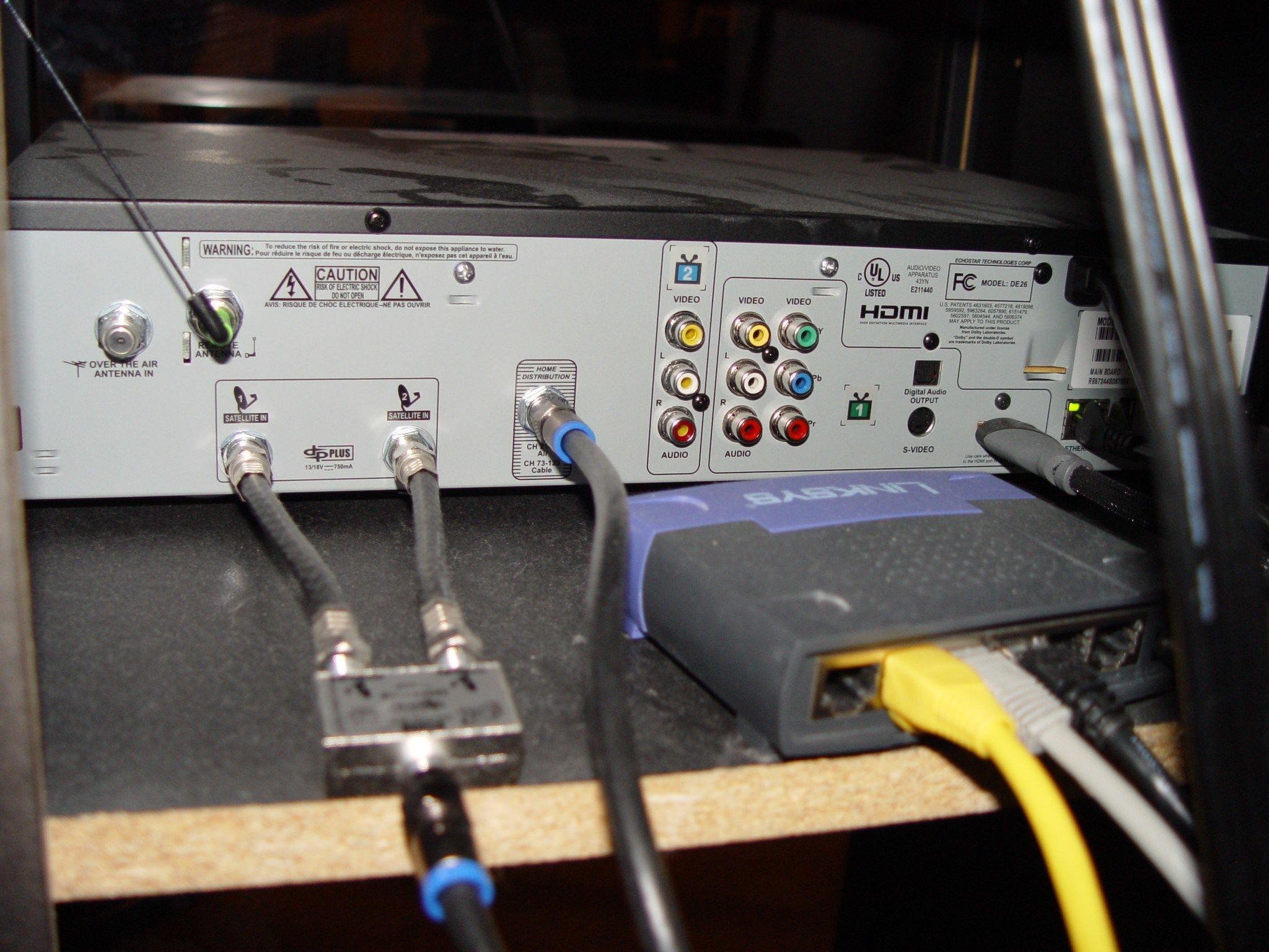

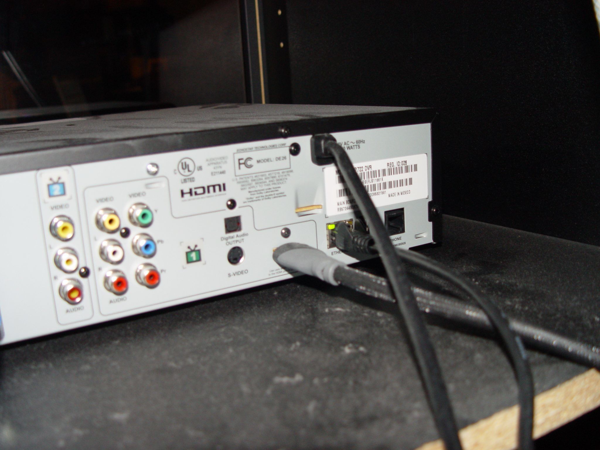

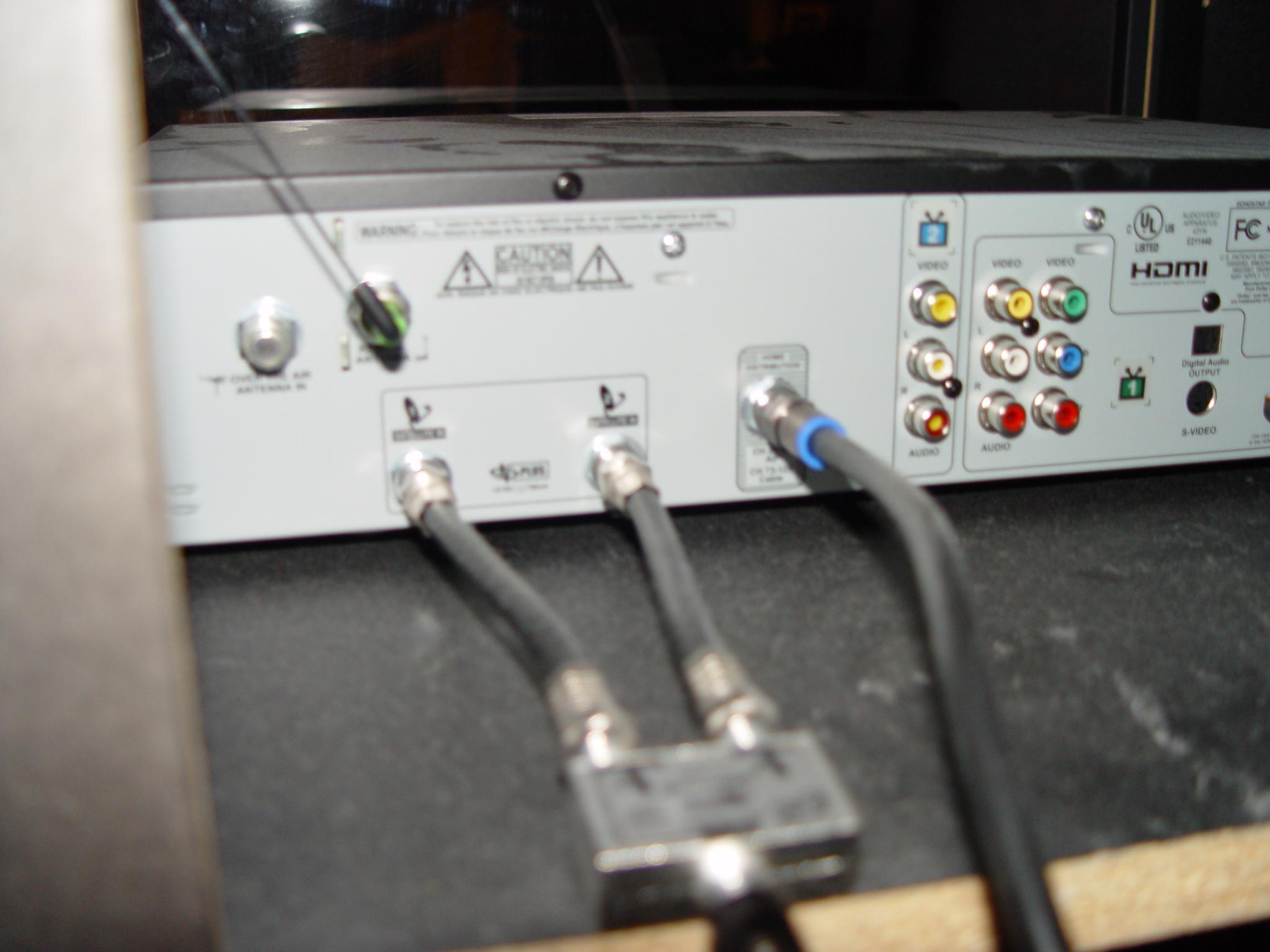

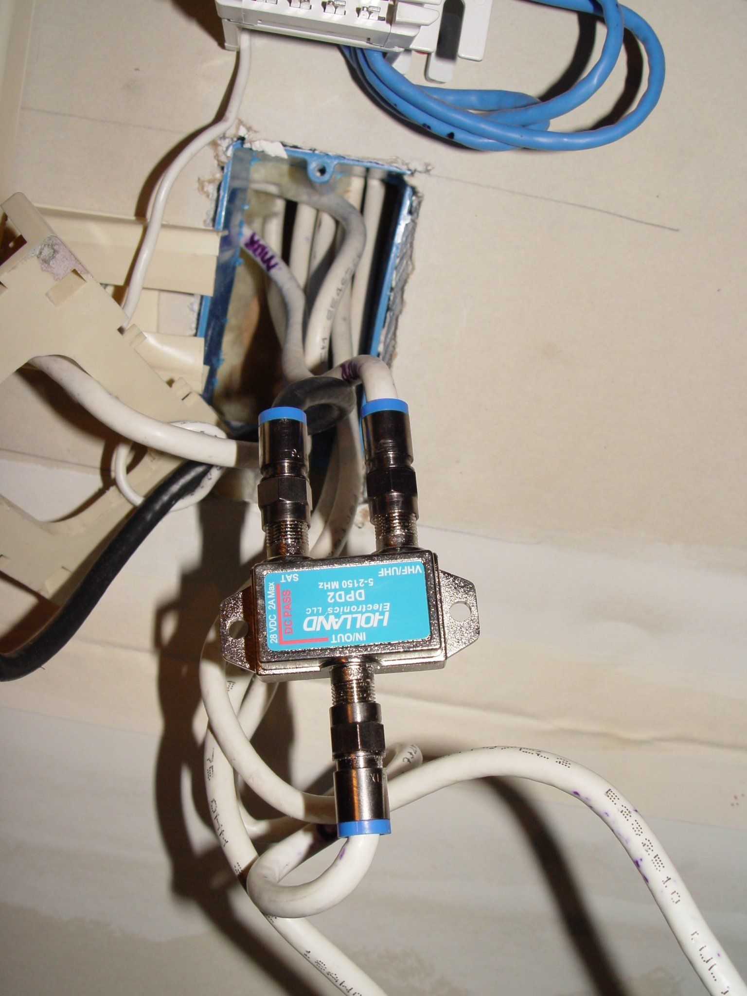

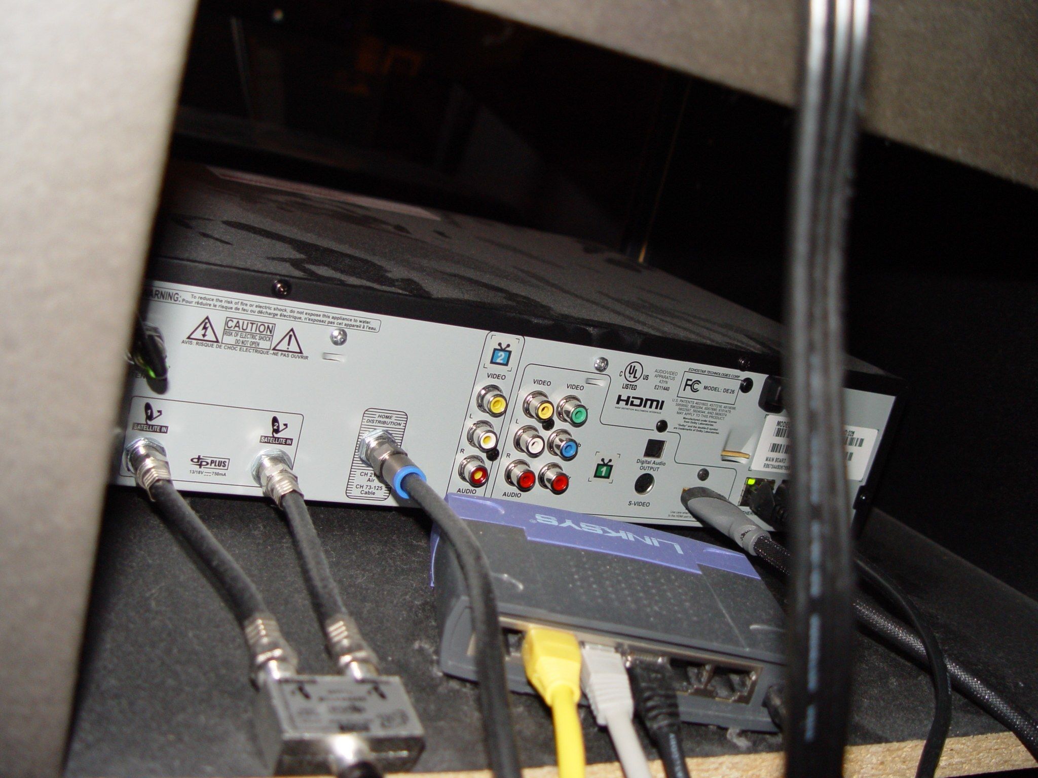

I have a Dish Network VIP722 – I need help sharing the signal from TV1/TV2 to an additional third tv. I don't know what all I would need to purchase or really how to go about doing this, so if someone could give me some info that would be great if this is even possible. Also, I do not have the option of running wires, I live in a condo and all wires for the satellite were pre-installed in the walls of my home. Would this be possible to do without running any more wires? I have enclosed pictures of the back of my receiver of what all is there currently, and also what is downstairs in my garage where all of the COAX from all TVS meet. Any help would be appreciated.

Yeah it can be done.
Easiest is to share TV2 to your third TV. You see that blue holland diplexer (the thing that looks like a splitter) in your picture?
In your garage where all the coax meets there should be another one. Get yourself a two way splitter and about a foot long coax jumper and take the VHF/UHF side of the diplexer and connect that to your foot long jumper, hook the other end to the IN side of the splitter, then connect the wire previously in the VHF/UHF side and connect that to a OUT leg of the splitter. Now have fun finding what other wire runs to your third location and connect that to the other OUT leg of the splitter.
If you want to share the TV1 side of your 722 you'll have to get yourself a couple of two way splitters, RF modulator and possibly a amplifier, it can be done.

Actually getting Tuner1 on the 722 is really easy. There is a setting in the setup menus for the modulator (I believe you push menu, then 6-for System Setup, then 1-for Installation, then 5-for Modulator Setup) and it will allow you to output Tuner 1 and Tuner 2 via the Coax output (default for the 722 is for the modulator to be off). This will allow you to have both tuners on the Tvs feed from the coax.

From the posts here I see everyone is very helpful. I am going to give a step by step guide.
Cabling
1. The final picture to post is of a diplexer (I am speaking of the diplexer that is not in the same room as the receiver) goto this diplexer
2. Locate the connection labeled VHF/UHF and disconect it (the cable that was just disconected was the TV2 cable)
3. Connect a short cable to the VHF/UHF connection
4. Connect Splitter to the other end of the short cable
5. Connect TV2 cable to the Splitter (now TV2 is back up and running)
6. Connect TV3 cable to the Splitter
7 Cabling is complete
