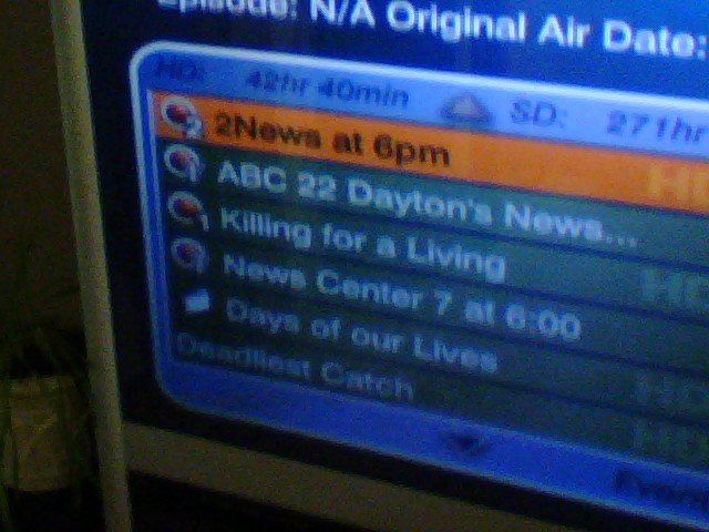

How's this ? I won't be able to take a picture while they're in progress though .... got some yard work to get started on.
You can see (2) recordings with the antenna icon, i.e. OTA, (1) on TV1 and (1) on TV2.

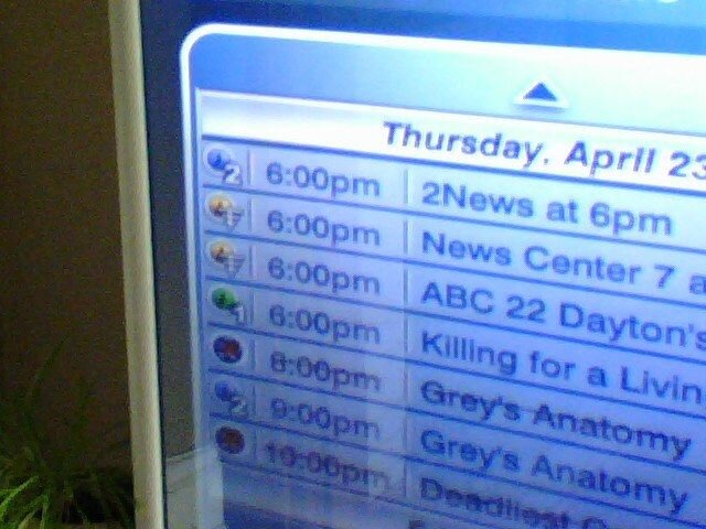

Was able to get a picture of all (4) recording at once after all...
