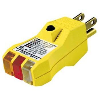

Get yourself 1 of these. That would be a good start. Check every receptacle in the house. If you find issues you at least know what you're dealing with.
